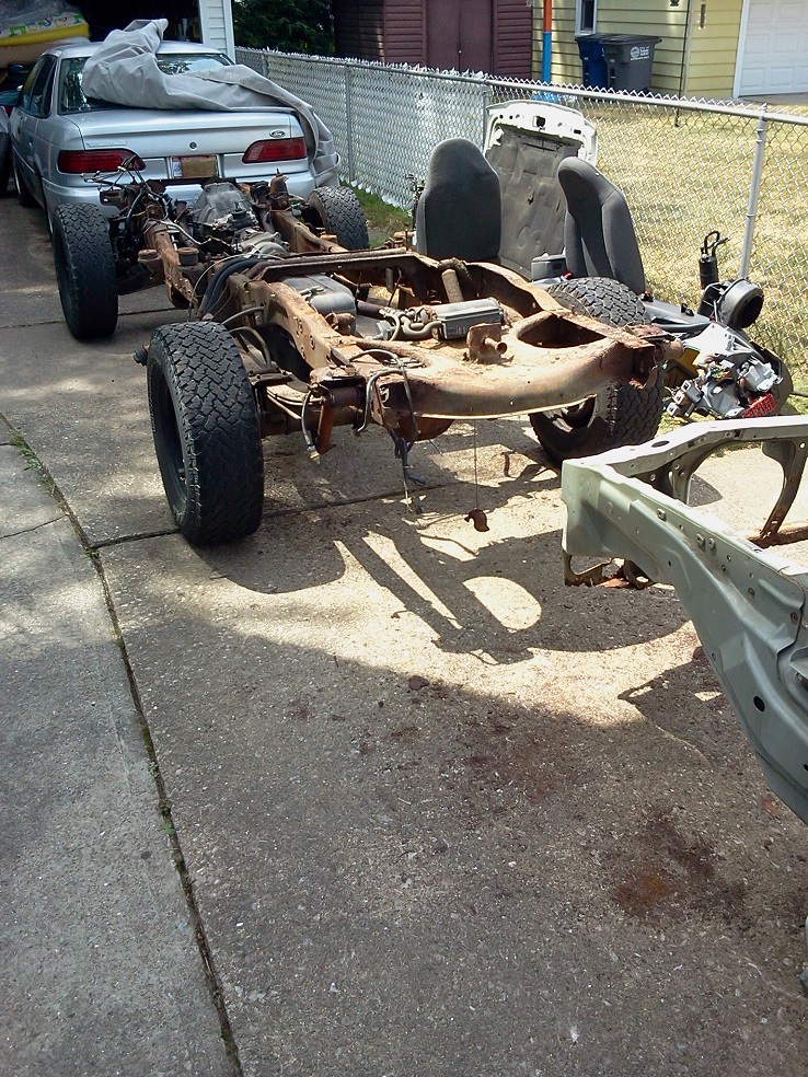

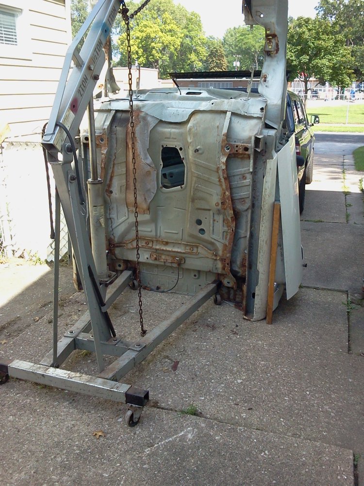

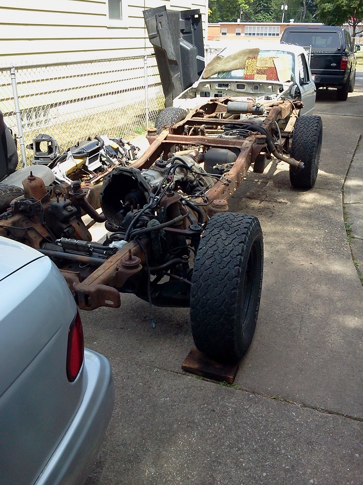

I'm not quite up the4 level of some guys here, but this is an example of what can be done in a driveway by 1 guy.

granted I didn't need to be careful with the old cab, but as the commercial says,,,,, imagine the possibilities
