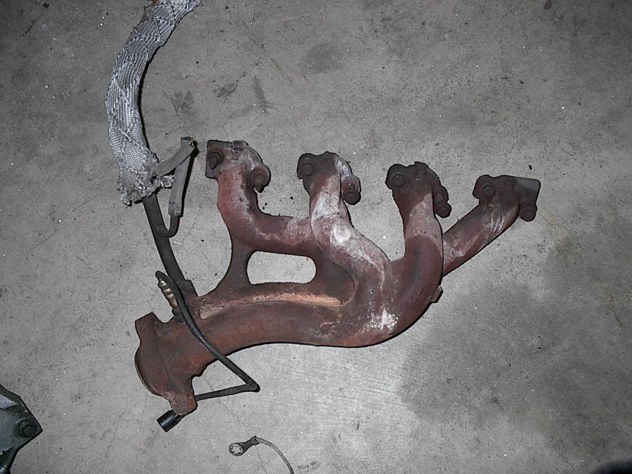

The ranger tube header is junk, if that what you out on, you're imagining the hp gain. It has been dyno proven on several different 2.3 configurations to hurt performance at all points vs a stock even flow cast iron manifold.
The 96 already has the tube header so it's not something he would have to change...I changed mine to the tube header from the stock and noticed a slight gain in my performance...probably from reduced weight...but more likely from the P&P I did myself and the new cam...with slightly longer duration of valve opening...I think I ended up junking the cam eventually when the head cracked and I had to rebuild it yet again.
Yea the cam is the likely helper. As for weight, there's only a 10-15 pound difference. Its not even enough to notice. The design is all wrong. If you want weight savings an performance, buy a 2.5 cast manifold. They are the same as the old ones, with much less excess casting material.
And toss the jump seats...about 100 lbs...unless you actually use them for something like bondage or torturing tall people...
Best exhaust manifold
This is a 2.5L ex. manifold note that 1 and 4 and 2 and 3 are tied together for scavenging, with a port match and a little grinding at the pipe flange you will get more than most headers on the market, and the power increase will be more wide spread
