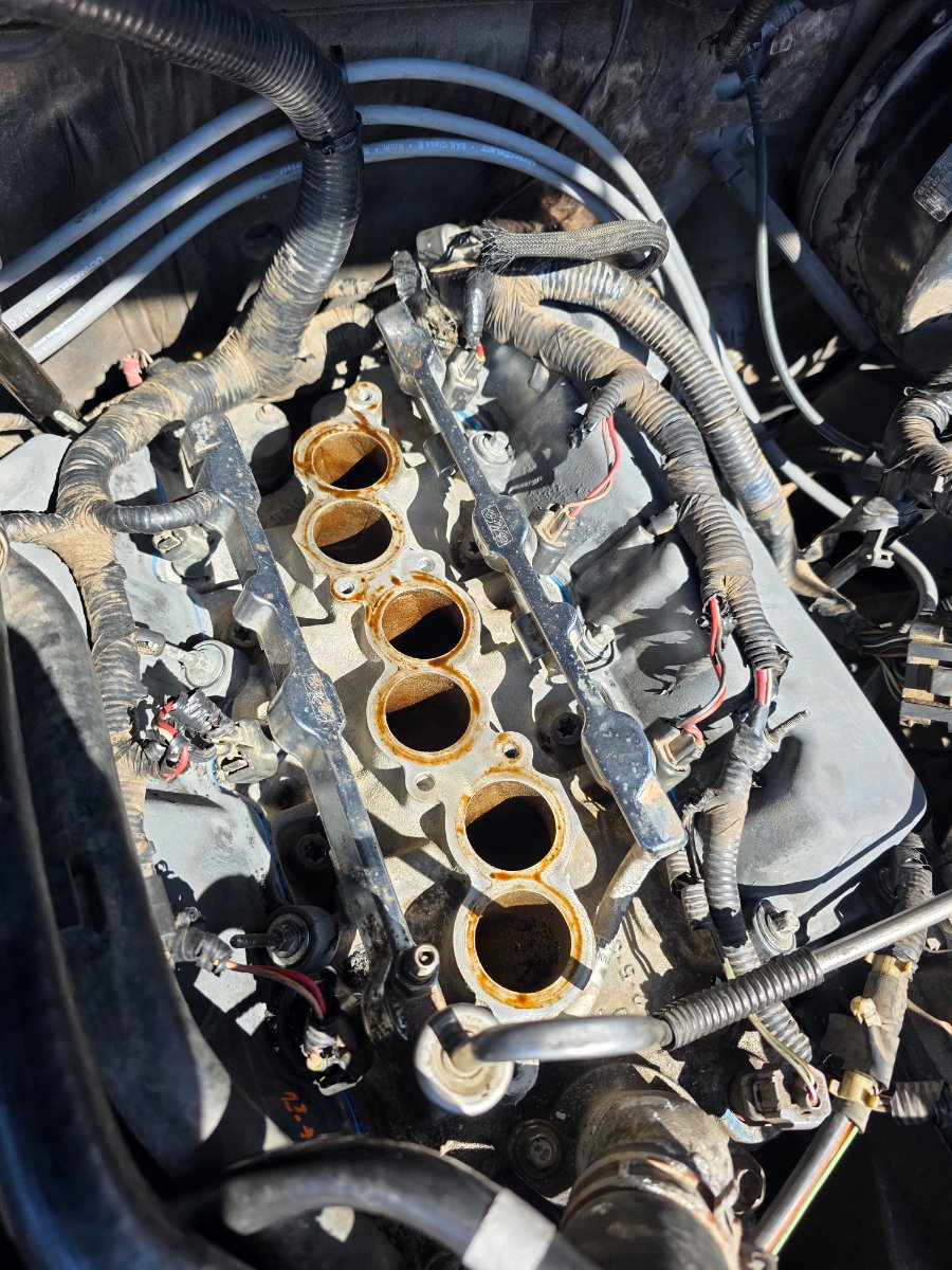

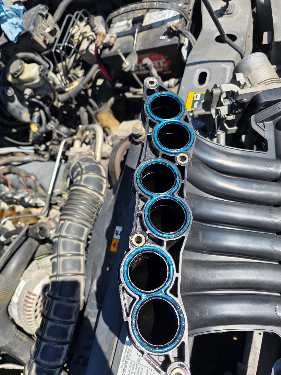

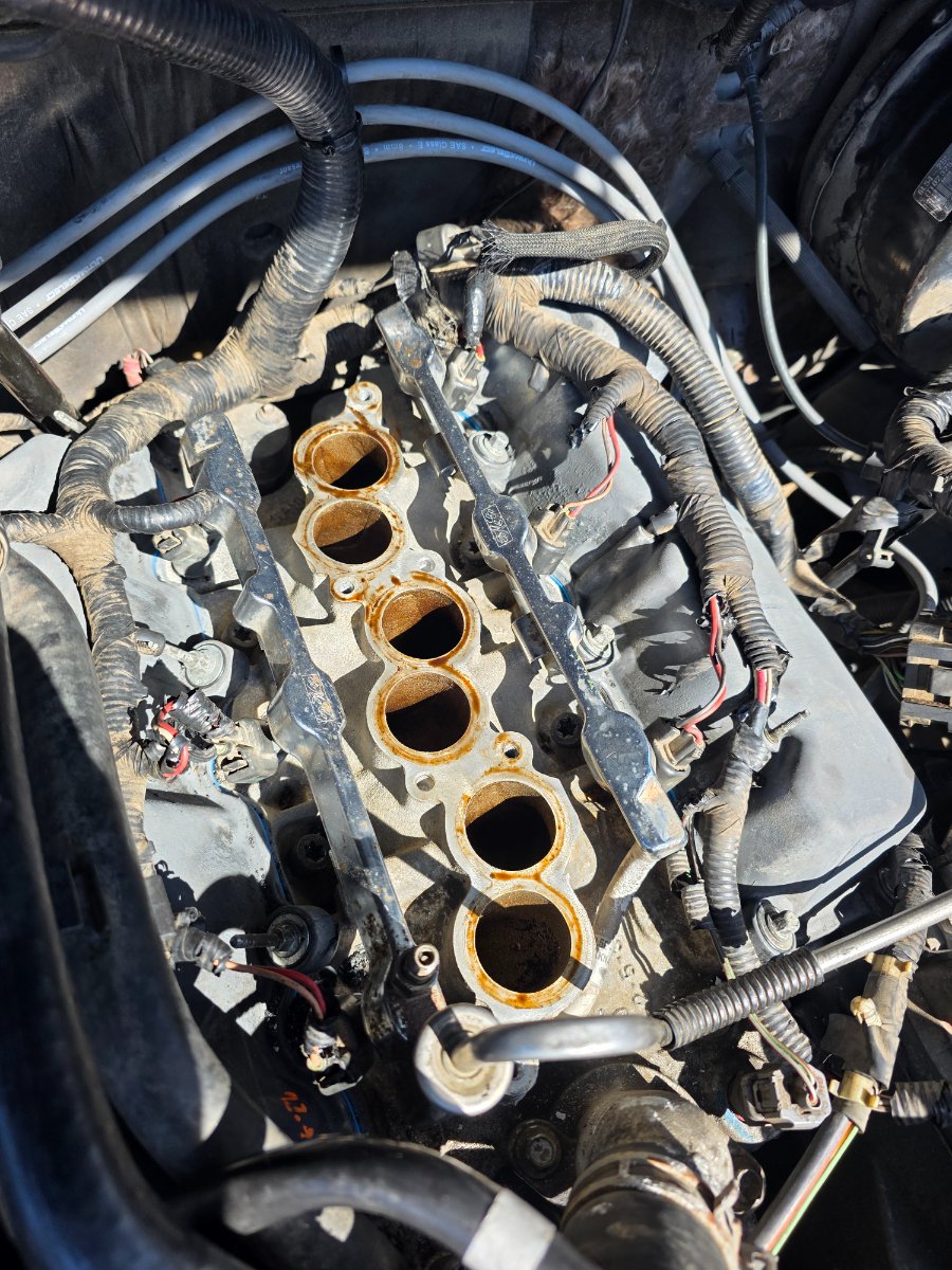

So I pulled the valve cover off bank 2. Mainly because I'm starting to doubt my mechanical abilities🤣 But in all seriousness i wanted to verify i didnt drop a push rod. No oil spilled out or was pooled. The valve cover has a splash block inside so I didn't see any spray, but I do think oil is an issue, at least partly. It seems to be in the intake manifold again. I just cleaned it last week when I swapped injectors. But there is residual oil on the mating flange of the lower intake (pictured) and I also noticed it dripping out of the break booster hose just now when it was disconnected.
No sign of coolant in oil either, mentioning this because the smoke is getting more white with the more it runs. Oil was dark brown black. Oil change will be done once its running.

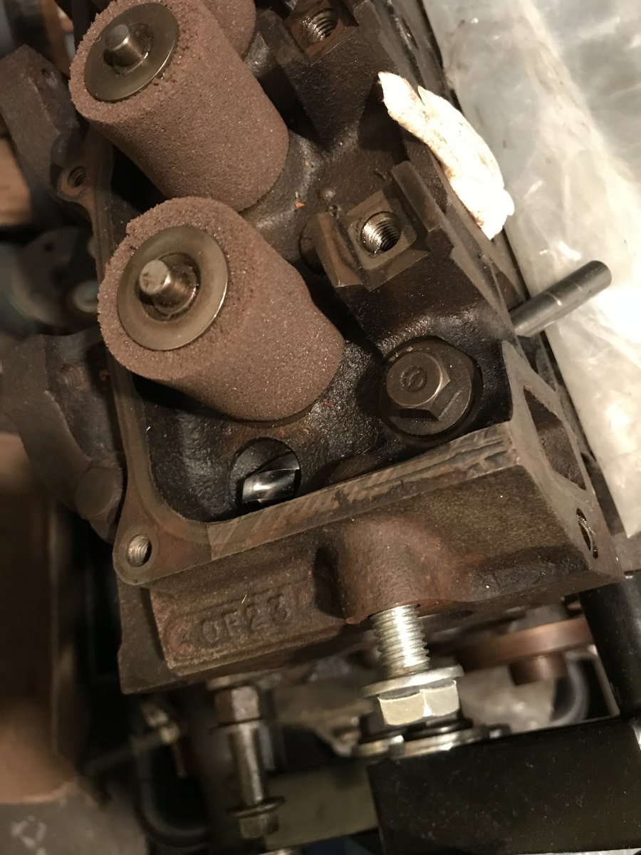

here is a pic of the oil drain at the rear of the drivers side head. that's a 3/8" drill sticking thru it.
you can see if it were not flowing oil would soon be flooding the springs & seals.
kindly ignore the custom low pressure valve springs. ( I have many unfinished projects )
