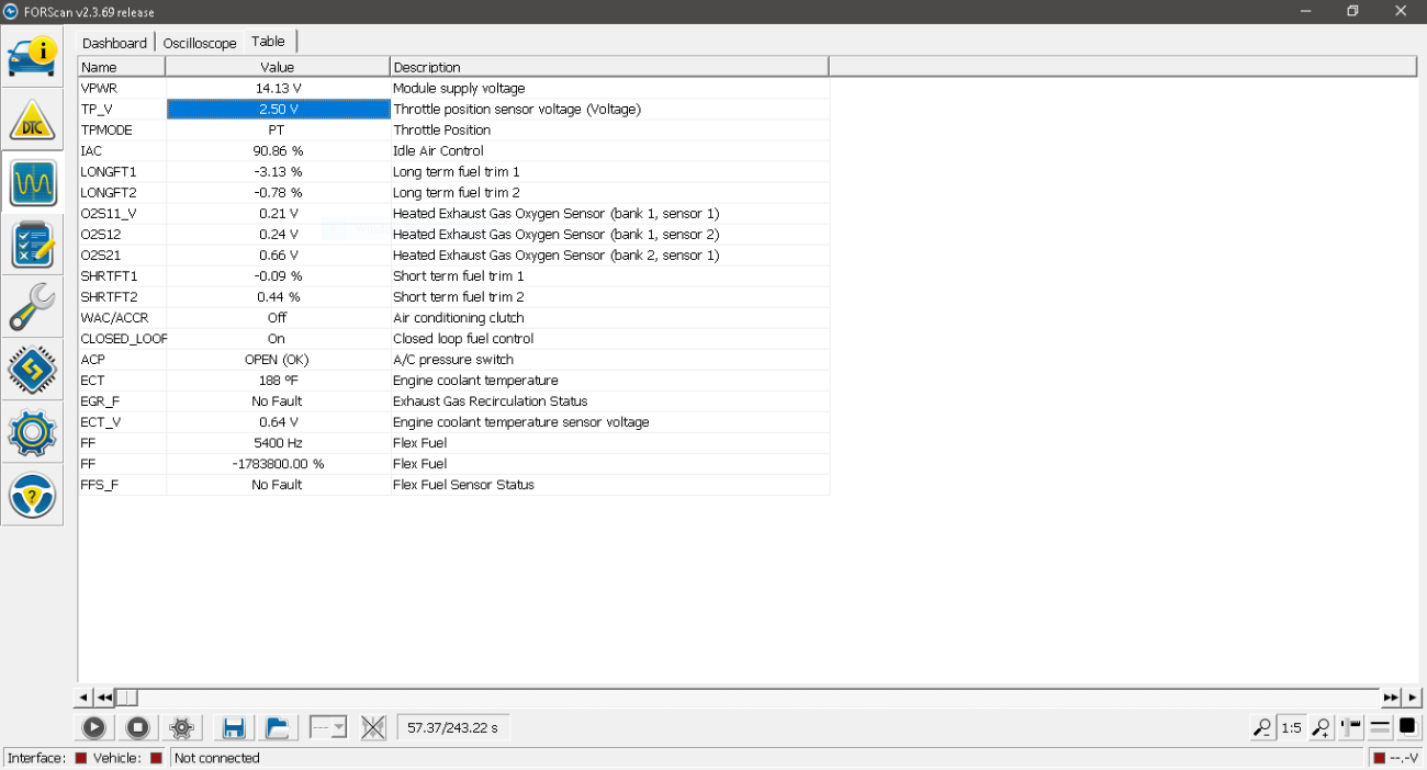

Here's 2 logs I did yesterday. One cruising and one at idle after. Super easy to tell if O2s are working properly

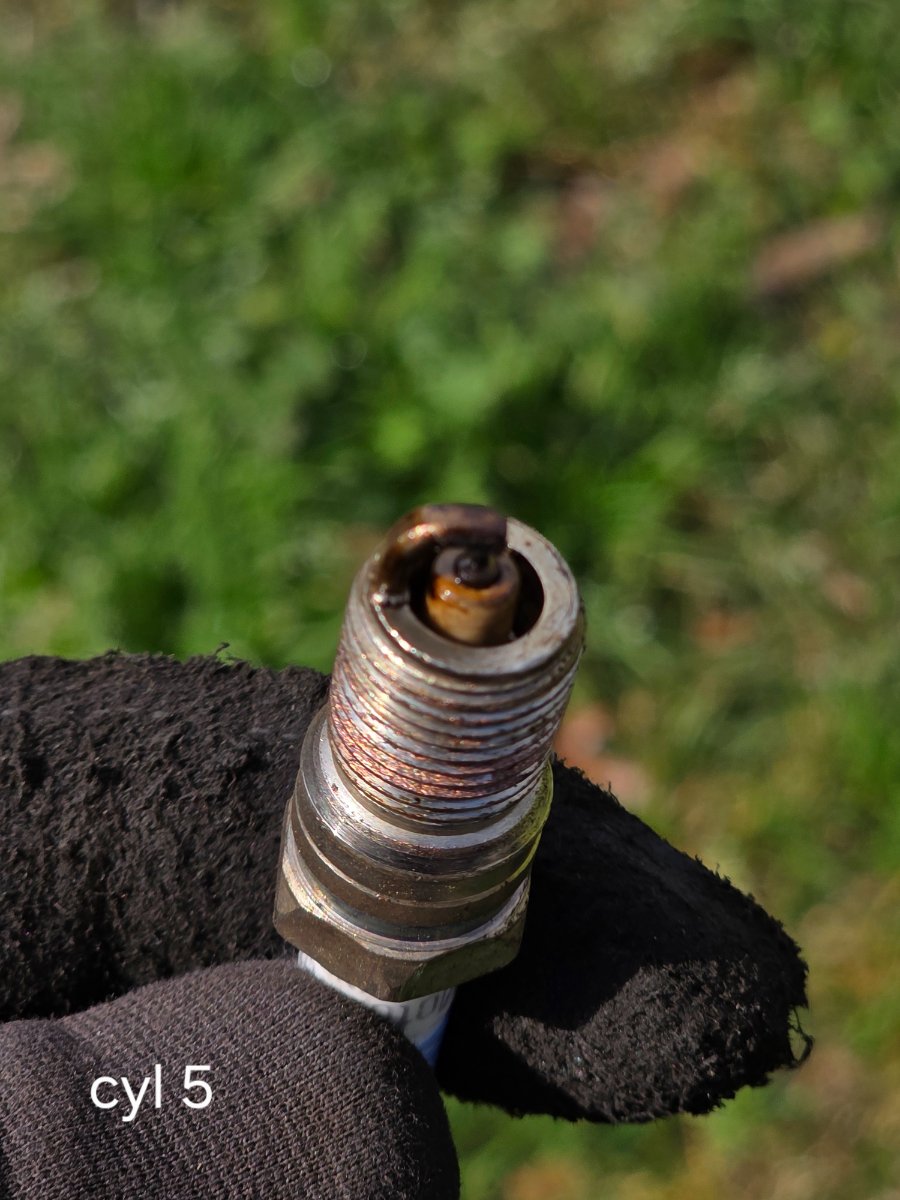

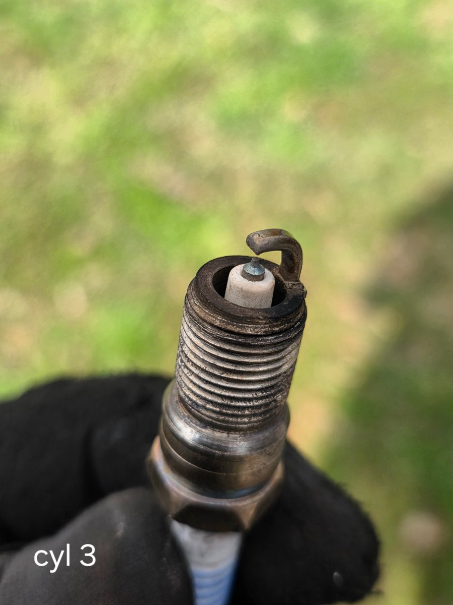

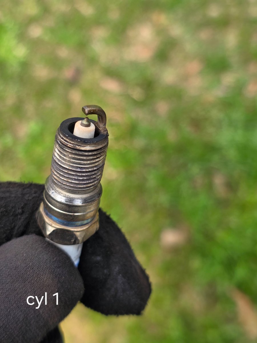

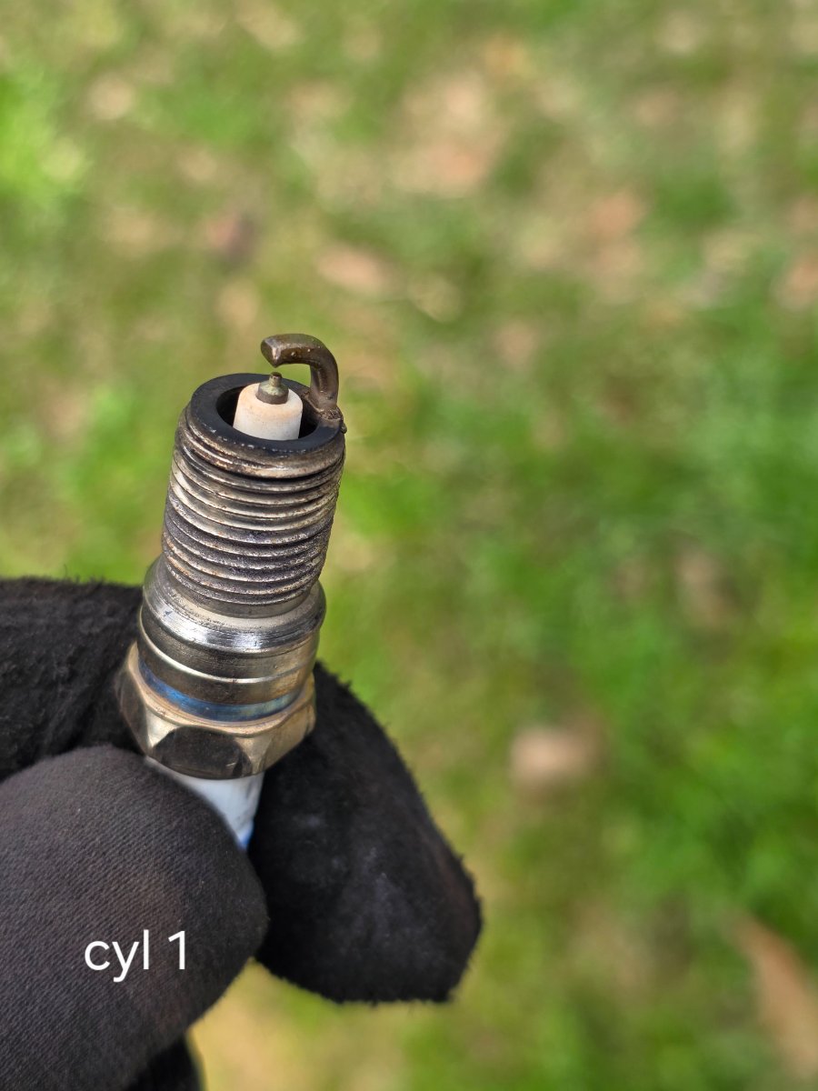

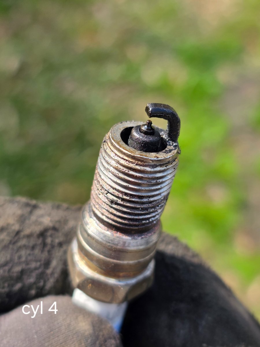

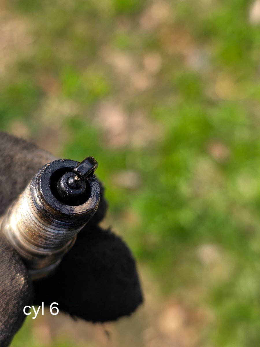

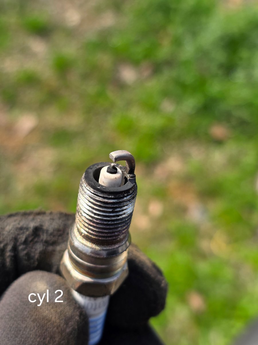

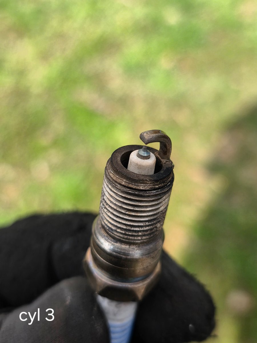

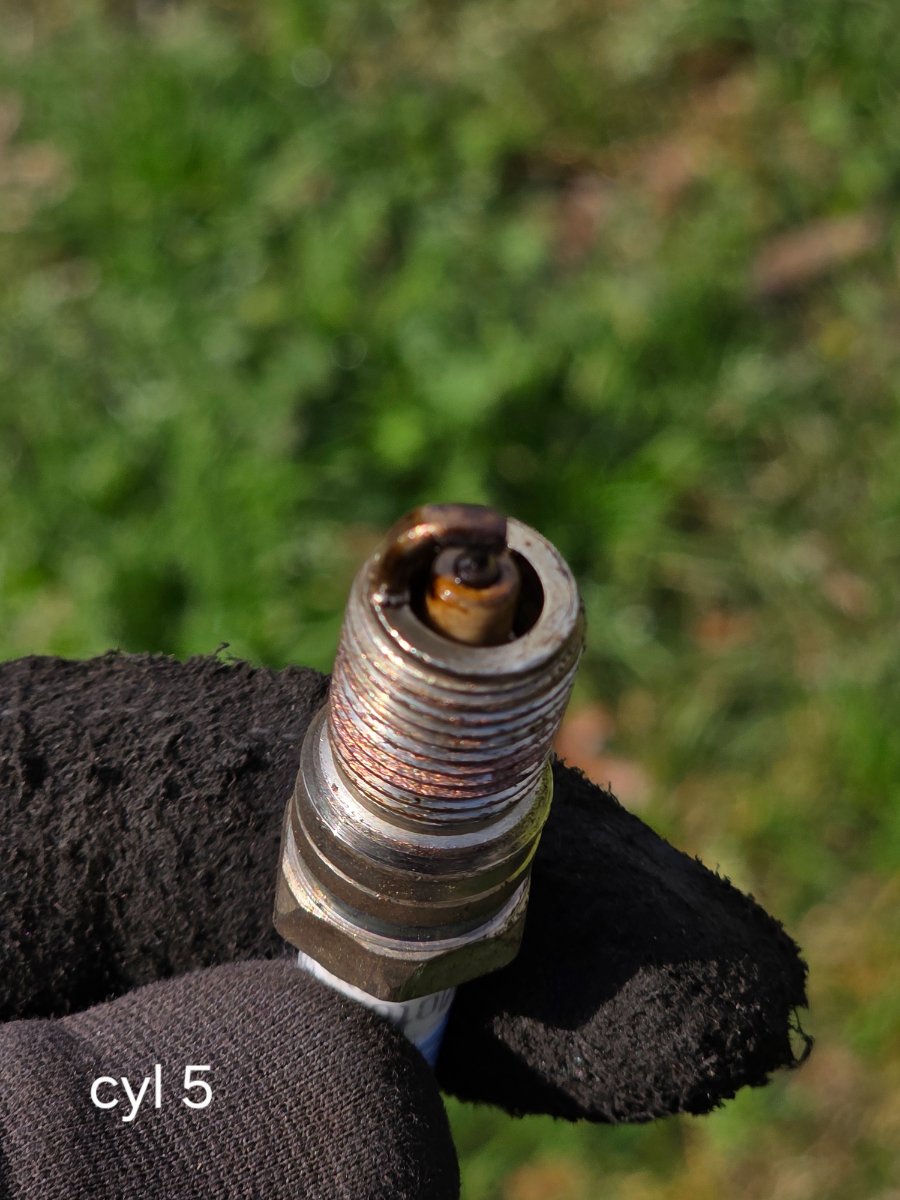

I tried the "Clear flooded engine mode" trick and pulled the plugs after. Plugs on cyl 4 and 6 had residual fuel but by no means soaked.

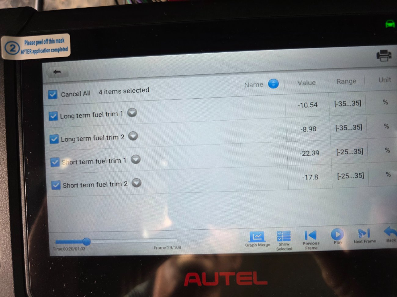

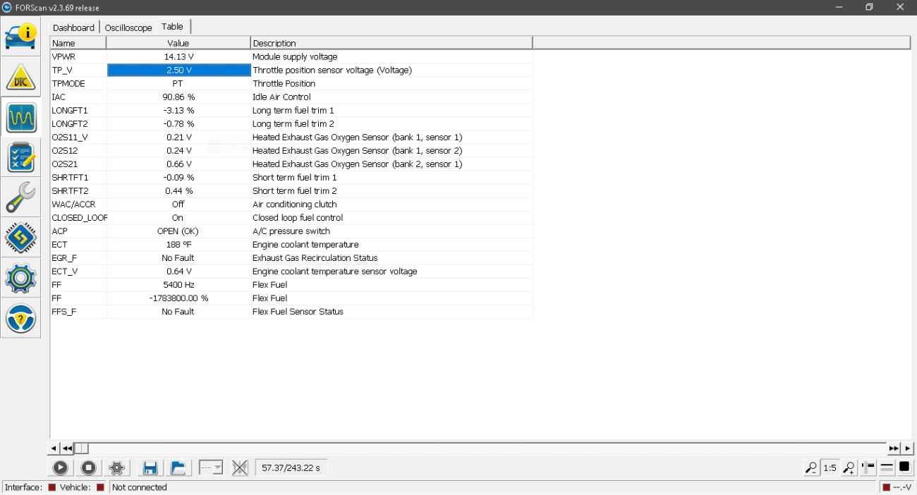

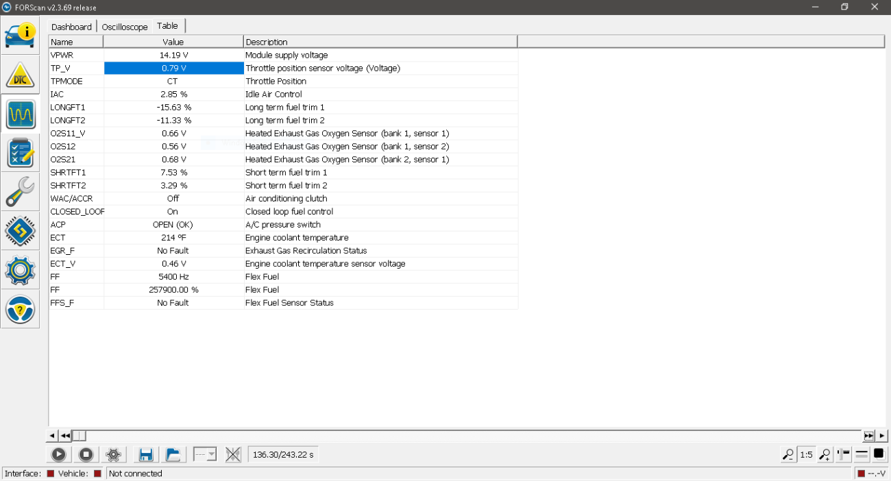

Also, I had just ordered an Autel scanner. And did record fuel trim data at idle. Currently not attempting to drive truck. But this is a screen shot of said data. In all honesty, I don't truly understand the fuel trim data. So feel free to dumb it down for me!

Looks like the short term fuel trim is almost maxed out in the negative. That would imply the egnine is getting fuel from somewhere other than the regular injector function or that air is heavily restricted.
