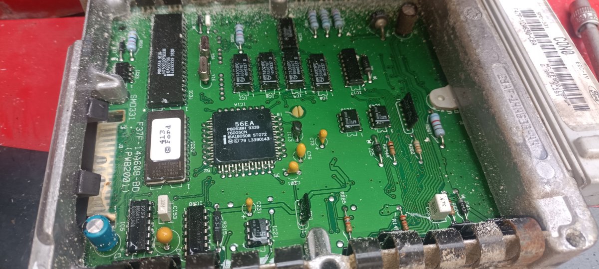

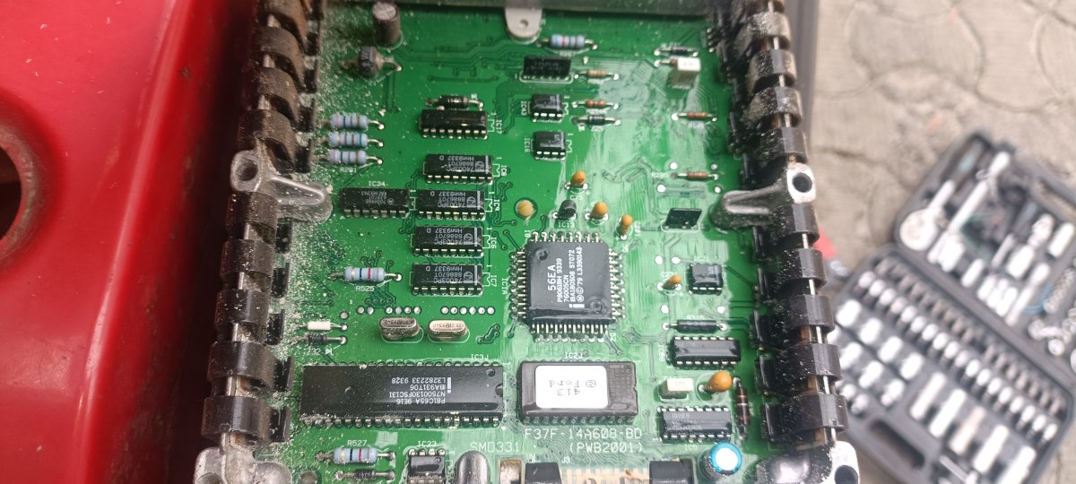

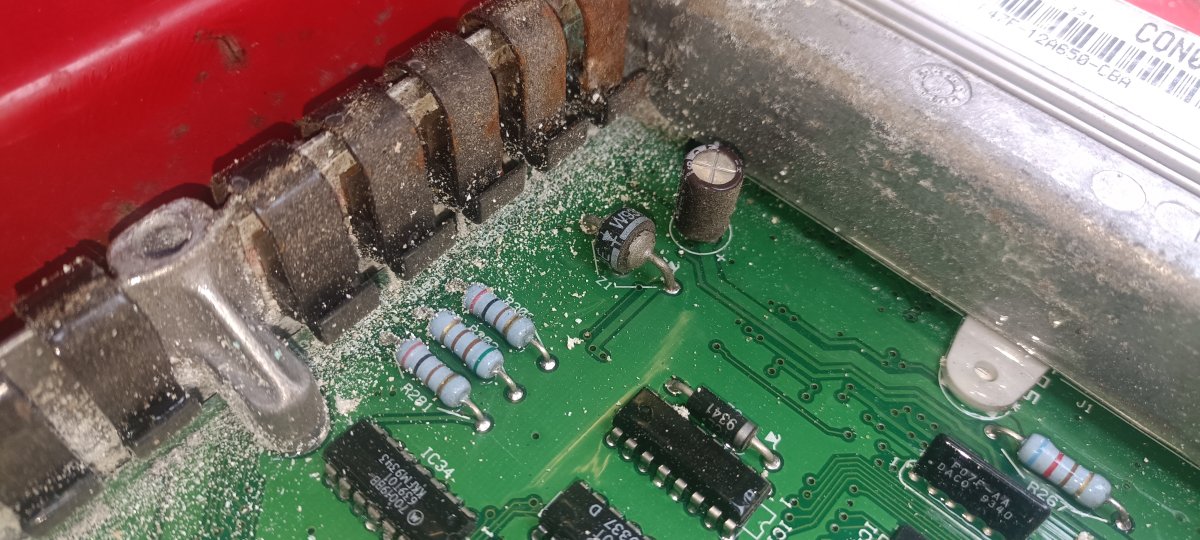

Looked at PCM, clearly did not see damaged or weakened capacitors. However, only 2 of all the cover bolts were unscrewed "alive".)
Looks like 2 of the capacitors have already been changed, 2 black were changed, blue was original most likely
