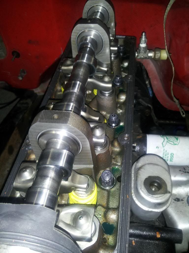

The smoke that I was referring to was not actual smoke from the tailpipe but more like a steam from the valve cover vents and through the PCV...I had it vented to a catch can and run back through the breather (carbed application) as well as through another smaller oil/air filter...
But, anyway...there was/is a blow-by problem with my engine...as well as valve seals...and I'm in the process of swapping heads...did discover quite a bit of carbon on the pistons...so I might try the seafoam once I get it running again...just a bit reluctant to do anything like that...
