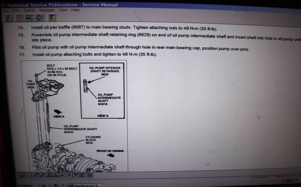

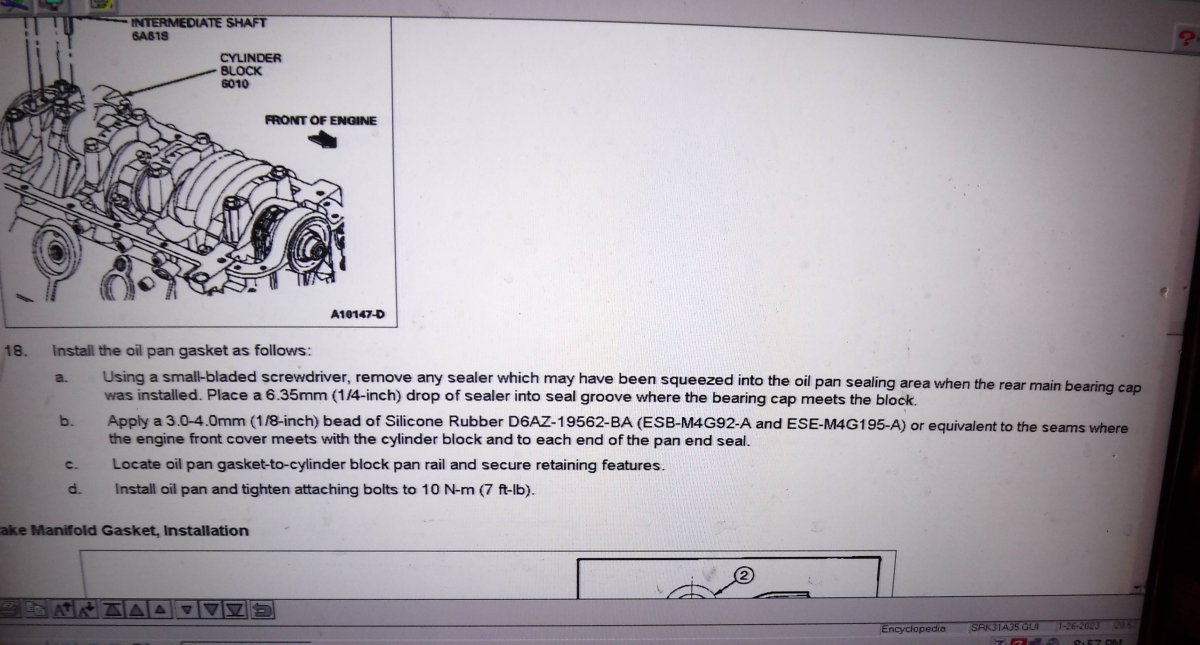

By the way, do you know if there should be a gasket on the engine oil pump?
Or is it installed without it?
No Sir, I really don't know, but somebody here will, would be my guess that it does, but that's still a guess
This is for 93-94 Ranger 3.0 Max
I don't see anything about an oil pump gasket
View attachment 87959View attachment 87960

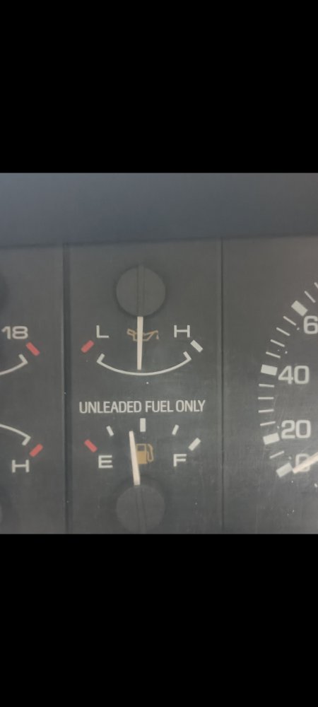

I've already racked my brains.
Previously, when starting the engine, the oil pressure gauge was instantly in the operating position (there is a dot drawn there).
Then at some point I began to notice that when the engine is cold the pointer does not reach this point a few mm, and I began to hear the "ticking" of a single lifter. As the engine warmed up, the arrow would get right and the ticking sound would disappear.
I solved it by replacing all 12 lifters and a new oil pump.
But it didn't get better, it got worse.
At startup I could hear a significant ticking sound from many lifters...
I don't understand where the oil pressure can go ...
