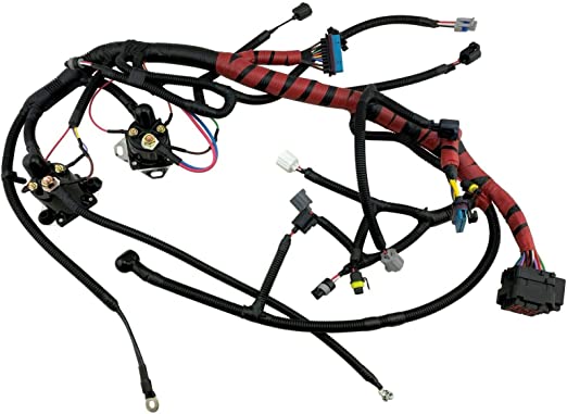

How do you think, if i buy brand new engine harness... Its a big deal?
Something like this ..
