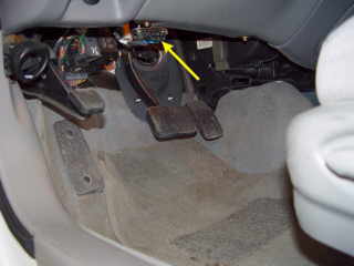

Do you not have an OBD port? It's location will vary by the year of truck but will loook like this and about in this location. The video you show is a much older ranger that yours so I don't know if that will work. Do you have a cheap obd reader or can you borrow one?
No, I don't have a reader.
I'm wondering if I should buy one for this, or if I should try the video method.
