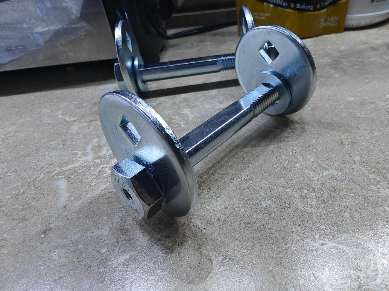

Looking for the eccentric cam adjuster bolt and nut on the passenger side lower control arm at the rear of the lca...the one with the torx head on one side of it, for my 01 RWD coil spring suspension. Ford lists the part as F87Z3B236AA. Having a hard time finding it or maybe I'm calling it the wrong thing. Calling Ford tomorrow to see if they have it.
Doing my research, looks like Moog K86005 will allow for + or - 1.65° adjustment. If I install these on the UCA, can I just replace that LCA eccentric bolt with one like the other 3 bolts on the LCA?
Not that anyone cares 🤣 but 1 out of 5 salvage yards I called will sell me the entire lca with both bolts because they dont just sell bolts. $52, but at least it'll be drivable again.
What did Ford say?
(I can't help with your question, sorry)
Took a chance and ordered: Genuine Ford Adjust Cam F65Z-3B236-CD. Worked like a charm! Hopefully this will help someone in the future. It has a knob like end, not star pattern but worked perfectly.
The reason I ordered it was LKQ located 2 lca with bolts that ended up not actually being available ( they dont sell the bolts separately, have to buy the whole assembly) and although Moog said their K80065 would work on both uca and lca, they are wrong.
Strange. My '08 doesn't have an LCA adjustment option... Just the UCA. I got those Moog parts.

Correct, 08 doesn't, I think they stopped in 2004. Moog customer service told me in a string of emails they would work on both upper and lower. If I used both large plates then there arent enough threads on the bolt. Plus the frame of the truck is indented, making adjustments impossible.
