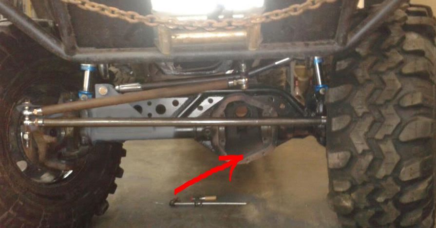

Kinda obvious.....
missing an inspection cover bolt on the front diff! that's a mandatory item
My laptop is jacked up and I can only see half of the pic, didn't catch that
