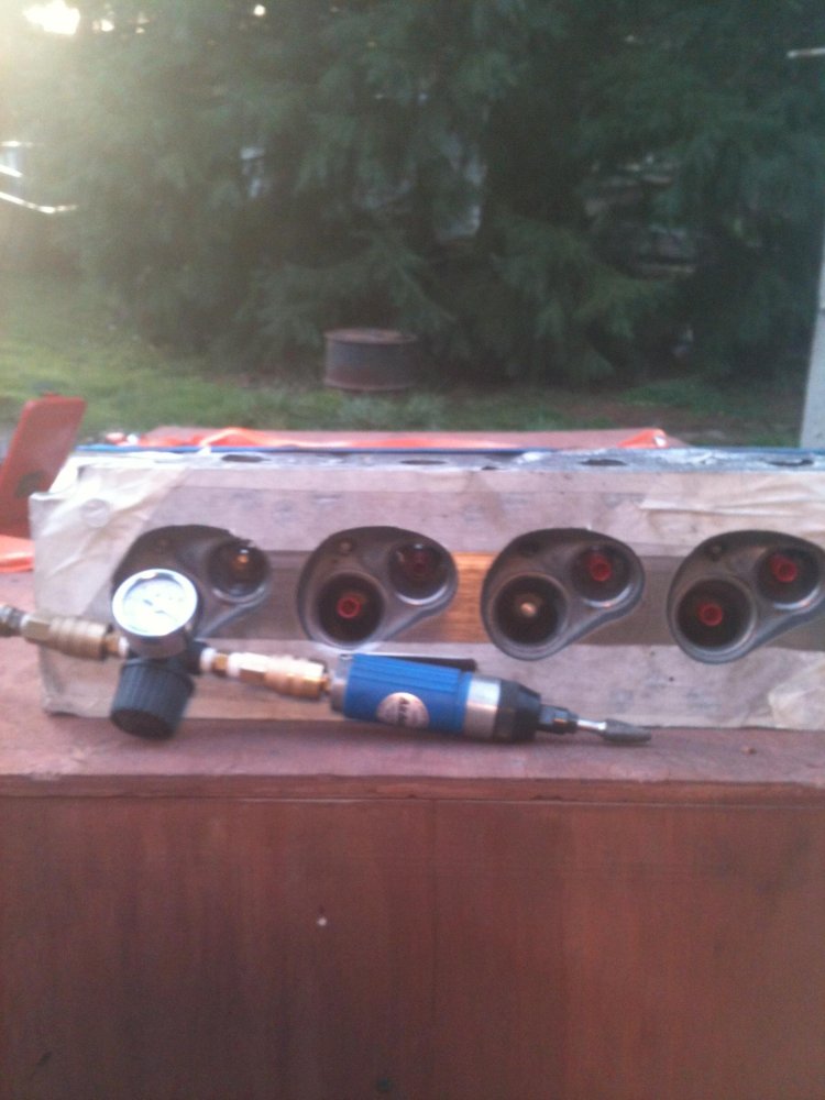

Like said, anything that improves anything will improve anything... at one point on one of the builds for my '90 I ported the head myself just smoothing things out and doing some port matching and when I put it back together I lost at least a couple PSI meaning there was less restriction and more of the air was getting into the chambers... I'm running some random turbo I found on a shelf at work (had the right exhaust flange and similar enough to mount up easyish) and am now running 15psi limited by one of those controlled leak things going to the wastegate... This is a very obtainable setup, it's nothing fancy and would be a good starting point, I'm content with the power, sure it could be more but it gets the job done. I'm sure a megasquirt setup would help it run better and so forth and I might do that one day. There's some quirks but I'm running mostly salvaged junk from the turbo engines I've found on craigslist and such... the idle has a mind of it's own some days but I haven't looked into many of it's quirks in a long time...

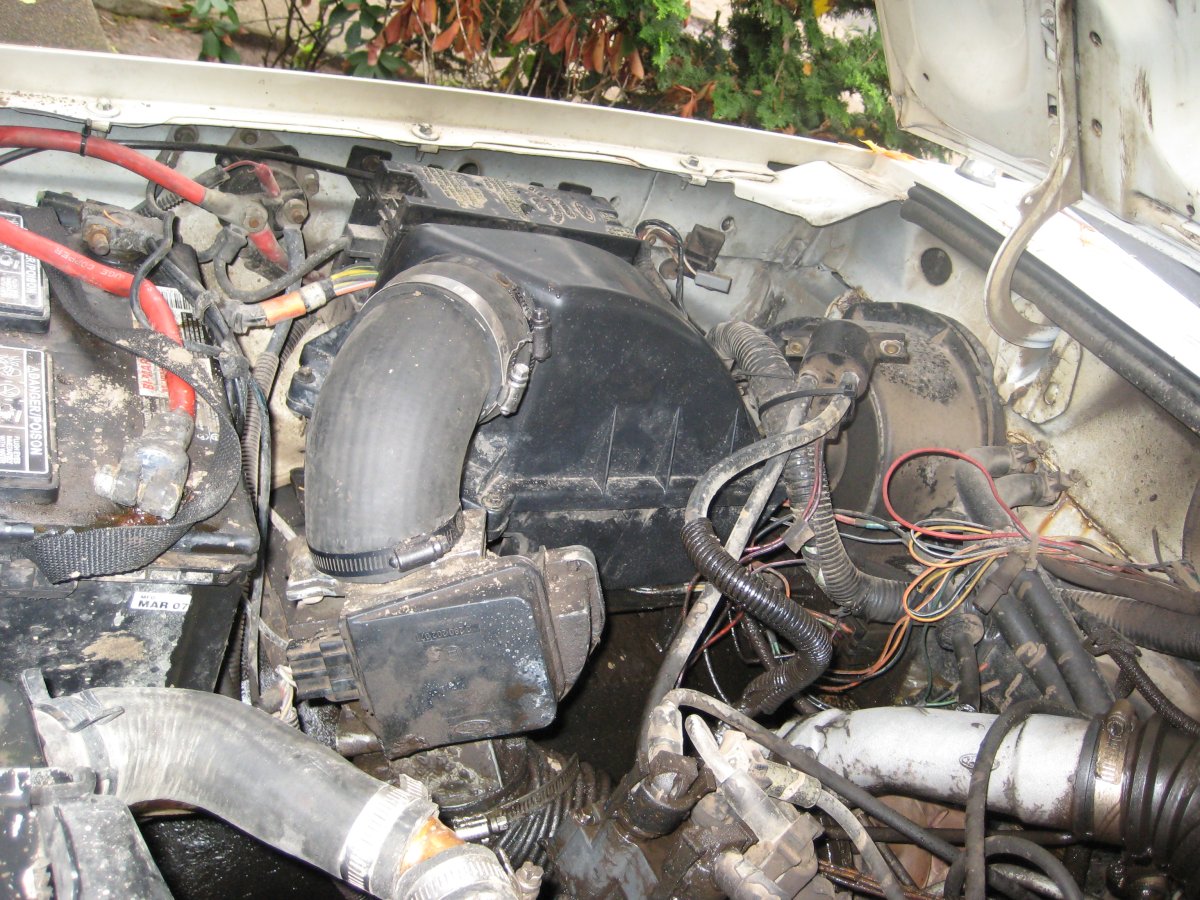

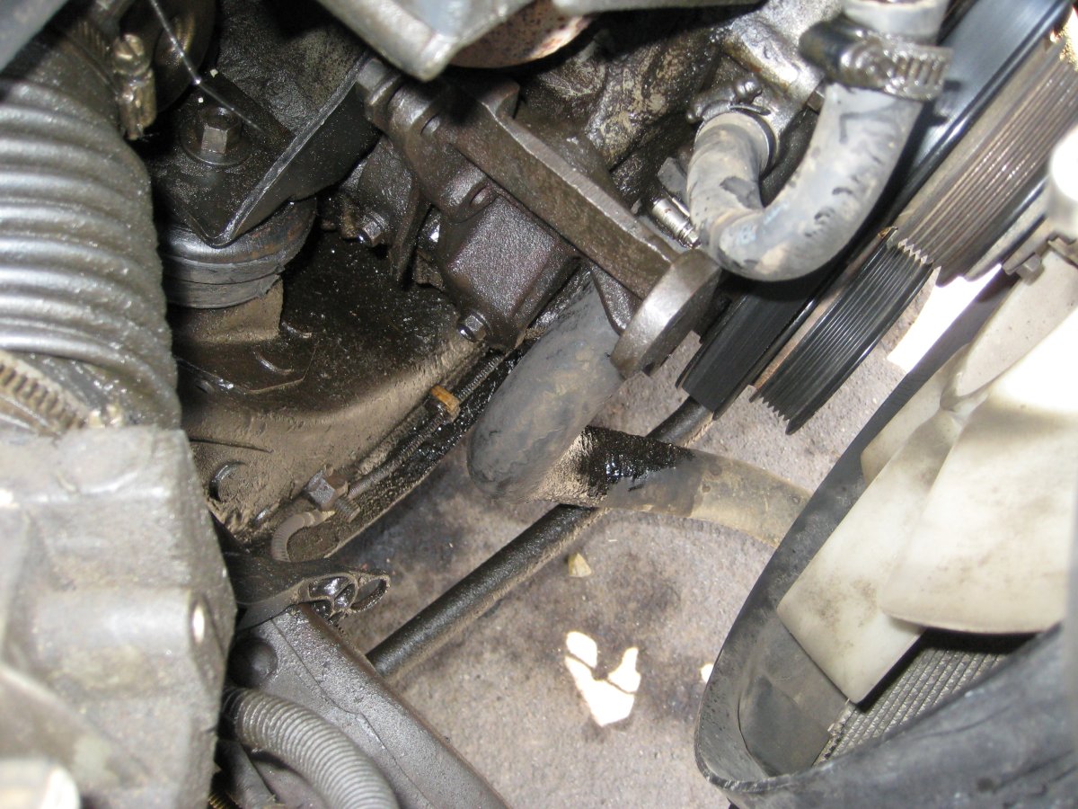

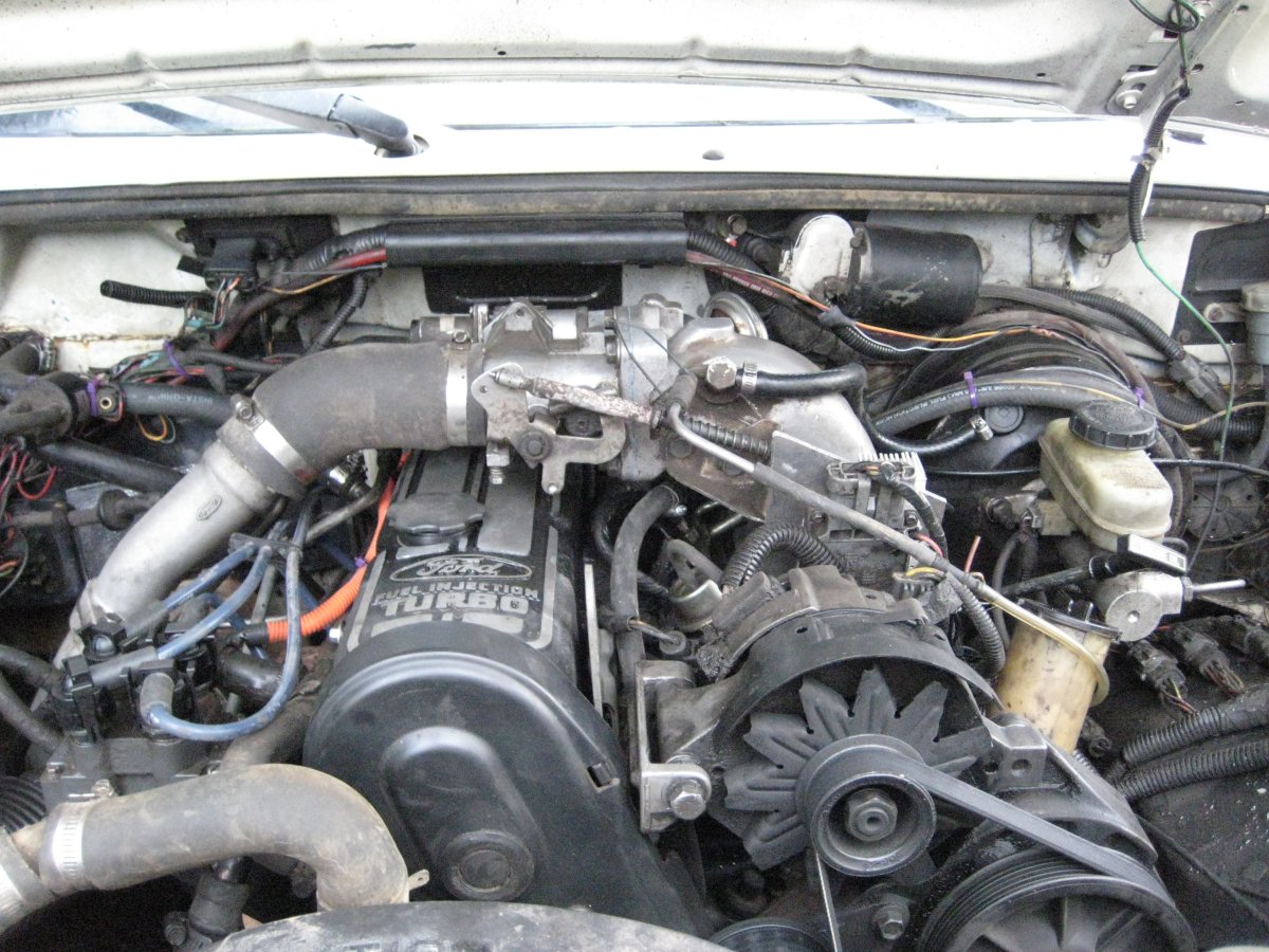

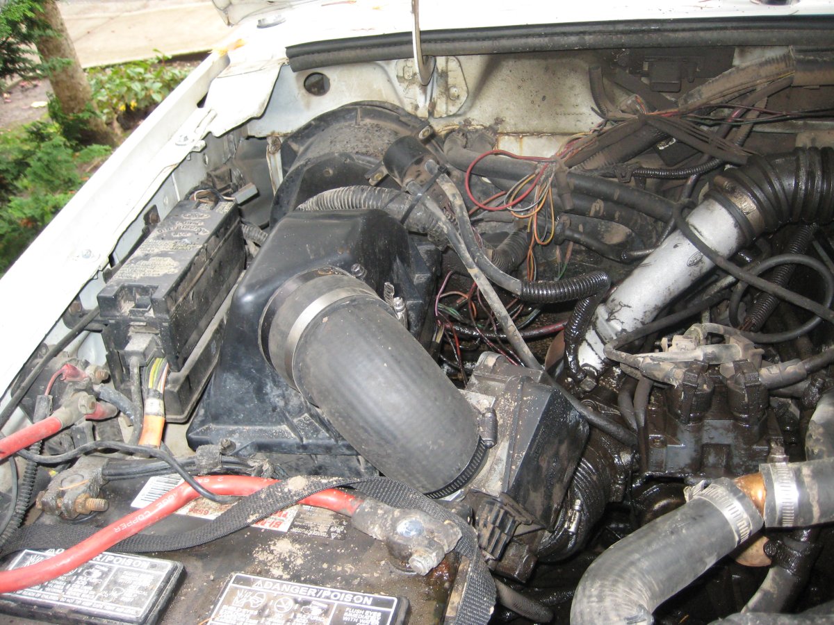

I don't think I have a dedicated post, if I did I've lost track and the forum software has likely been changed a couple times since 2009... I'll share some below. I'm using all stock stuff, pretty sure mostly from Thunderbirds but not sure, first turbo 2.3L I bought was an engine and harness for $600 on craigslist, I was pretty green but managed the swap ok, I repinned the Ranger harness (it's like 10 wires in different places...) and since I was working with a dual plug Ranger to start with I went ahead and swapped to DIS with one coil pack. Eventually I rebuilt that and reworked a few things here and there and rebuilt the engine some (honed, new bearings and seals) but didn't torque the rod nuts good enough and a couple years later one fell off at 5000rpm full throttle... next one got ARP rod bolts following all steps :). Conveniently about the time I rebuilt the first time I had found two rough turbo engines (one with fire damage, they were basket cases but not bad to have around) on craigslist for $200 so I didn't have to get too much. Other than oil leaks when I threw that engine together it's still going. No tuning, just using factory stuff including brown top (or is it green top? been a few years) injectors. I've looked into some estimates of others and it should be somewhere around 200hp, it would really benefit from an intercooler which is on the list... Oh, and I'm just running a Ranger roller cam...
The fist couple pictures are of the first iteration where my intake tube from the airbox to the VAM was drier duct with duct tape, then I made the better setup with a PRE MAF 2.9L filter lid and intake tube cut down and spliced with a PVC sleeve
Looking back I've apparently been plagued with oil leaks and a mess from the start... I start out with good intentions but eventually give up at times I guess... compared to most of these pics it's fairly clean under the hood now, the only leaks left are at the back of the engine somewhere... the rear mud flaps are no longer lubricated from the engine compartment... :)
