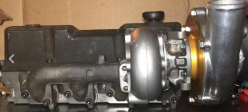

As for the turbo manifold issues. The conversions I have seen using a turbo in the stock 2.3t location interferes with the AC plenum. Either the plenum needs to be notched to clear the down pipe similar to what one would do for the valve covers in a V8 swap, or the heat from the turbo and down pipe ends up burning a hole in the box. This may not have been an issue with Scott's build and may not be an issue with the heater only boxes, but it is a pretty common theme I have seen when researching putting the turbo engines in them. Previously I also thought that turbo location would also interfere with the Ranger's location for the AC compressor, but that actually does not appear to be the case.
Talking about manifolds that do fit, you are correct there are several manifolds that will work. They just don't work as I want them to in stock form. I think I have found a solution for that. I can use a stock style turbo manifold, flip it around so the outlet is forward and up instead of aft and down. I'll need adapters to keep the ports lined up with the head, but they are available.
Stock thanks to Scott's pictures:
index.php
Flipped location using stock same manifold and flipped with adapters from Big R Motorsports:
I could also used the same adapters with a center mount tubular header from E-bay to place it so that the cold section is closer to where the hot section is in the picture above. Biggest drawback is that those headers are apparently very prone to cracking.
I had ideas on how to make it work like I wanted. I was asking to see what people who have done the swap used, and to find out how it fit and worked out for them. Perhaps I did not explain that clearly enough in the other thread.
For the ECU, I said I was weighing the options. I wasn't saying that I am not open to using megasquirt, just that I wasn't ready to comit to using it. I've done a bunch of reading and studying over the last few days. You'll be happy to know that I am not longer considering using Quarterhorse to tune the EEC-IV. That said, I'm also going to say that I will not be using MegaSquirt or MicroSquirt ECU on this either. More on that in a future post.
