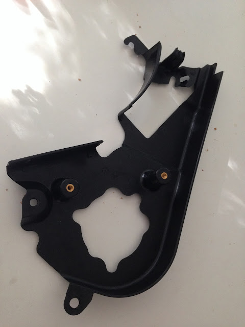

Final step is to install timing belt, however, the timing marks are on the rear timing cover, which I broke during disassembly...my replacement should arrive tomorrow...no biggie...I've done enough work for one day.

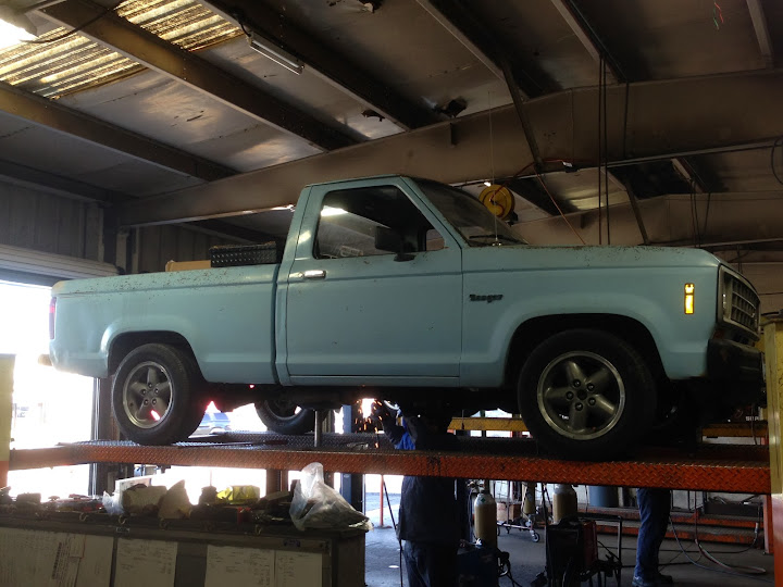

Out for SMOG...
The timing belt inner cover arrived Saturday. Brand new, Made in USA!
The truck snapped back together, seemed a bit rough, so I checked timing and it was way down. I couldn't find the SPOUT Connector. I thought I had it at 10* BTDC.
Got it on the SMOG Dyno, and they found the connector, and checked timing...it was at 2* BTDC. It failed for high NO. Ran back to the shop, now knowing where the SPOUT connector is, and properly advanced timing to 11* BTDC...PASSED!!!!
With a PASS, I was able to push the paperwork at DMV and get Title transfered, current registration and a fresh pair of plates!!!
