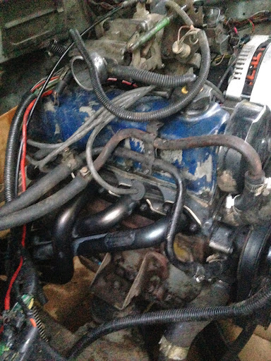

Spent yesterday deleting every trace of automatic transmission, in my '85...Today, I lowered the old transmission out and did one hell of a cleaning. It's looking good, under the hood!

I had no idea these motors were painted silver...I got all the dirt and grime off...it's down to the rusty metal and what paint that's left...I love distressed engines...

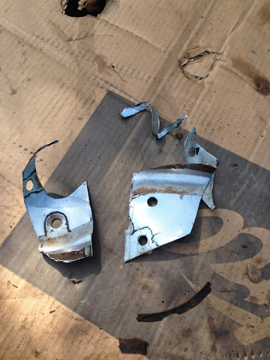

It took just a little careful cutting, with the Tin Snips, to expand the trans tunnel hole, for the M5od shifter, and two holes for the speednuts, to hold the new plate down...
