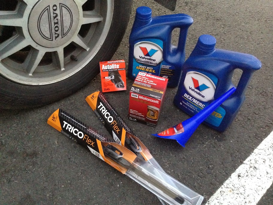

Took it for a drive around the block...automatic shifted horribly and slipped...checked fluid and it was LOW!
Went back to the auto parts store for some stuff, including ATF...
Now it shifts GOOD!
Got new wiper blades on, as it's the rainy season here, and old ones were going to scratch windshield.

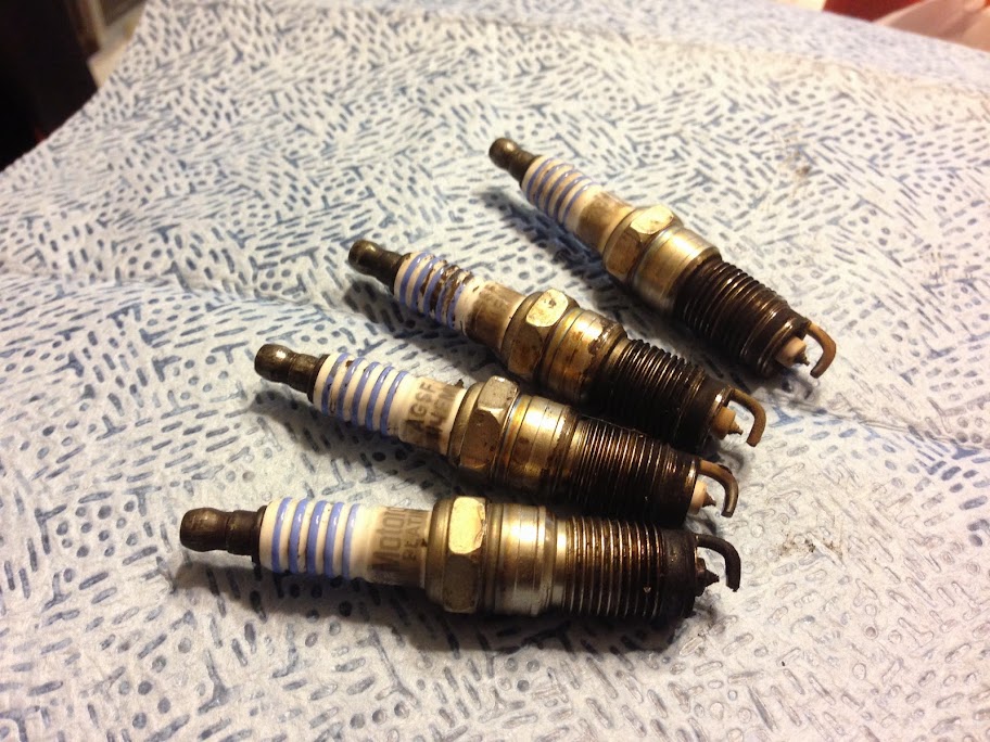

Old spark plugs didn't look too bad...
Motorcraft Platinum Plugs...
One was pretty fouled, but not as bad I've seen...
I always like to put in freshies, anyway...
Went with the Autolite Copper Core...I've always had better luck with copper core plugs, so I went that route...Autolite was $0.50 cheaper, per plug.
Simple change...

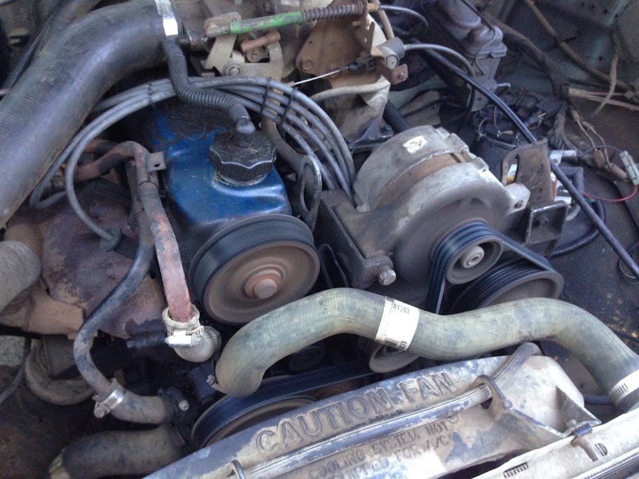

While I had the truck in the air, I changed the oil. New Motorcraft filter and Diesel 15w40 oil. I felt a loose hose, while trying to unscrew the oil filter. Upon further inspection, I found this, dangling and disconnected...
It appears like it could be for the coolant line, from water pump to cylinder head. There's a continuous hose back there...maybe this had been bypassed.

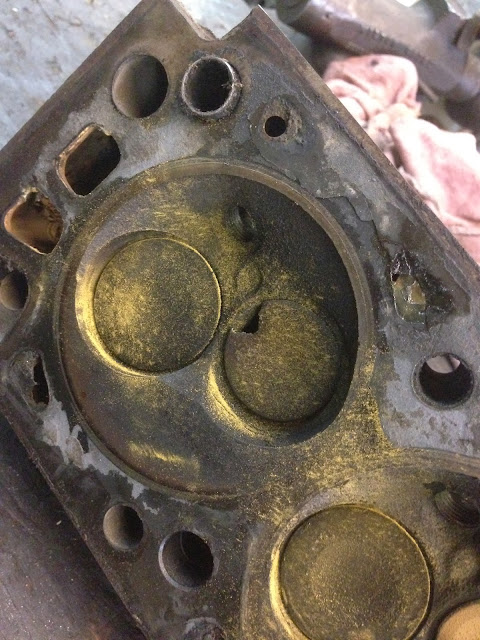

I checked compression, to see why the engine is running so rough. ZERO COMPRESSION on #4 cylinder. Old school check to see if it was rings or valves, proved it's the valves.
Head off...
Just look at the carbon buildup on the #4 piston...
Head is at machine shop, getting rebuilt with fresh springs. They're gonna mill it 30 thousandths, to get me some compression!
Bummer as it is, I am stoked to have a freshly built head and higher compression. She's gonna be a screamer.
