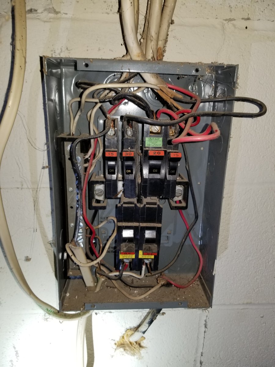

I already have a wire going to a meter box on the shop. This is the breaker box it was connected to:
There wasn't even a main shutoff for that box. The wiring in this building was on the sketchy side.
I removed that box, cut the wire from the meter (There's no meter on the box. They removed it because the service had been cancelled), pushed the wire back through the bock, sealed the block, and painted the wall.
