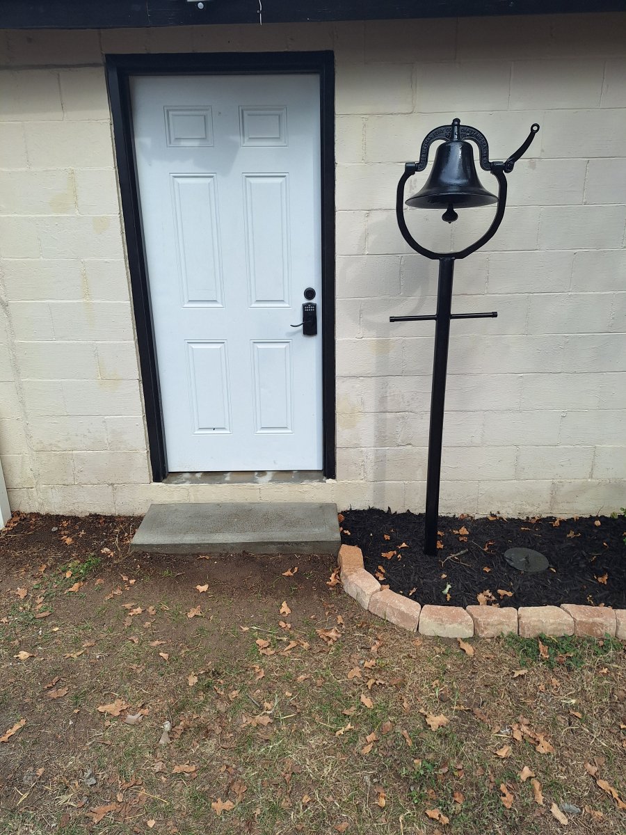

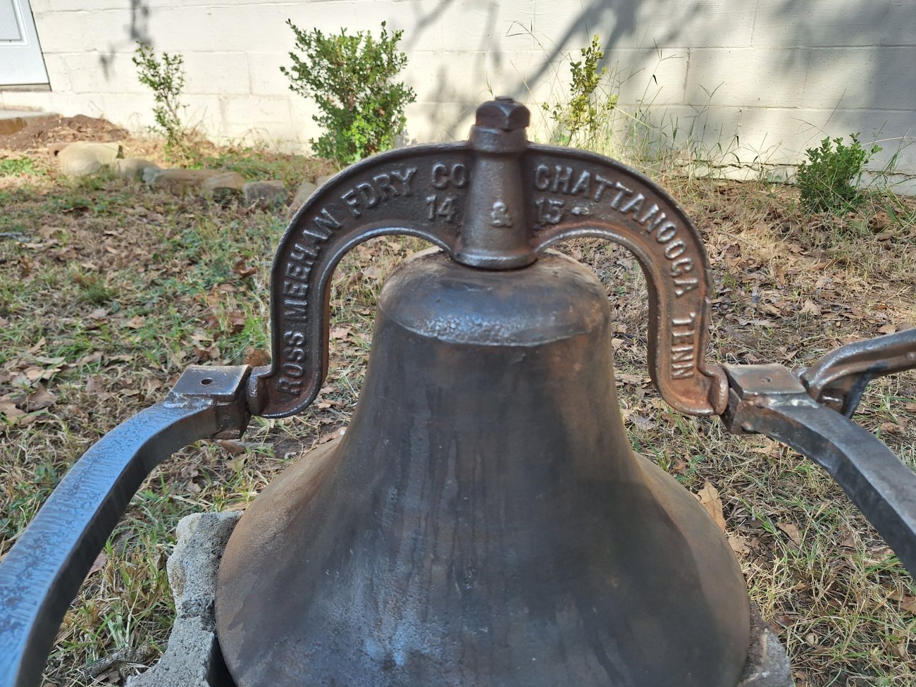

Back around the 1920's my great-grandfather gave my grandparents (My dad's parents) this Ross Meehan dinner bell. My dad was born in '33 and said back then the bell wasn't just used on the farm to call you in for dinner, it was also a tool to call for help from other people in the valley. You could call for help or warn people of dangers.
My grandfather passed this on to my father, and it stood at the corner of our garage when I was growing up.
My father gave me the bell when I bought my first home, and I've had it at every home I've owned since.
When I moved to Texas it laid next to my daughters garage for a few years while I lived in an RV. After I bought my house it finally came home here, but it laid in my shop because I had cut about 2-feet off the bottom of the post to move it at some point, and didn't have any way to weld it back on at the time.
Last week I stripped all of the old paint off, welded the cut section back on, repainted it with RustOleum
And finally cemented it into the ground.

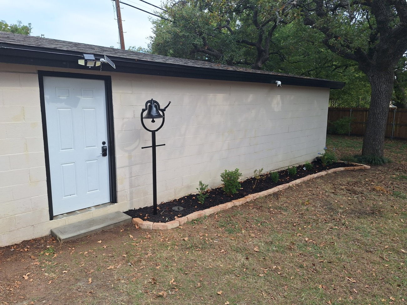

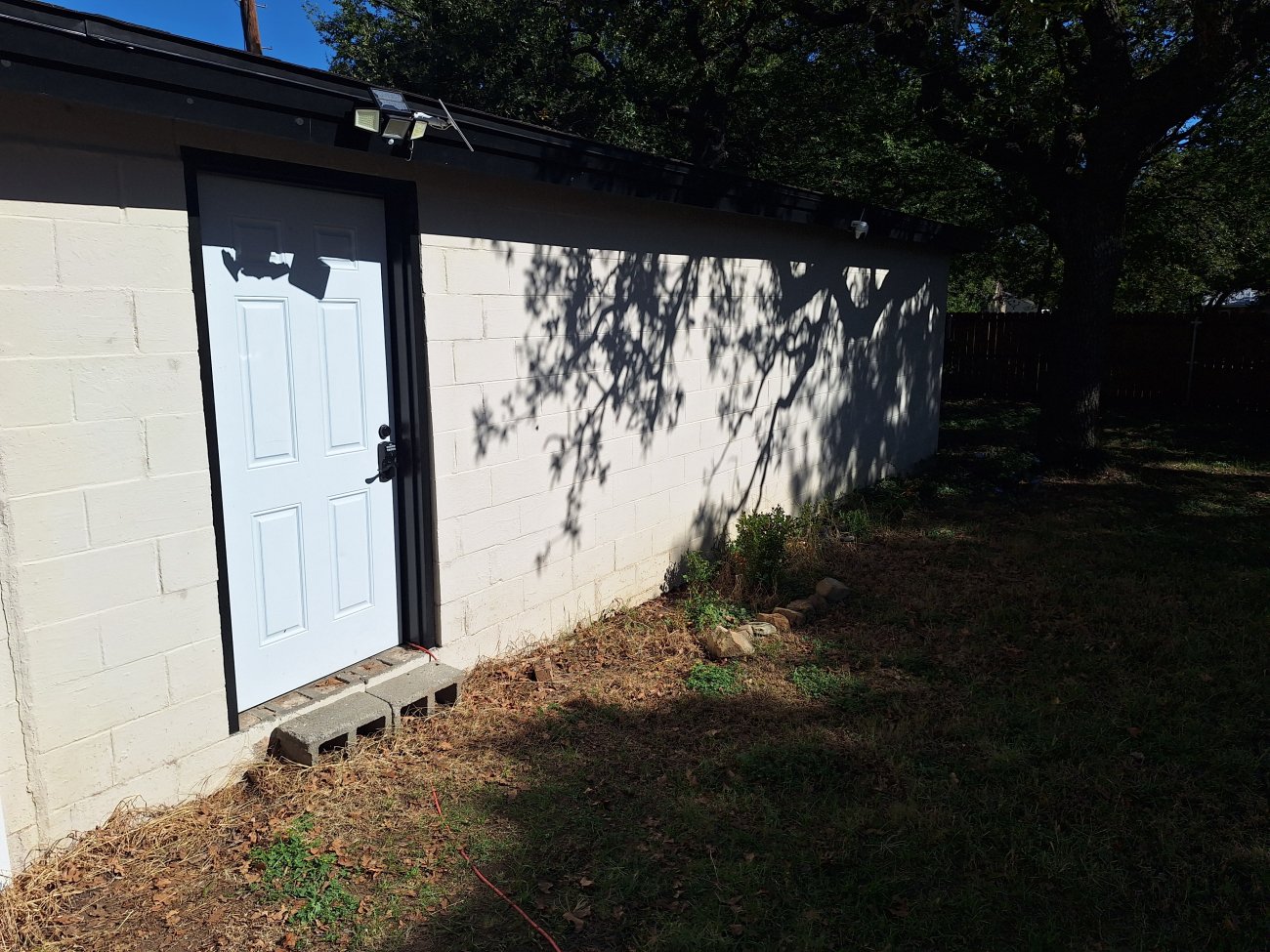

I had also made a new step outside the shop to get rid of the old cinderblocks.
Last spring I moved some shrubs from the north side of my house and planted them here because they were dying. I weeded around them, put down a weed barrier and a stone border, and filled it in with mulch. Now the side of the shop is starting to look a bit more presentable.
