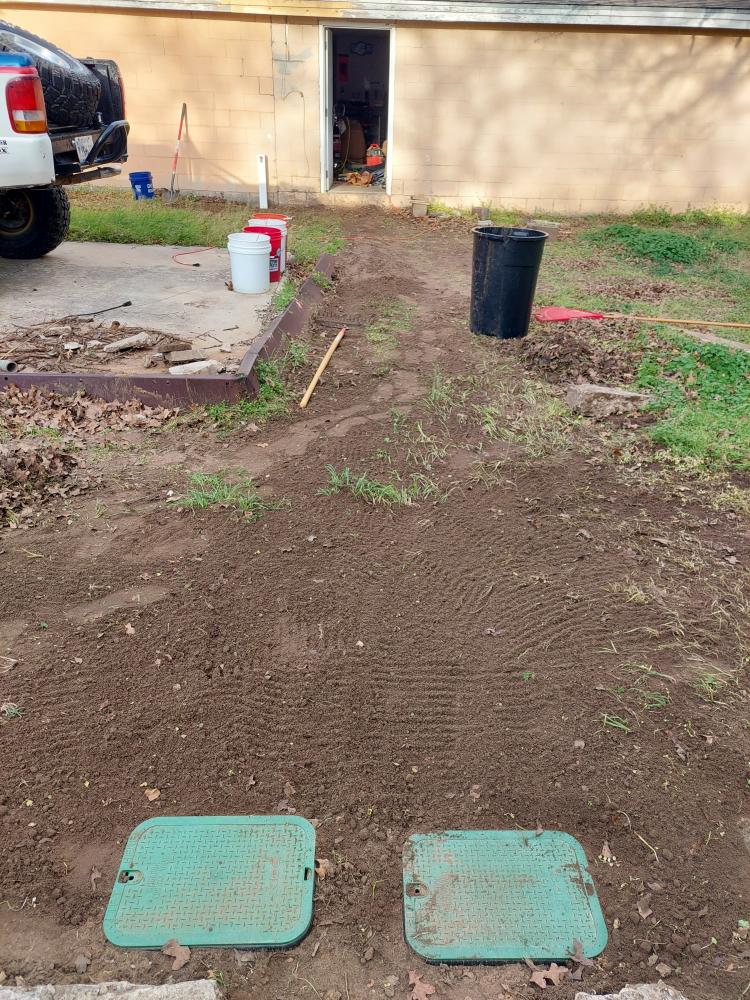

The line is buried and the valve boxes are in.

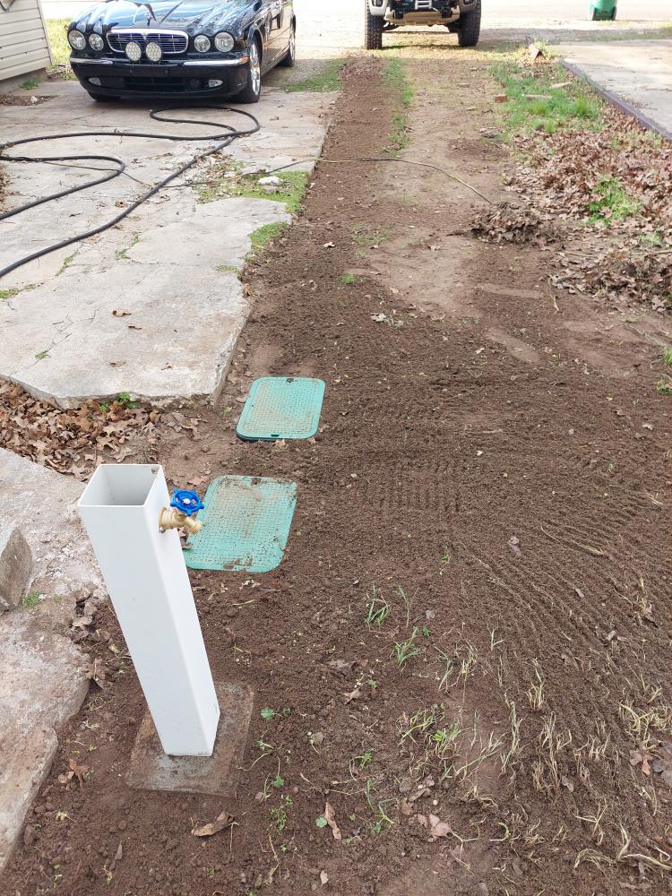

This spigot doesn't appear to be leaking. I used the Rectoseal 5 on it.
This was the first spigot I installed. I removed it, removed the Teflon tape and used the Rectoseal 5. It still has a small trickle of water running down the face of the post.

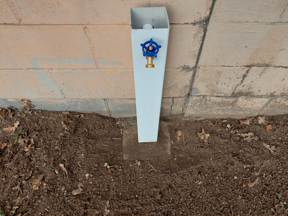

This is going to be my next attempt to stop the leak.
With my luck... that free standing spigot would be broken off within 6 months.
All looks great, very frustrating on the leaking

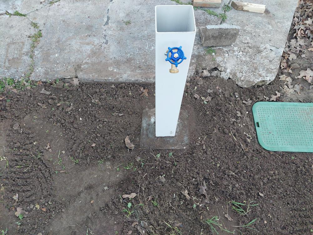

Someday I might actually fix that concrete slab and landscape around that spigot.
Still waiting for the white post caps to get delivered.
