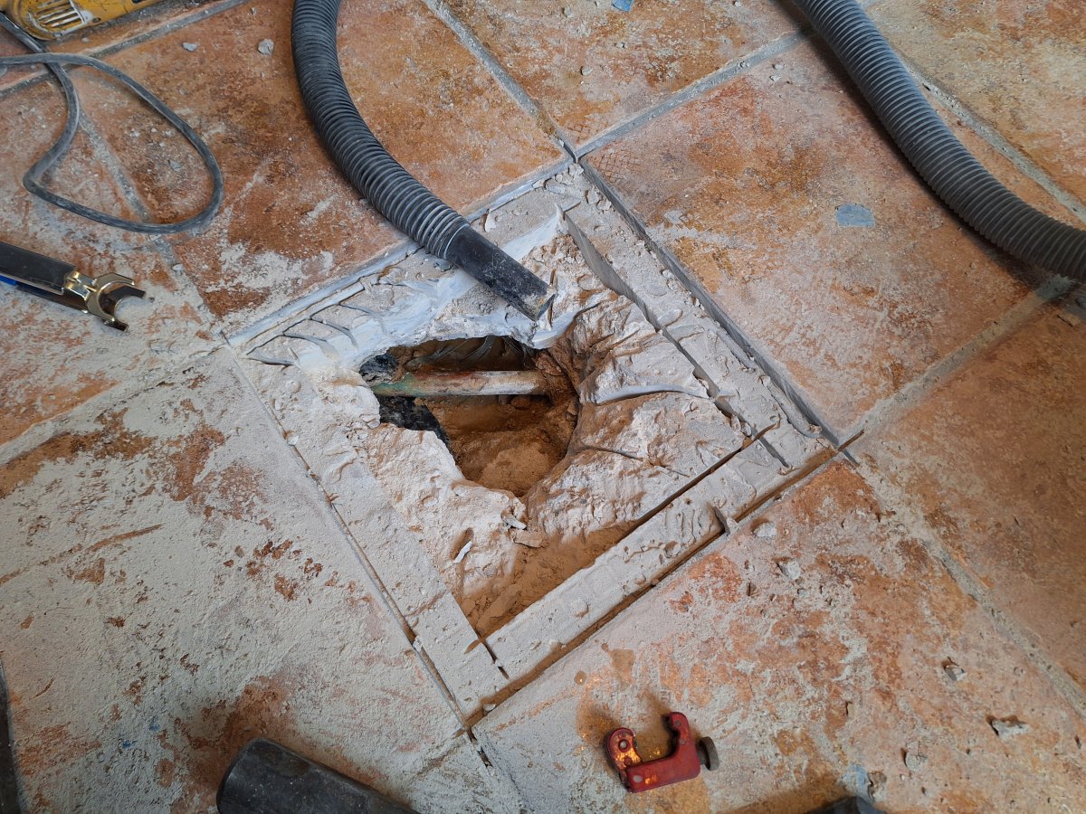

I spent all day Saturday fixing a hot water line leaking under the slab in my daughters house.
Here you can see water coming out of the pinhole leak. The eater from the hoteater tank was shutoff. This was the water left sitting in the pipes.
For some reason there was a gap in the vapor barrier and some of the pipe had cement on them.
Bad section cut out. Now time to clean up the copper pipe.

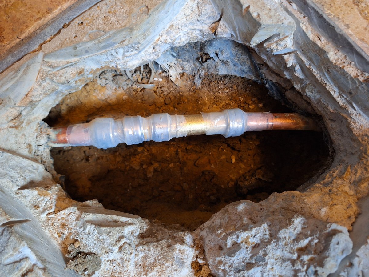

A coupling and slip coupling with a piece of PEX in between. I didn't have much room to work, so the PEX piece in the middle is 2.50" long (1.25" + 1.25"), just long enough to engage both Sharbites. I wanted a 0.25" inch gap in the middle but i got tiredof trying to wire wheel and sand all of the cent and crap off the pipe, and the closer it got to the edge of this hole the harder it was to work.
I spent 12-hours removing the ceramic tile, cutting, hammer and chiseling through that tough ass concrete, going to Lowes for parts, cutting the pipe, cleaning the pipe, smoothing it with 600 grip paper, getting the fittings on, and then getting the slip coupling to slide into the other joint. This copper pipe was slightly bent so the coupling didnt slide easily.
Went back over today, made sure it wasn't leaking, wrapped it with sharbite tape, filled the dirt/sand back in, put down some plastic, and then covered that with concrete.

It was going to cost them thousands to have a plumber fix this. Doing it ourselves cost them about $110.

How on earth did you ever find where it was leaking?
how did you pinpoint the leak under the slab? infrared heat detector?

My son-in-law first noticed that the floor was getting hot before realizing they had a leak. The spot under this tile was the hottest. This problem has been happening for a while. They've put off fixing it because of the cost. They were shutting the hot water tank off when they weren't using it.
I'm shocked and blessed that it was all confined to this one point.
I got worried when I saw the missing vapor barrier. First thought that was the reason it was the warmest here and the leak could have been somewhere else, but as soon I started digging you could see the water leaking.
I'm wondering if the gap in the vapor barrier allowed concrete to damage the copper pipe over time.
