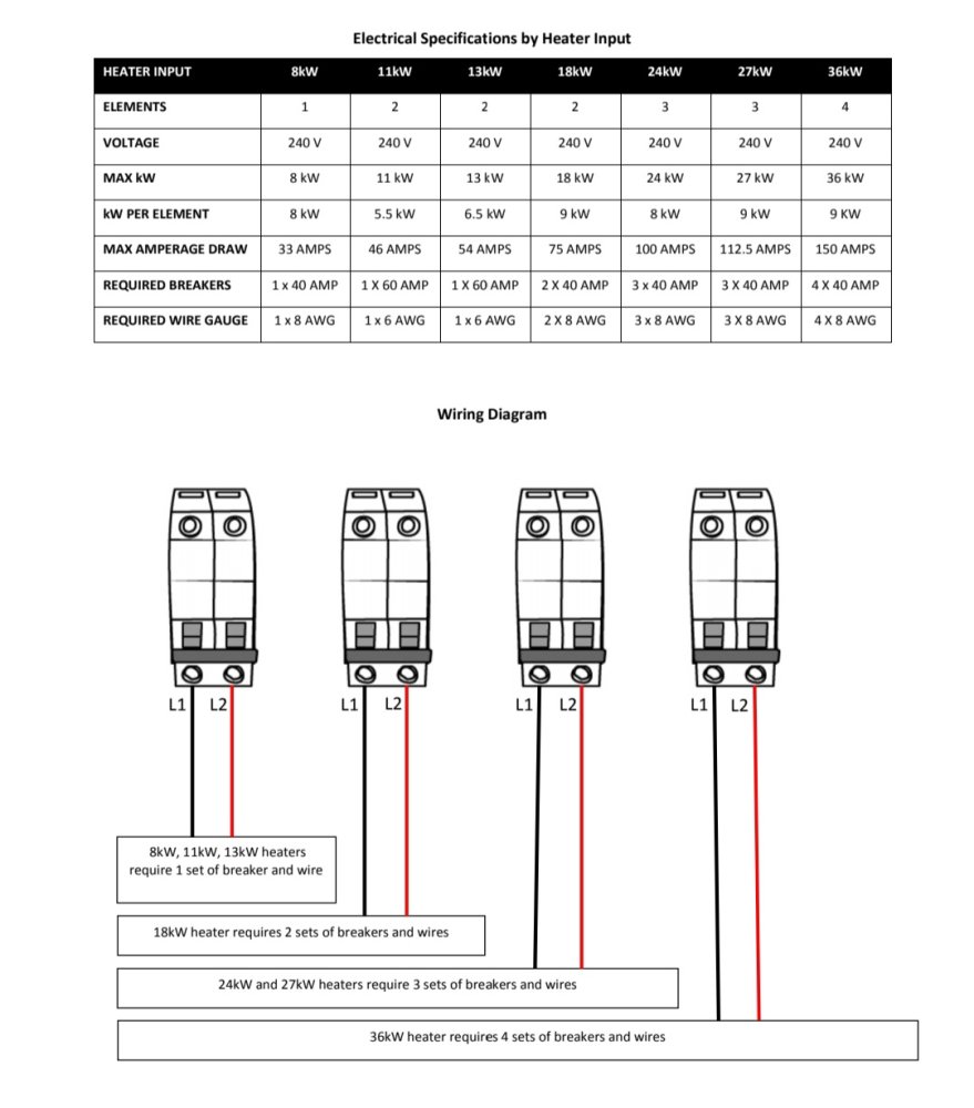

I need to finish up the bathroom plumbing and I'm trying to decide if I want to add a tankless water heater, or a small 4-6 gallon water heater.
The tankless are 240 volts and will require either a single double pole breaker and 8ga wire or (2) double pole breakers and 6ga wire.

I'm confused about your breaker requirements. Why does one model of thankless require 2 double pole breakers? It only takes 2 pole spaces in the breaker panel to get 240 volts regardless of whether it's 40amps or 60 amps.

@ericbphoto this is where I got the info about the wire and breakers:
