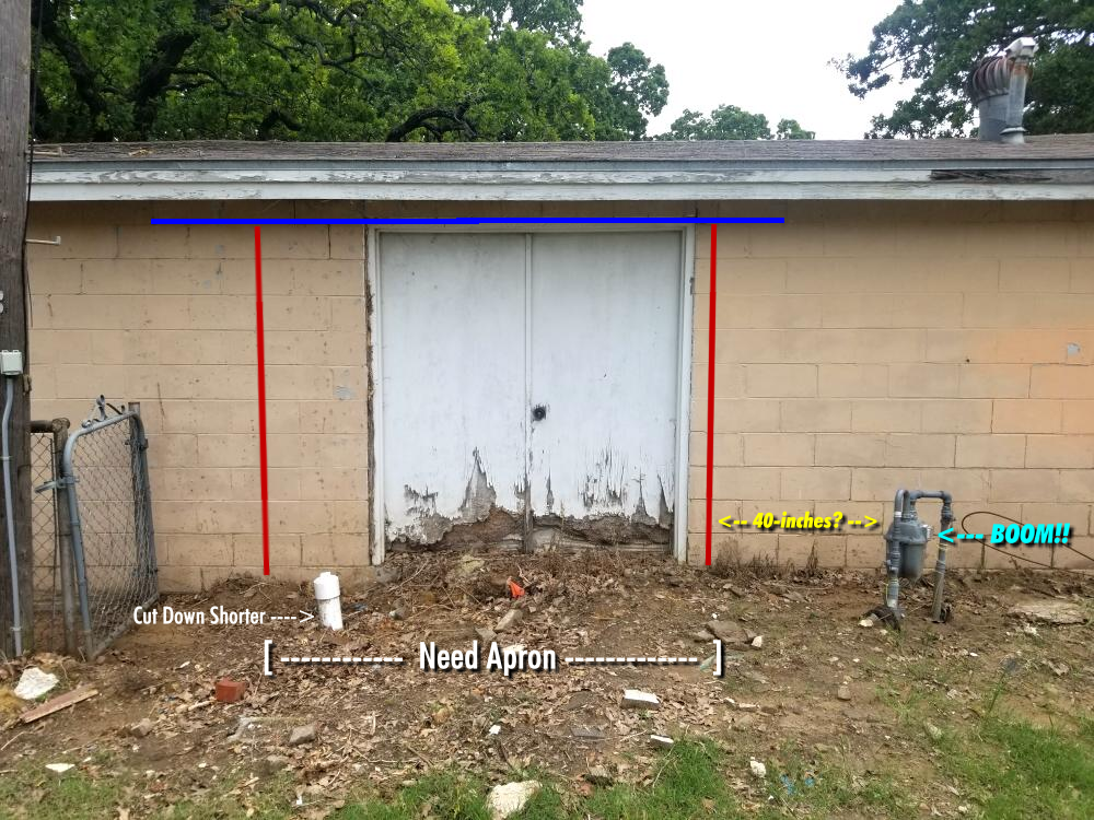

I would just dig out the grout on the inside blocks, install a 3" x 3/8" steel angle iron lintel with pre-drilled holes for cinder block anchors. Wood makes things more complicated. Same goes for the new barn door but a larger angle might be needed. I've installed a few barn doors and the rodents and pests always find a way through the edges so a sealing jamb type door is a must . You can source surplus steel from any steel supplier in your area and it's permanent. You might also find that both openings have rebar over them with a solid concrete fill in the cavities. Go for the largest door for vehicle entry you can do, I would never go less than 8" if you can. Whatever you do I bet that gas riser and regulator needs to be relocated per local code. The two window idea is good rather than one single wide one. Again, steel is King.
Why would the gas meter need relocated?
Usual reason is that its too close to an opening. Here it needs to be at least 3' away from vents or opening doors and windows. This is to prevent potential gas ingress if the meter leaks or vents.
Yes, there is a code. My first inkling is to think how you drive or how your beverage of choice drives. If it’s not in danger, I’d put some stout stakes up high enough to see and avoid.
there is no issue with cutting the clean out down, so just shift the door that way.
The gas company and the inspector are not going to come knocking on your door and say the gas meter’s to close. The only reason they’d pay attention to it is if it got damaged or if you complain about it

I guess I'll have to move the door to the left then.
I need to take out the rotted sill plate and come up with an apron to drive in and out of the building. Basically don't want to be tearing up the slab drive up over the edge of it. This might be something I'll have to hire a concrete guy for.
That gas line is polyethylene and runs from the meter to the left and around the corner of the building. It's a straight shot (under) from the meter to the house, but my guess is that at some point it was rerouted around the building. Is there any rule that says my apron can't go over it? It's fairly deep down there. The plumber hit it with his little excavator when he dug up and installed that clean out. He had to fix it because it started leaking. I question if there's still a leak. I keep smelling a faint hint of gas. Probably have the gas company come out and check before I do any work over here.

Yes, have the gas company check. If it’s an underground leak and accumulates under the slab, BANG “Jim’s Flying Ranger!”
it’s probably just the meter. They’ll puff once in a while as part of the regulation process, but best to check.
& yes, concrete can be placed over it.

& don’t go so far left with the door that you limit utility between the trick and the back wall.
my 2 cents
That's bad advice, right there. Any inspector with a brain would insist that the meter be moved. There's a reason that it has to be three feet from any opening. You DON'T want gas in the building. Read this: https://www.snellheatingandair.com/blog/family-risk-carbon-monoxide-poisoning/. It also talks about natural gas leaks. The stuff can kill you.
Even if Jim doesn't need a permit to move the meter, and wouldn't have to have it inspected, the meter should still be moved, because any job worth doing is worth doing RIGHT.
The gas meter relocation is a must do IMHO. As others have stated it's a safety code issue. If you do relocate it mount it against the wall rather than sitting out in open space like that. If you smell gas it's either the regulator, a threaded connection, or poorly repaired nick in the buried line and should be checked immediately. Also I've never seen cinder block construction without some type of poured concrete, steel, reinforced lintel (header), or bond beam installed. There must be some type of header over those openings unless it was built by the Hucklebuck Brothers without permits.
