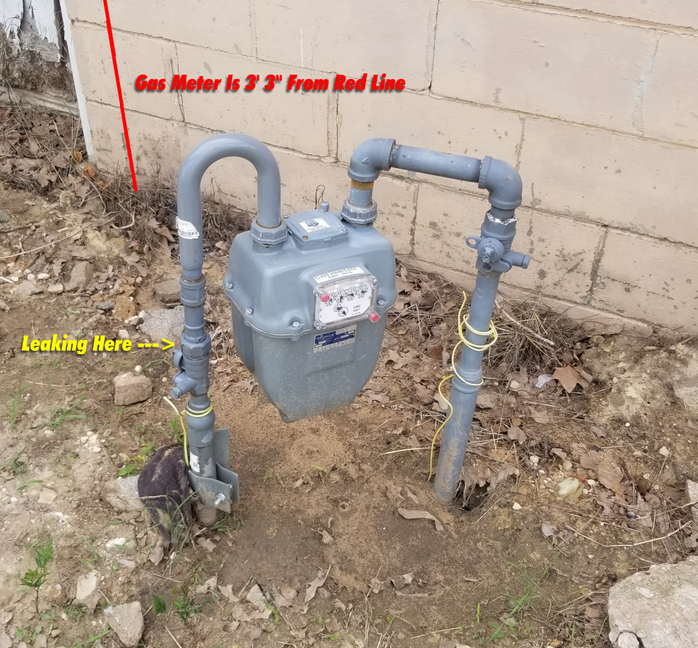

For clarity. I said:
“it’s probably just the meter. They’ll puff once in a while as part of the regulation process, but best to check.”
You know I speak with colorful language for fun, but sometimes it can be misinterpreted. What I meant above was that the device, the gas meter which also has an integral pressure regulator Can “burp” once in a while, which I called “puff.”
I was speaking to the chemical engineering principles of regulating the gas pressure and flow, not to the government and political regulation of the zoning parameters.
I also started out with:
“Yes, have the gas company check.”
which I still fully recommend, as I would recommend any time someone thinks there might be a gas leak.
no worries here, more minds are better than one....
60684
I called the gas company. They used the sniffer tool and detected a leak at a connection going to the meter (see arrow). The sprayed soapy water on it. It bubbled. The guy tightened it with a wrench and re-checked it. No more leak. Checked the area where the plumber had dug, and then checked around the outside of the shop and my house. No other leaks detected. Good to go.
The distance from the meter to the red line where I'd cut the wall open is 3' 3". So I'm at least 3-feet from the door opening. :icon_thumby:

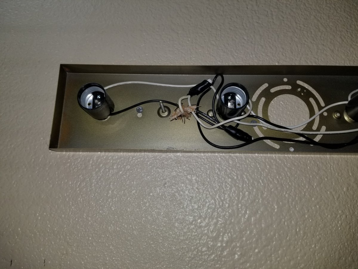

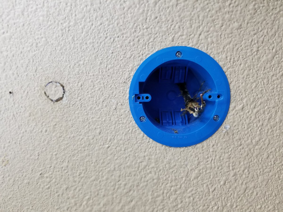

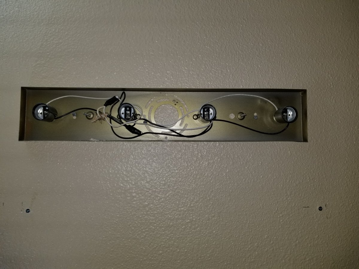

Today's frequent reminder that this house was previously remodeled by a dumbass.
60722
Installed a box, ran the wire in to it, and plugged the wire hole with a piece of the drywall I cut out and some construction adhesive. Touched up the wall with some compound and then painted it before mounting the new light fixture.
