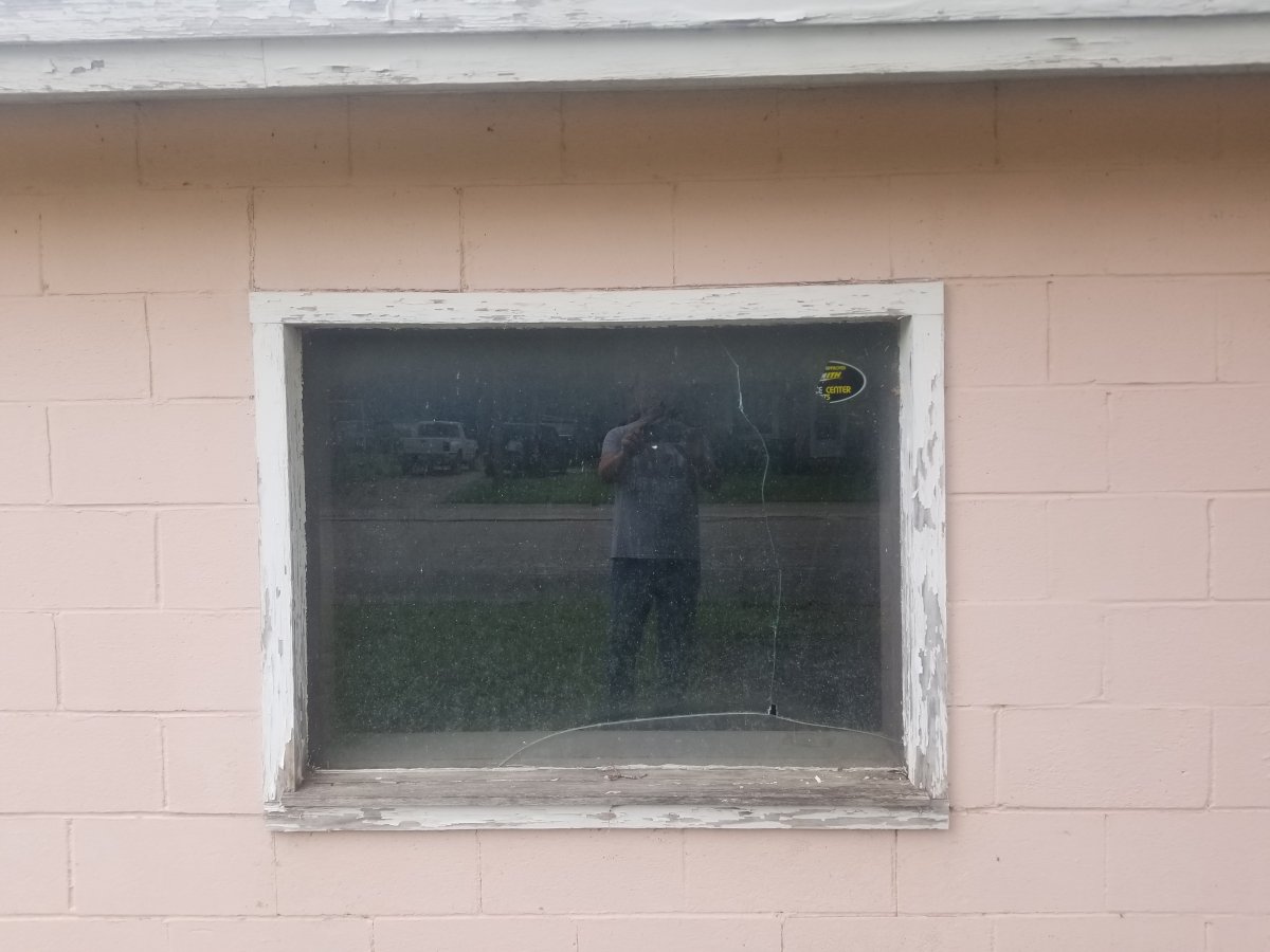

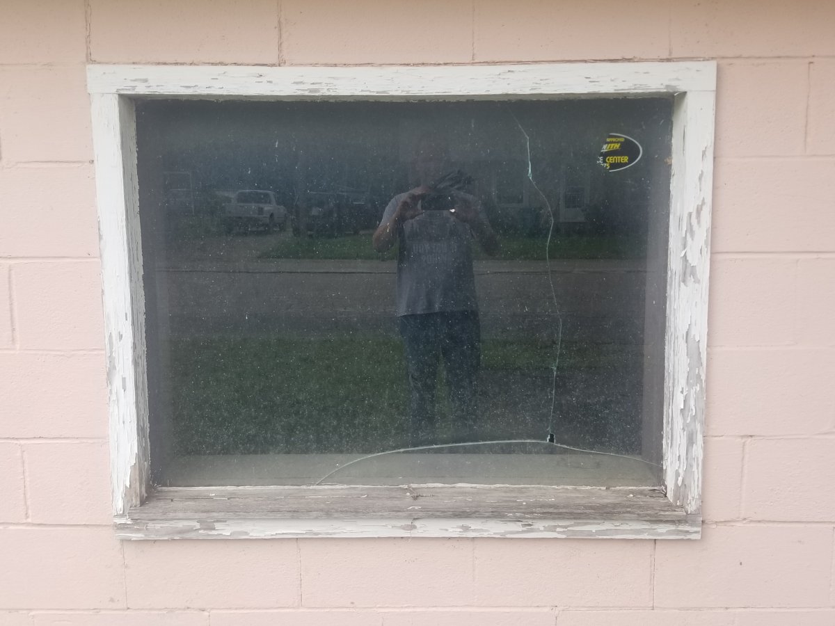

Do I have to install a header when I replace this window, or can I just put in a rough opening with 2x8's?
The concrete opening is 52" x 40". I was going to install (2) 23.25" x 35.25" windows side by side, but if I install a 2x8 on each end and (2) 2x8's side by side in the center of the opening it will only leave me with a 23" width for each window.
I found a 47.5" x 35.5" window that would fit if I framed it with a 2x8 and then added a 1x8 along either the top of bottom and one of the sides.
Ply Gem 47.5 in. x 35.5 in. Left-Hand Horizontal Sliding Vinyl Window - White-520 - The Home Depot
I'm trying to come up with a solution using a new window I can pick up at Home Depot or Lowes and not have to special order.

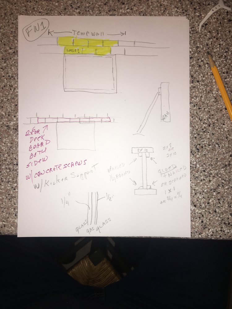

It looks like the top left block may be loose. I can’t tell if there is a metal header under the block above the window frame. They may have used the window frame to hold up the block above it. If that block area is firmly mortared together, It may just stay up while you swap out the window frame. But I wouldn’t count on that.
You could cut four 2x2 little columns to span from the bottom 2 x 8 to the top 2 x 8 on both sides of the existing glass to support that spot. Then you could saw cut out a little space in the top window frame between them, and look up and see if there’s any kind of header or if the blocks are full of concrete, and determine its stability if you pull the window frame
OK, what’s the worst that could happen.
You pull out the window frame and that one block falls out. You can put it back when you put back the window frame.
Or you pull out the window frame, and all the blocks above it fall out. See my yellow highlights on the top of my sketch. Again, you can put in the window frame and then put those blocks back.
I don’t see how if you take out the window frame the whole wall falls down, but if the blocks above fall down, it’s possible the roof will sag in that spot. So what do we do?
Murphy lives strong within me. I would build a temporary wall, like you’re doing for the truck door, and extend the temporary roof support about 2 feet past either side of the window. Drive it in place so it is pre-loaded
If you’re comfortable putting the blocks back, I might risk just pulling the window and see what happenes. As an alternative, you can take a 2 x 6 or a deck board, spanning across the blocks on top of the window frame, and put two or three concrete screws into each block. Do this on both sides. Then, hopefully, when you take the window out, the deck boards will keep the blocks in place. When you’re done, you can take it all out and grout the screw holes. If the block looks wobbly at all, I would augment these deck boards with a kicker down to the ground on each end on both sides of the wall.
if the blocks above look wobbly, you can chip out a little bit of the grout underneath that row of blocks inside and out. You only need to go a quarter inch or three eights of an inch deep. Then, screw a flat metal on the bottom of the temporary deck board, so it extends out about a half an inch. It could be any kind of flat stock that’s at least an inch and a half wide, like the aluminum stuff you use between two sheets of flooring. What you’re doing is putting a little support lip on the inside side of the deck board that will mechanically support the block in addition to the screws.
If you don’t need that window to open, I would frame the opening with two by eights, make a thermal pane window that’s 1/4“ x 1/4“ smaller than the minimum width and the minimum height. A glass shop can make that for you, I’m talking about a piece of glass without a frame, and I’m pretty sure it will be far less than any complete window kit you can buy.

Close, but there is a crack in the glass. Probably from a mower throwing gravel through the hole.
I would assume that’s the only reason Jim cares about this window.

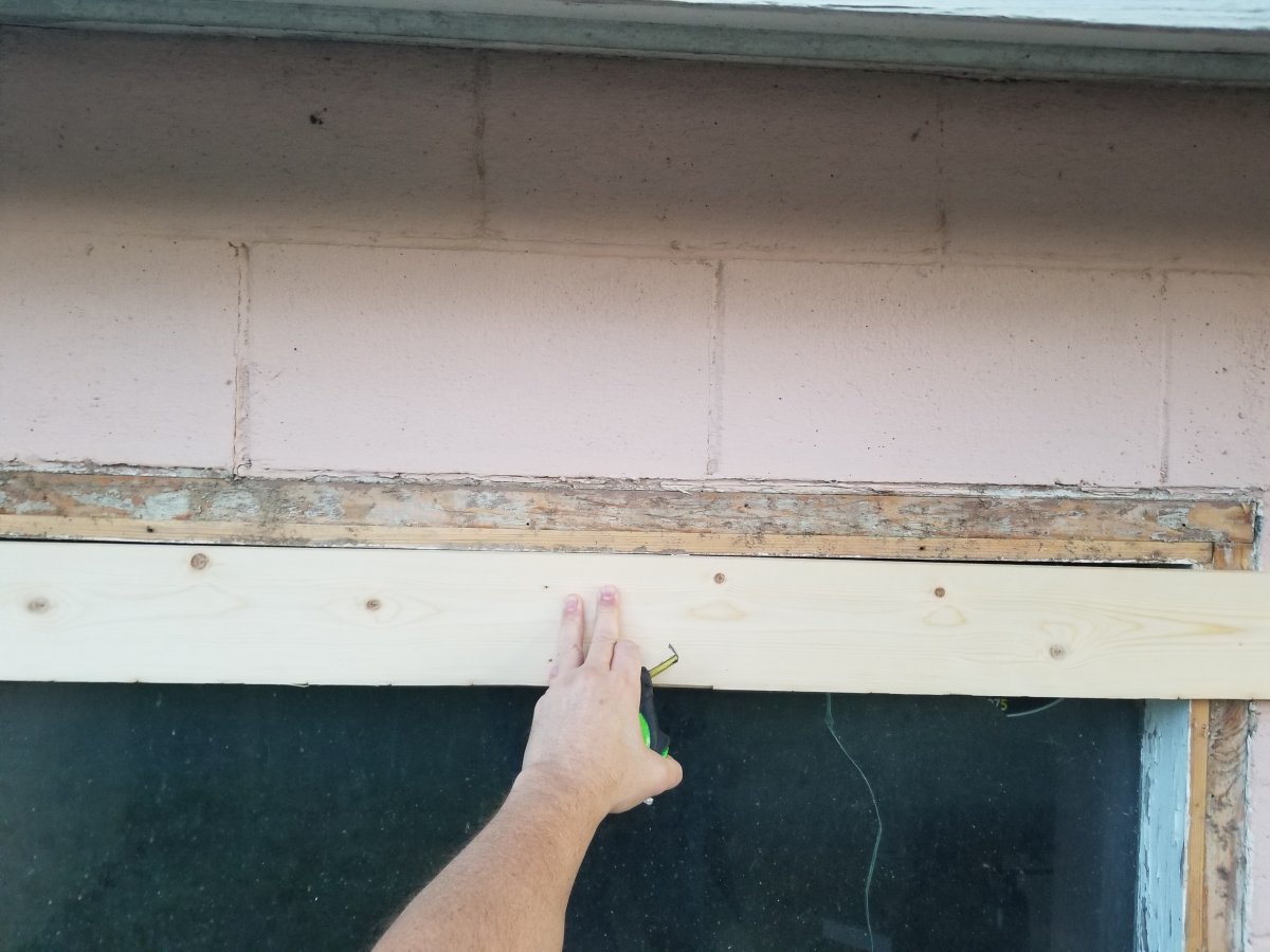

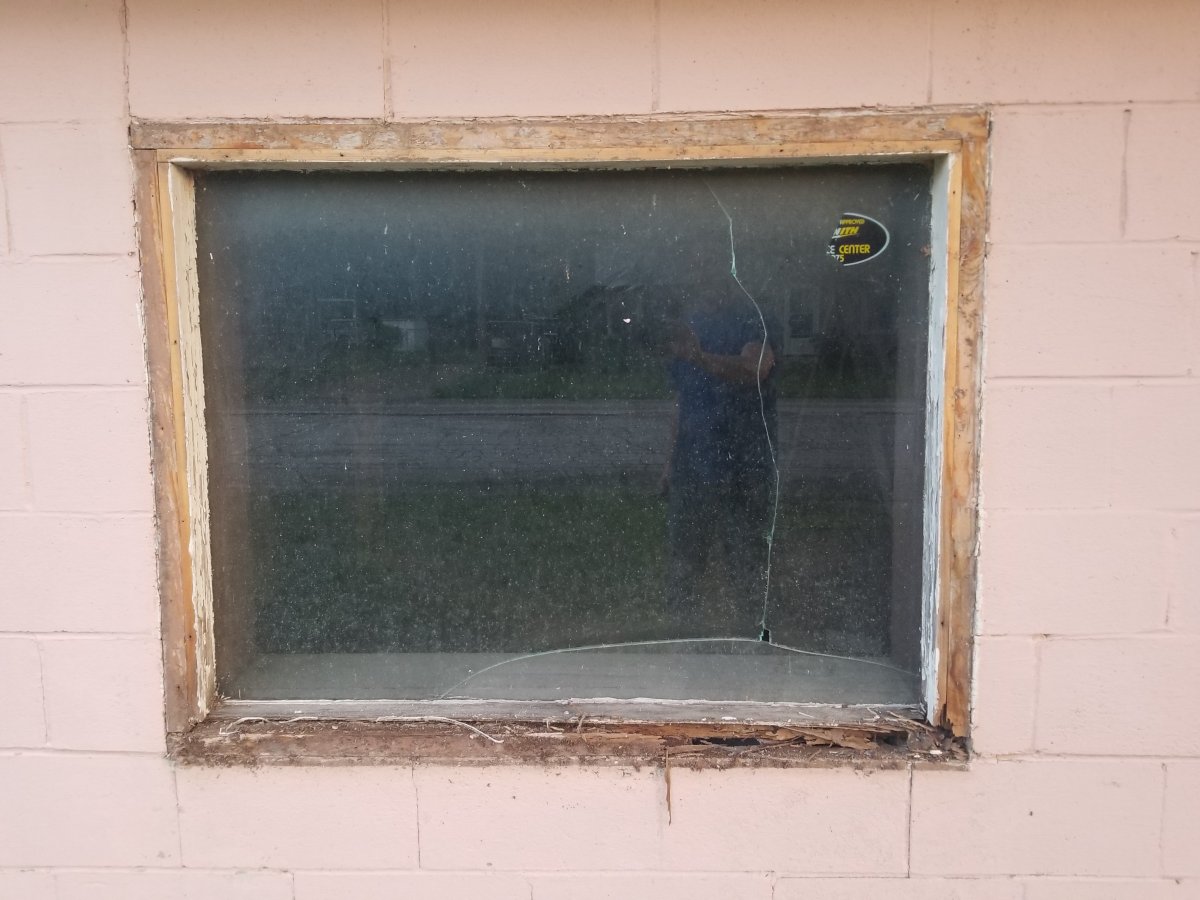

I took the trim off. You can see it was framed with 2x and then a 1x has been used to sandwich in a 1/4" thick pane of glass. There's a slight bow in the top of the frame. At this point I don't know if the wall pushed it down, or if it was put in after those blocks and it's just following the contour of the mortar. I know they set metal door frames and lay brick around them, but would it have been normal at some point for someone to set a wood window buck in place and block and mortar around that??
There isn't any metal over that header. Just mortar.
I'm not sure if this glass was broke from an object hitting it, or from downforce pressure. You can see that the lower right half of the bottom plate is rotted / eaten away as well.
I 'm guessing the 2x's on the side are screwed in to the concrete. Or at least I'm hoping they are. I'm wondering if I could get that bottom plate out with a sawzall, install a new one, wedge a 2x8 in the middle, and then replace the right side. I could be wrong, but I can't imagine that piece of glass and rotted bottom plate is holding that wall up.

If the top 2x is salvageable, you can support that with a couple IIx boards that angle down to the ground held in place with a little stake. Then take out the rest of the window, and put 2x on the side and on the bottom. Do it where you have to tap the verticals in place so they’re a little preloaded. I don’t think the blocks whatever move if you did it that way.
if you can live with the bow, like my drawing above, I would just use a one by one or maybe a hair bigger on one side. The glass, you just have to make sure that the narrowest width and at the narrowest height it still has about a quarter inch of free play. That will disappear when you put the trim on, but if the wall ever moves it won’t break the glass. Then you can put a 1/4 round to finish it up.
you could install the 2x So it is flush with the black face, and then simply trim it with the molding that stretches over the block a little. If you paint that and Koch that well you shouldn’t have any water problems.
again, it comes down to whether you want the windows to open or not, or if you want the window to be very decorative for the property in the neighborhood
On the top being bow down, if you shave it or send it even with the face of the block, and then put trim on it, you would never know it’s bowed

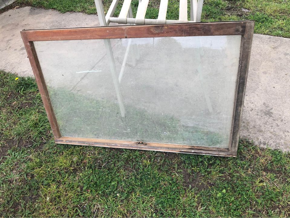

Do you think I could get away with putting a 2x8 in the middle with an aluminum framed window on each side, or sticking a 47.5 in. x 35.5 sliding vinyl window in there, or do you think I should just find a piece of glass to fit it?
I had seen this 4' x 3' window on facebook marketplace a while back for $20.
