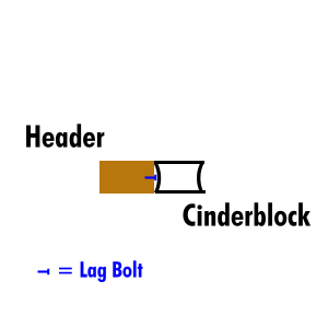

when you make the beam, Put for lag bolts on each end, sticking out where they will stuff the web in the block on each side, but not break it. Then mix a little mortar mix and drop it in that hole. It will bind the beam to the wall
Like this?

Yep, and run a bead of adhesive on top of blocks

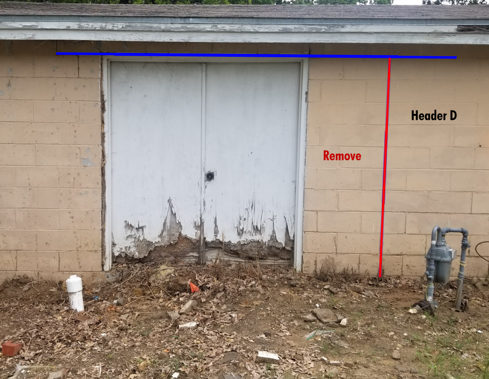

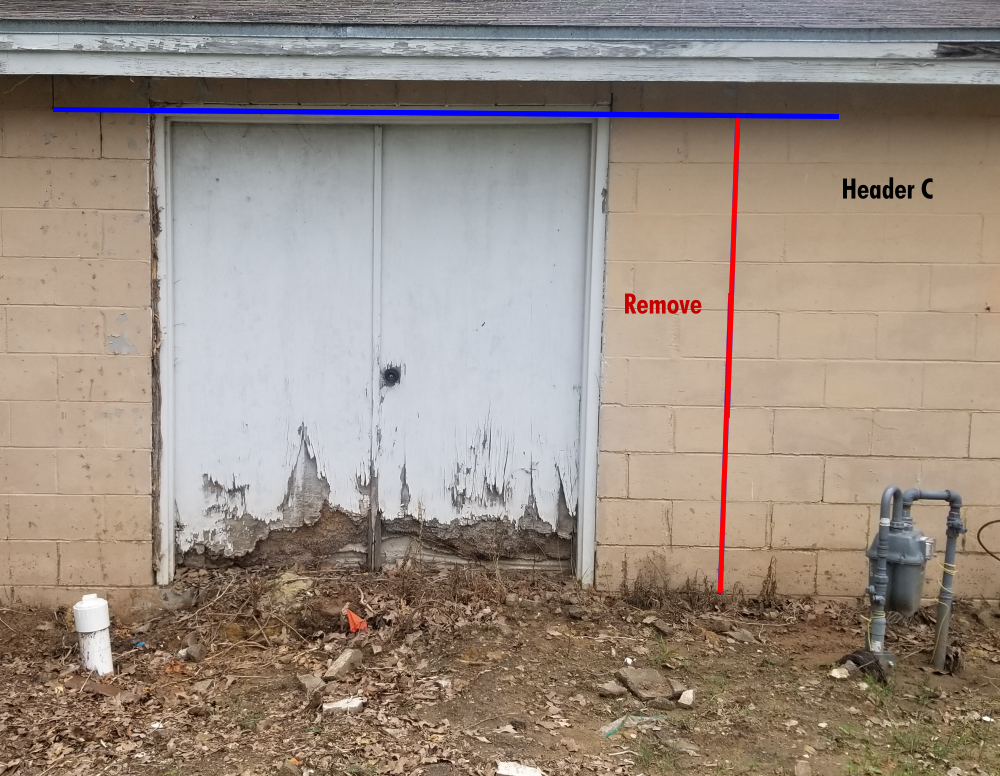

Your shop, but I would still go wider. I’d go 6 inches past the clean out, and 6 inches past the gas meter. Then I’d put posts up at the gas meter. And I would cut off the clean out and put in a flush cap with the ground.
when you case it in, it will be between the two.
And again, you’ve got the idea right now on the header. It just has to go across at least two blocks
And I just figured out why you don’t wanna reuse those doors. You sure you just can’t put a little caulk in the bottom?

Also, I had wondered if I could cut down the height of that cleanout, or if it had to be a certain height above the ground.

the cleanout can be flush with ground, i would actually recomend it place like 1/8" below finish grade. be sure to seal threads teflon tape is fine, if high traffic area (like commercial use) get a traffic rated cleanout top, pricey but prevent future problems. another idea is place it about 2 inches below grade and install a irrigation valve box larger then cleanout over it to maintain access.

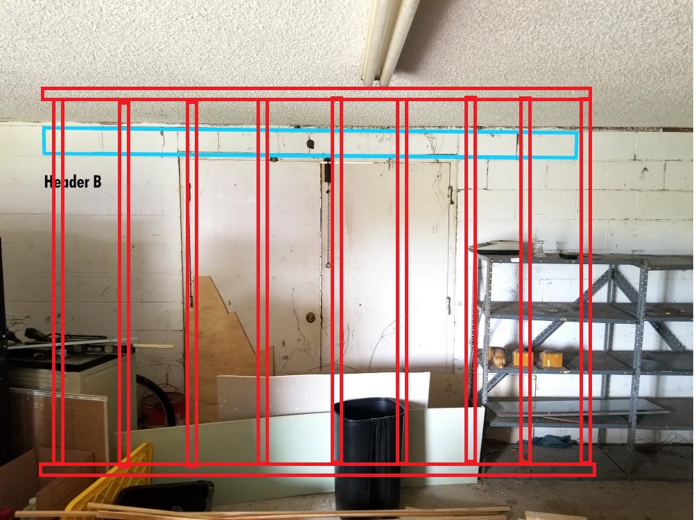

Temp support wall from ceiling to floor.
Temp support wall from ceiling to floor.View attachment 60482
@franklin2 is on track here, except that red wall should go a couple of joists past whatever you’re going to take out on each side.
The temp wall should have a double plate on top with offset steams at least two studs apart. If you do 16 inches on center on the studs, that’s best, and you can probably get away with 24 inches.
Measure the space between the white ceiling in the floor, and build your wall on the floor quarter inch taller. Put it in place at the top with a couple nails, and then drive the bottom so it goes vertical with a sledgehammer. Do you want to pre-loaded, you don’t want to settle when you pull the wall out.
you need to be sure if you put it under that white ceiling, that the white ceiling will hold a load, and you don’t just crush the white ceiling.
@2drxploder is right that the cleanout can be cut really anywhere you want it. If you’re going to pour a concrete apron up to the door, I would make it a hair lower than the concrete so that there is no pressure on the pipe if you drive over it. Also, the cap on it now opens with that square knob sticking up. They make a cab that has a recessed square that you open with a half inch socket or such, so it’s flush with the surface.
Also, keep in mind that the drain pipe is vented and it drains. If a little rain water gets in, or a little vapor gets out while you’re figuring it out, it’s not the end of the world. So the cap really doesn’t have to be airtight. If you have any doubt about the height you want, just leave it a little bit long and put the female adapter on without glue. Then when you figure out where you want it, you can just pull the female adapter off, cut the pipe, and then put it where you want it.
And you seem sold on the sliding door, and if that’s what you want, God bless you. If you have the slightest doubt, call around some of the overhead door people and the steel door people, the commercial suppliers not Home Depot, and see if they got any scratch and dent or used that they will sell cheap. If it was my front door in my house I wouldn’t do that, but if I’m working on the back door of my shop which faces in AlAnd you seem sold on the sliding door, and if that’s what you want, God bless you. If you have the slightest doubt, call around some of the overhead door people and the steel door people, the commercial suppliers not Home Depot, and see if they got any scratch and dent or used that they will sell cheap. If it was my front door in my house I wouldn’t do that, but if I’m working on the back door of my shop which faces an alley....

Should the temp support wall be 2x6's of can they be 2x4's?

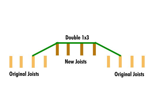

I don't understand this: "Once the joist modifications are done, on each end of the new horizontals, glue and screw a double one by three strap along the length. That strap has to extend at least two joists past the work. I would screw & glue one down, and Bow it/bend it to swoop down to attach to the original trusses. Then glue and screw the second strap on top of it, offsetting joints then you can use the two by fours from the temporary wall to make your angle braces along the Ridgeline." Are you saying to do this:
60494
I feel like the double 1.3 is going to snap. I know the original joists have a 2x6 running cross ways over them down the length of the building to keep the ceiling joists from twisting. Just wondering if this serves the same effect and how and why I need to drop it to the lower joists.
2x4 should be fine on 16” centers. Double plate with offset seams on top, and single plate on the bottom. If there’s a seam on the bottom, just center it between two studs and screw a 14 inch splice on top. The top needs the double strap to hold the weight, the bottom needs a single strap just to keep the two by fours from going Squirrley
Your sketch is correct except it should be attached to at least two joists on either end, whether it’s the first and second, or it’s the second and third. The purpose of the strap is to keep the bottom of the triangles even, and also to prevent the bottom of the triangles from twisting. I’m sure they used a 2 x 6 in the original structure because they are rafters and not trusses, but it’s overkill.
I understand what you’re saying about the one by threes breaking. As an alternative, you can cut 3 inch wide strips of 8 foot 3/8 plywood (always plywood not waferboard). Let it soak in water before you put it up, you shouldn’t have any trouble bowing it the way I described. It has to be glued and screwed to every modified joist, you can skip a joist if you have to when you’re bowing it down, but it has to be attached two joists on either side.
Still do a double layer with the joints offset by 4ft, and use Elmers waterproof wood glue generously instead of the construction adhesive. This will set up as the strips dry out.
