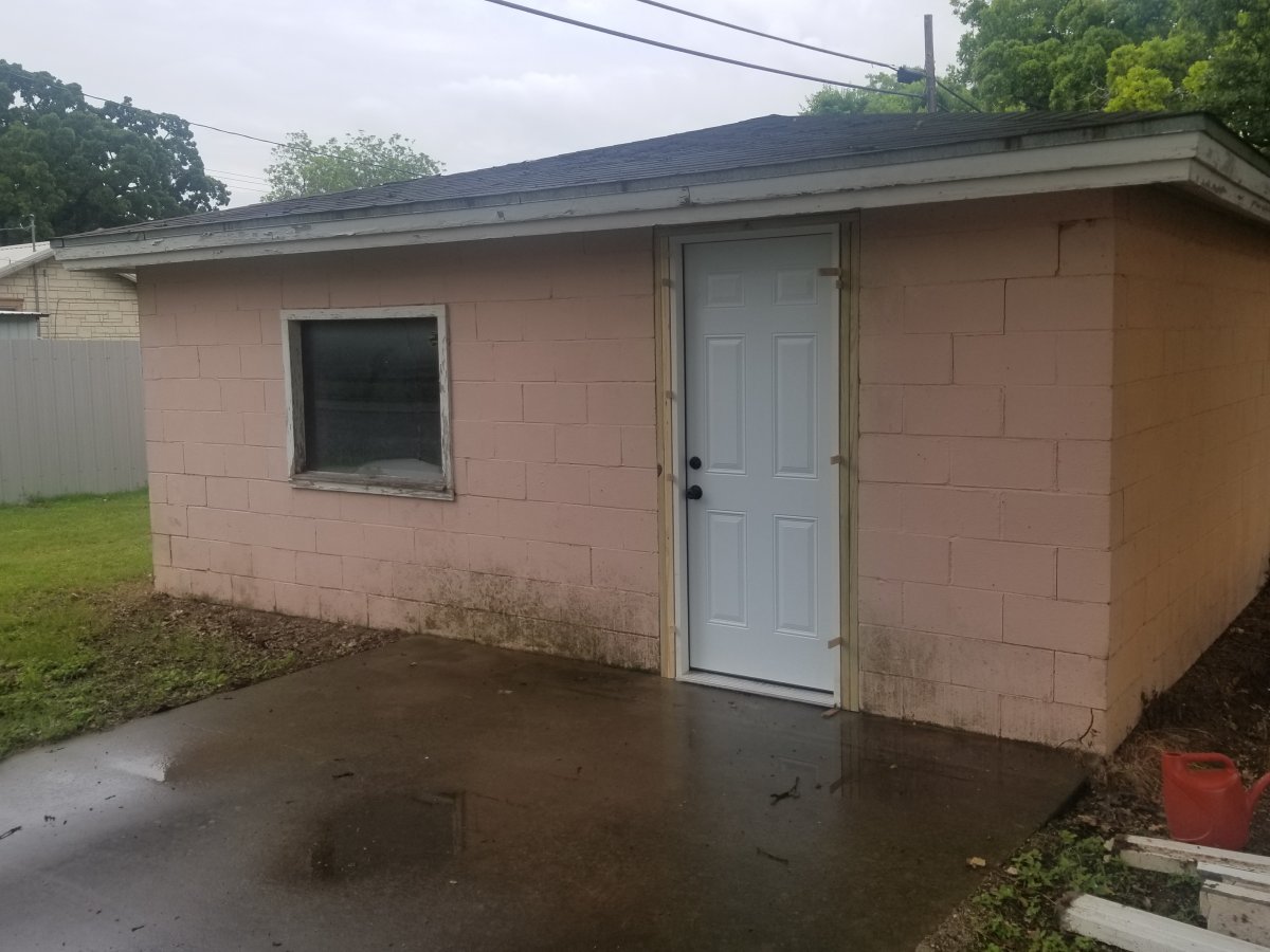

I got my new front door hung. There wasn't enough room in the opening for a 36" door, so I framed it down to 32" and got a prehung metal door from Home Depot for $166. I still have to cut off the shims and trim it.

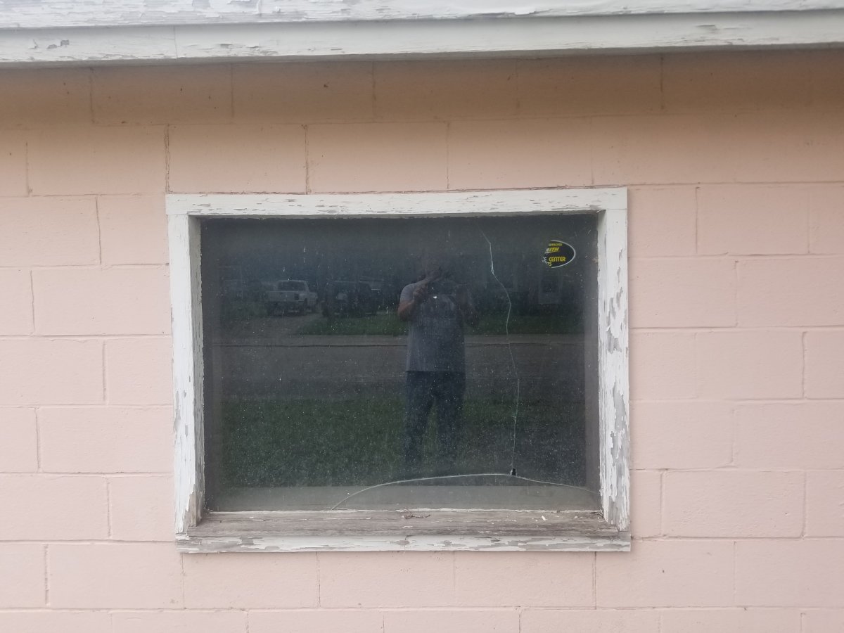

This front window is broke. You can see a crack going down and intersecting with a crack going across. First I figured something broke it, but now I'm wondering if it was force from the building itself.

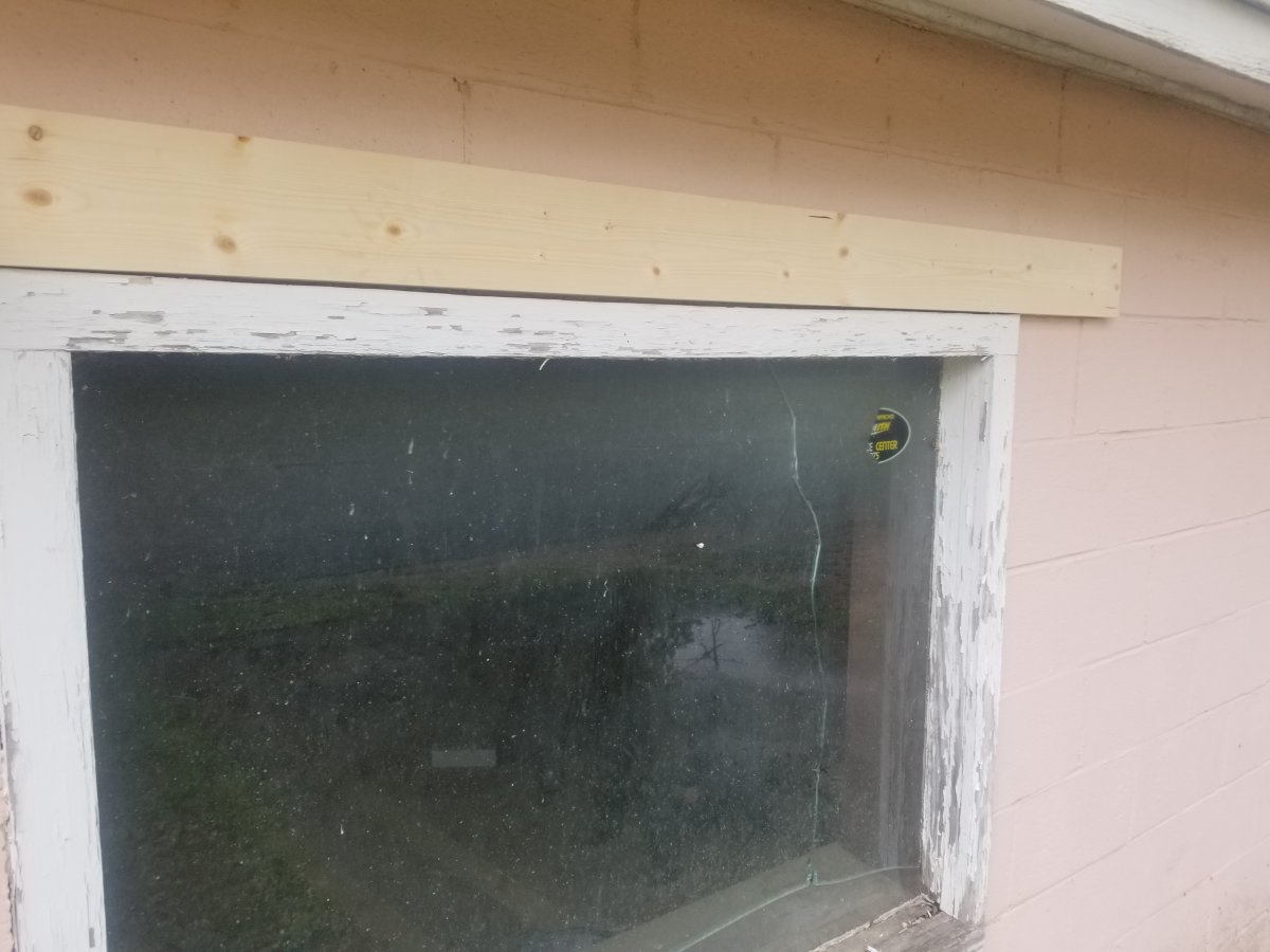

I laid a board across the top to see how it dips.

The wood around it is rotted in areas.
The opening looks to be roughly 52" x 40". I'm thinking about framing it with 2x8 with (2) 2x8's in the center of it and dividing it in to (2) windows. I can go to Home Depot and get (2) 23x35 windows in stock.

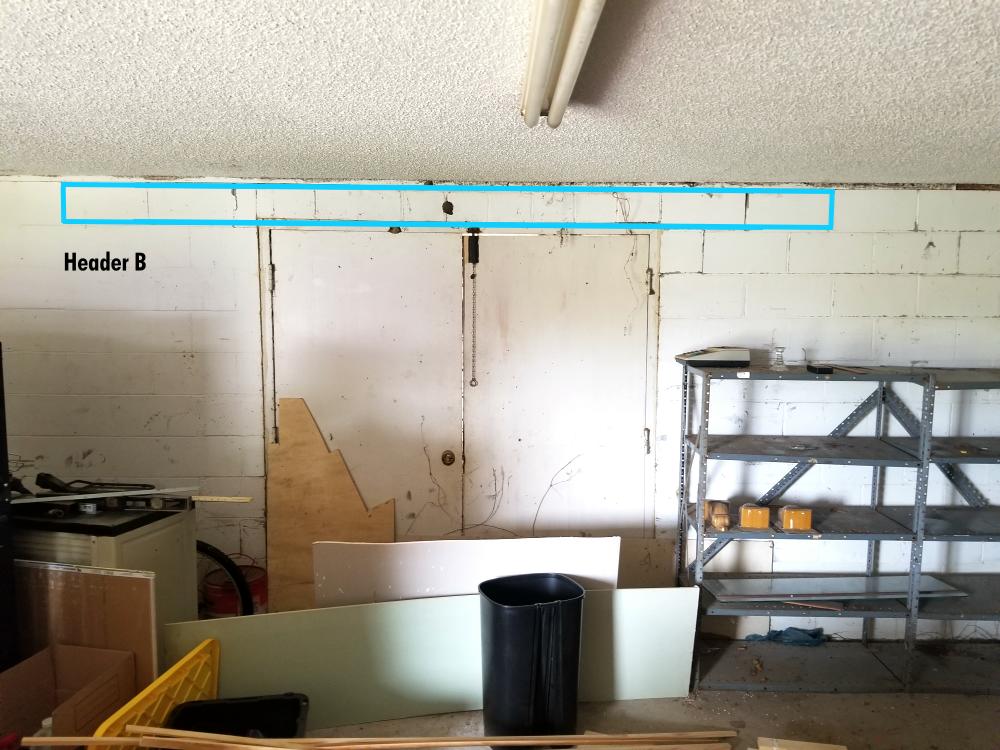

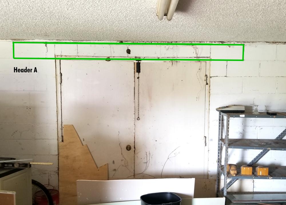

Ok @Rick W will Header A work, or do I have to go with Header B?

Header A should be fine. When I make headers, I use two 2x's with plywood sandwiched between them. The plywood does a lot to prevent sagging.
Ditto Eric. Header A should be fine. But I would pull out and reset that loose block on the right.
