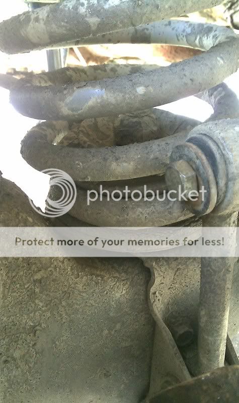

You may or may not have to do this. I am only person I know that has had a problem. On the bottom of the coil, you are going to use a floor plate, then XJ pad, then coil, then D35 curved washer, then nut. My coils didn't have a small enough diameter to stay on with the D35 washer. I went wheeling once and it popped off twice and ended up resting on the ball joint. Not good. So I went and bought a set of one size smaller floor plates and put them in upside down under the washer.
It may be hard to see in this pic. If you need a better explanation, let me know.
i kinda understand what you mean. i'll play with it when i go to do the swap and if i need i'll ask more questions.
