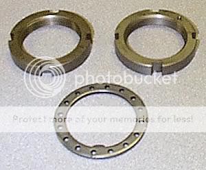

If the nuts are the same for all those axles then finding them shouldnt be to hard to find. If they were limited to just the TTB D35 then you could be a bit screwed (no puns intended).
Yeah they are dime a dozen. Well more correctly about $8 a pair.
yeah i can get those cheap-ish, even at ford.. i asked about them today while there.

These:
My Bronco 2
They are the same for D35 TTB, D44TTB and SA D44's

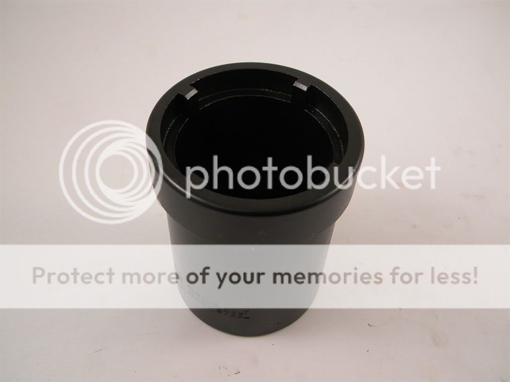

To get the on/off you will need one of these, any parts store will have one:
My Bronco 2
I need one of those sockets! Does vatozone carry em'?
mine does yeah
