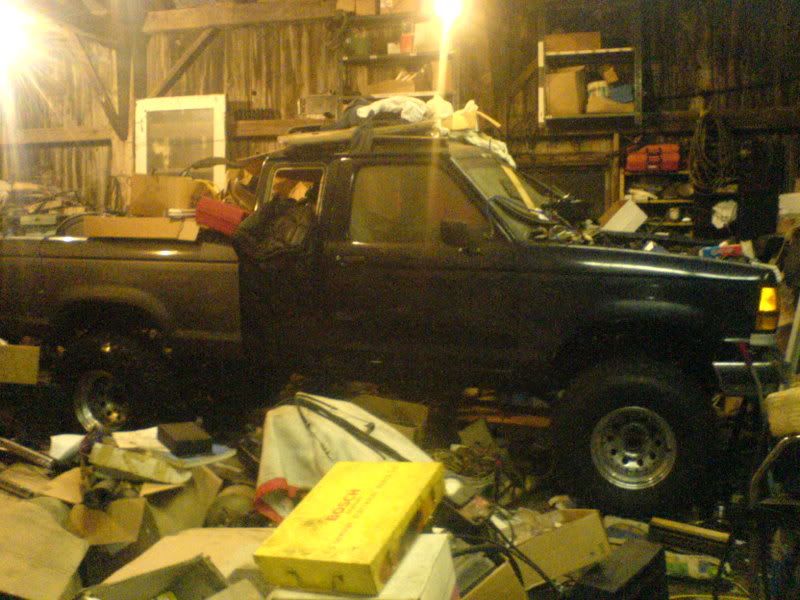

I wouldn't even be able to touch the truck until I got that shop clean... I'm real OCD on that. lol it's bugging me sitting here!
Awesome build!
Yea it really gets to bug me too. But its not my shop to say how things should be. And I get to use it for free. I just freak out when things go missing or my stuff gets broken, like my cutting torch :pissedoff:.
The upside to some junk being around the truck is that its easier to get under the hood when you have a chevette engine to stand on. haha.

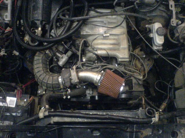

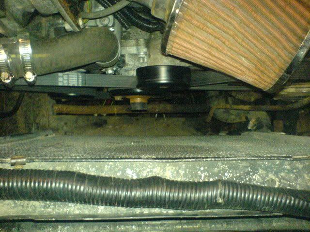

All i did today was remount the battery tray. But slightly different from stock. I mounted it lower and more forward to clear the alternator. So today was the first time i could work and listen to the radio from the truck. Then i started to wrap the wires with self amalgamating tape to seal the wire harness then with the plastic protection stuff, and finally sealed with electrical tape. There shouldn't be any problems with the harness down the road.

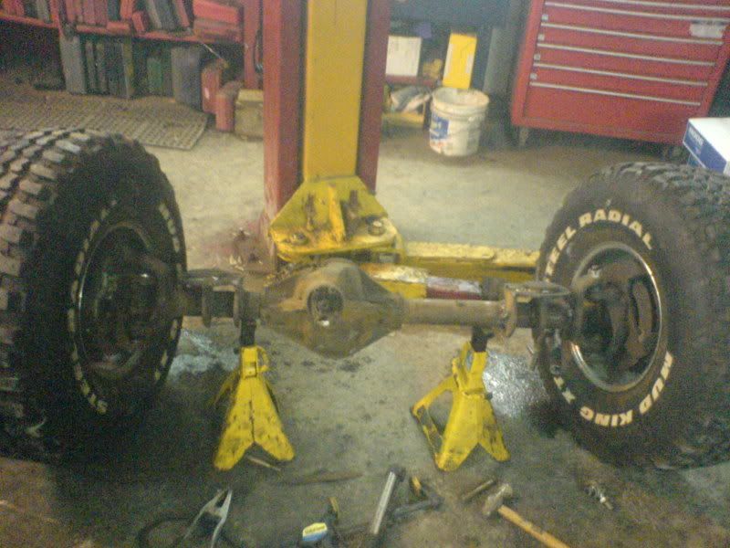

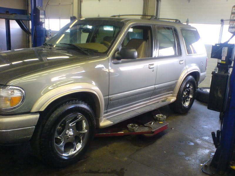

Started on the rear axle FINALLY! haha. The first time i tried to start on it i had a huge headache with 1 lugnut. It was one of those chrome cap styles, so obviously it corroded and bulged, so i hammer on the 19mm socket, then the cap spins off and i hammer on an 18, it spins, then i hammer on a 17. Somehow that ends up spinning! So i magically hammer on a 16!!! and then the top of the lug nut breaks!!
So i got fed up and left it alone till a nice day like today came around, had to tear into it find out that its a limited slip diff :D(BONUS!) then smash one of the drums into 15 pieces to get it off. then take the axle shaft out, then smash the wheel into the axle with a seized drum take the C clip out. Then smash the wheel off with the axle shaft attached grind the head off of the stud and pound it and the half a lug nut off.

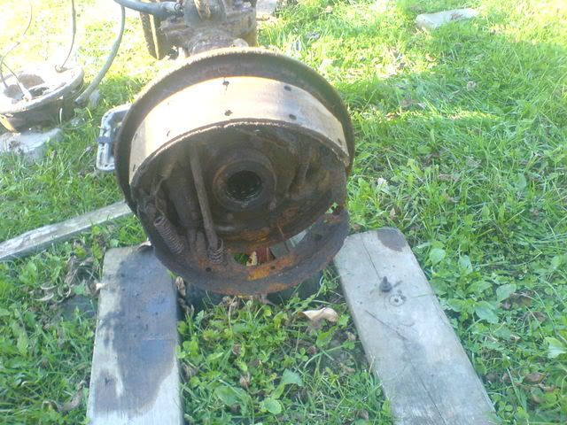

I took the brake shoe assembly and backing plate off the explorer axle, and put on the assembly from the f150. Since im going to have the 5.5 bolt pattern i might as well have the drums and brakes to go with it. Makes everything look nice and normal looking.
My backyard build (56K warning)
The explorer origonal setup.
Removed from the f-150 axle.
Compared
installed on one side
Compared again

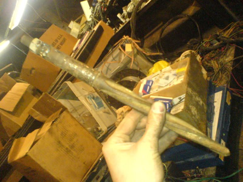

Hopefully this week i will get time to bring the f-150 shafts in to be resized. Im going to give True Gear another chance to see if they can get something right. Seeings how they are the only place i am able to find that can do it.

dropped off the axle shafts today. everything will hopefully be ready to roll next weekend. If all goes well.
Ok, axle shafts are going slow as hell! AGAIN! damn these guys take a long ass time! But unfortunately its the only place within a reasonable drive that can do it. :( oh well.

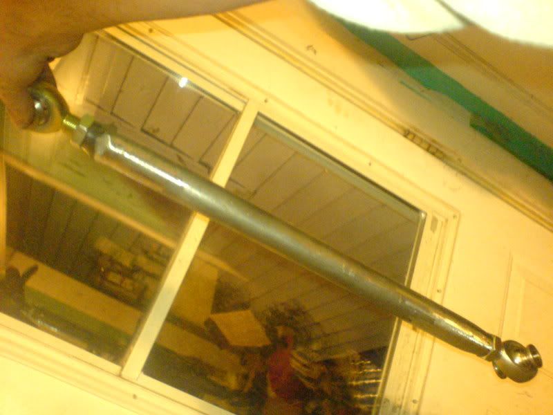

I made the upper links. Used 3/4 hiems from bicknell racing products and misalignment adapters from ballistic. Got the hiems, DOM tube, jam nuts and weld in slugs from bicknell.

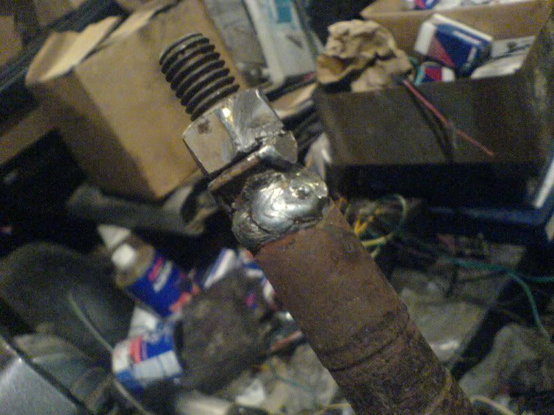

Then i decided to ream out the passengers side tie rod to accept a ranger outter tie rod end which will become the end of the drag link. I didn't want to ream it out because i wanted everything to be serviceable without modification. But this was easier. So i found a reamer that looked 60 years old in the shop and hadn't been used in 30 years. And i made it work! Its designed for an industrial drill press. but i needed it to work in a hand drill.
So i welded a bolt to the end of it and put a nut on that bolt and tack welded those together so i could use it in the inpact gun, seeings how that all i could find that wasn't broken.
Worked out nicely. Got the tie rod in there nicely. i also ordered up 2 more 1985 4x4 chevy tierods. so i can cut the ends off to use the threaded ends to make a centre link between the outters. Cheaper than tryin to find a 7/8 - 14 R & L thread bolt or threaded. tie rods were $12 a piece.

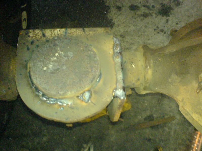

Welded the axle brackets on solid tonight. Tried to arc weld them, but i tried it while the axle was under the truck and it was pissing me off and i had ALOT of trouble gettin it to start. So i said F*** it! Brought it to my buddys shop and used his heavy duty mig welder.
Now i have a few more brackets for the axle to make but before i could i had to get these ones welded up solid. Now i can get the upper links brackets made up, and the trac bar bracket welded up.
Im getting very frustrated with my rear axle shafts tho! They "SHOULD" be ready for thursday, but im not going to hold my breath. If they aren't ready, I'll Just order up some custom moser axles for $175 each.
axle shafts are back! going to get them in on thursday!!! YAY!

Axle shafts are in. Worked out GREAT! everything fits nicely. I will take pictures soon. I ran into a little trouble tho. The axle tubes on the explorer axle are a larger diameter than the ranger. So i had to get new U-bolts for the explorer axle tube diameter(3.25").
Then i found that the spring perches i got have a locating pin hole diameter thats a little too small. i need to drill it out to fit. But the drum fits as it should and clears the backing plate, which was the only concern that i had.

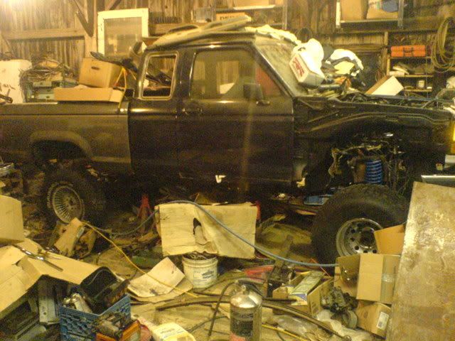

nice weather is here now. So its time to get my ass out to work on my ranger again. Since last time, not alot of change.
Ive gotten the factory 4x4 lift blocks and installed had to get custom made u-bolts that were 11 inches long, the 4x4 trans cross member,(i accedently scrapped the last one with the parts truck, oops!) the front driveshaft is installed, the steering has started to come together with the center link fabricated and installed and the rest to come soon. The trac bar and torsional links are also now in and the axle stands have been removed from the truck.

The links are not tight and are twisted right now, thats not how they will sit in the end, its just how it is now.
