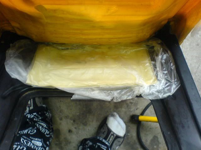

I stopped by Fabricland and got some Dylon black fabric dye and went to town on the passengers side seat. Took the seat cover off of the frame and laid it out. Mixed the stuff as directed and used a cloth to rub it into the seat, went over it untill i ran out of mix. Then rinsed the cover untill the water staied clear, well mostfully clear. Enough that i would be confortable wearing a white shirt while sitting in the seat.
Hard to tell that its been dyed, but it looks darker that the picture. It is still kind of grey, but all I was looking for was something that would be dark to match the rest of the black interior.

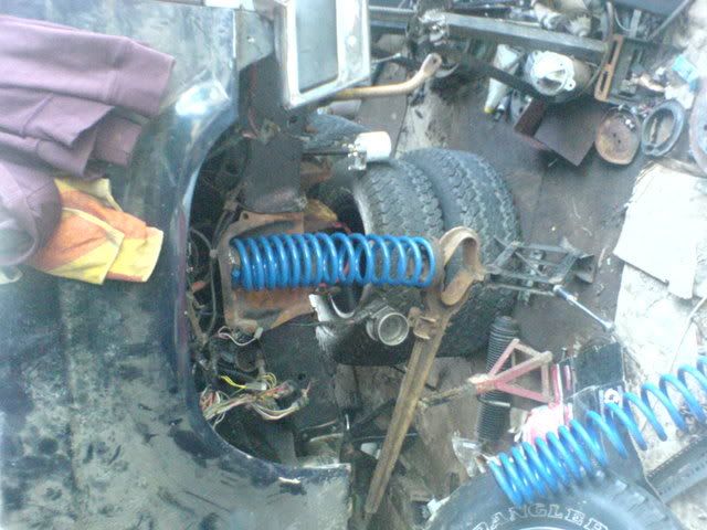

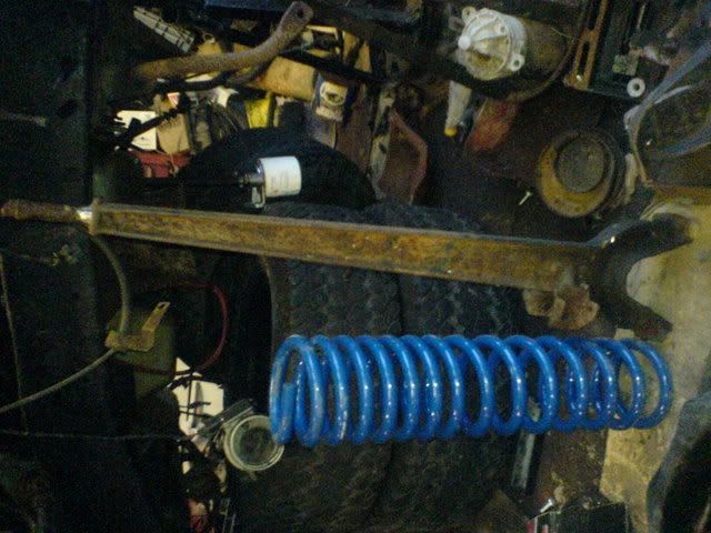

New springs compared to the origonal '77 radius arm
New spring compared to the old ranger springs

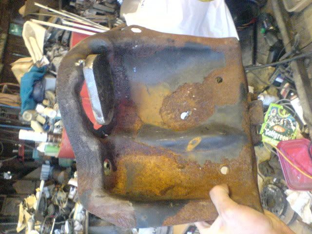

My modified spring tower, the "D" shape is the spring retainer, there will also be a piece that clamps it into the tower.

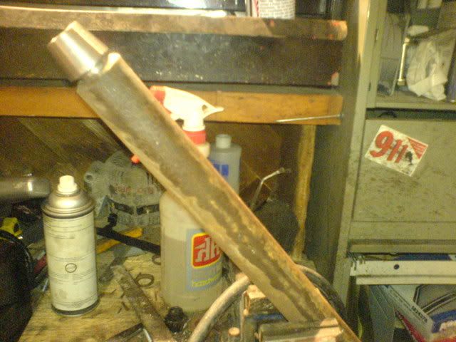

Shortened axle shaft. This was the biggest bullshit ever! sent it out 4 times because they kept screwing it up! Ended with them pissing me off and taking it to my friend who had a lathe.

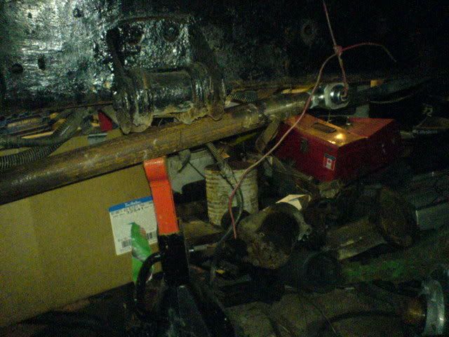

Axle under the truck...
The end of the link that I made.
