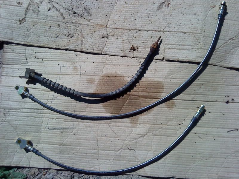

Rear brakes went nice and smoothly. New shoes, spring kit, wheel cylinders, and drums. Yesterday i went down to have some braided stainless lines made up. Those were finished today. I had the rear extended 13 inches and the front line i had made to be 25 inches total. I only had the end bit still bolted to the axle, so i had to guess at what i needed. $110 out the door for those.

Finished the brake lines. had to use a shitty ass flaring tool set. some of the connections leak a little. but i will deal with that when i get my good flaring tool fixed. Ran the trans cooler lines, mounted the cooler. tested the brakes by jacking up a front wheel holding the pedal on and trying to turn the wheel, felt good to me.

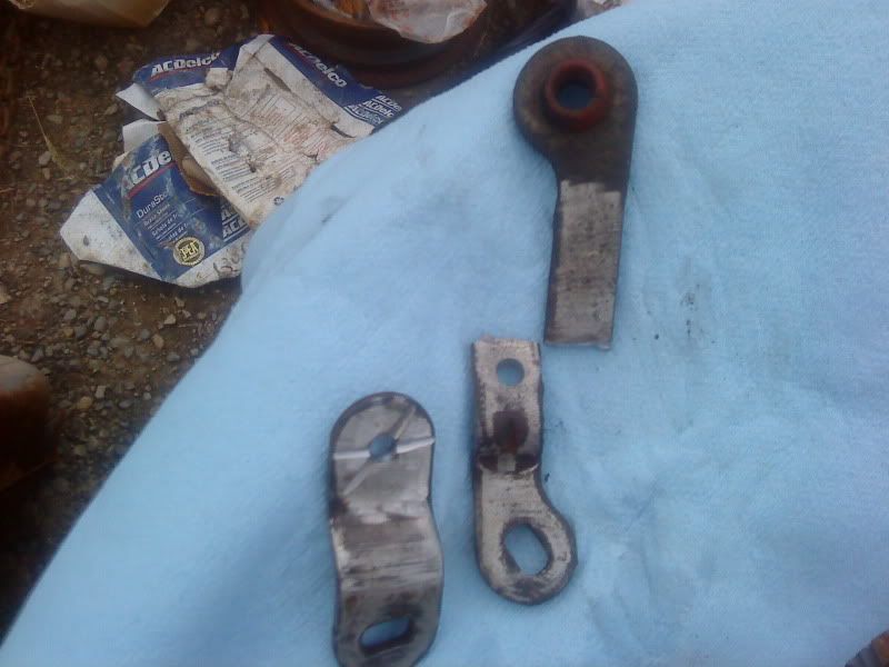

No new headers yet. Brakes done, steering done. Altho the steering box may need to be replaced, very sticky/ stiff turning left. Thottle cable done. kickdown cable lever and bracket fabricated, but may need tweeking, cable adjuster isn't working. I got the crap cleaned off the roof, and the windshield area, 80% of the crap in the back is cleaned out.

pics of the kick down lever i made up compared to the origonal
