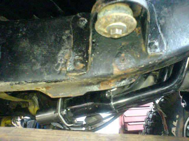

I've posted these in other threads on the site, but they belong in here with the rest of my build so here are my shots of the transmission installed, and the headers installed.
There are a few clearance issues with the headers to the transmission, and headers to the front axle.

Im really not impressed with the James duff headers. Definitly not suggested!

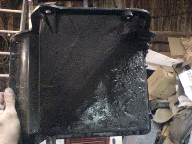

Finished the heat/ac box didn't like the thought of using sheet metal or duct work to modify the box to work. So i used cheese cloth and fibreglass. But i was in a hurry to just get it the hell done so i didn't bother to make it 100% smooth. I took out the high spots and made it more than good enough for what i want.
