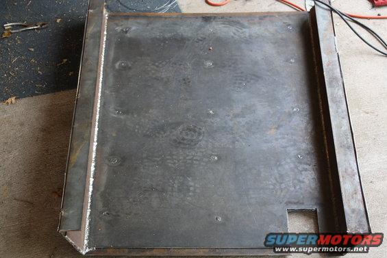

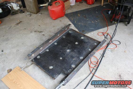

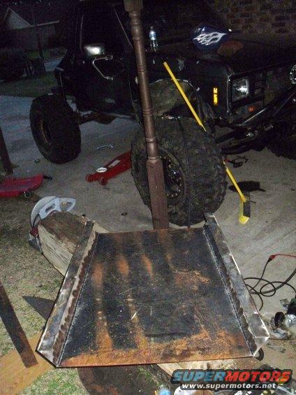

started working on a skid plate today, still alot more too do
Plate it, drill holes, clearance way for front d-shaft, front and rear lips, t-case mount.

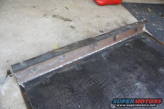

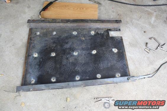

this is just the basic skin of it really:

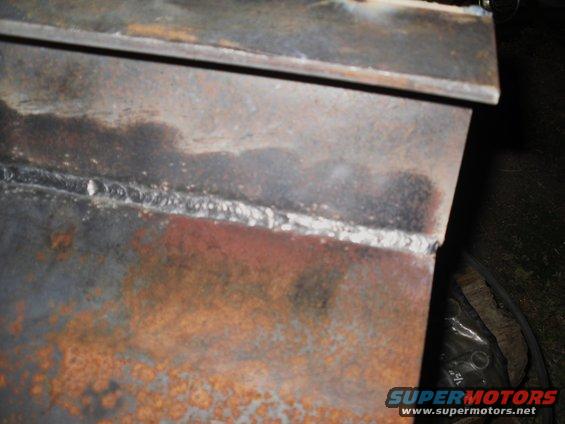

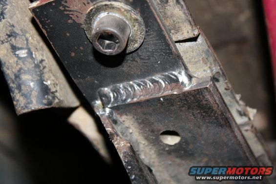

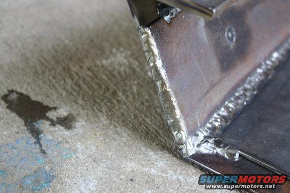

Didnt want to waste my solid wire and gas beings this is going to be alot of welding, so I put some flux in there. Any of the welds that will be visible, which should only be 2, I will mig.

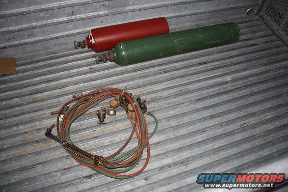

I'll start the updates today by showing this...
my B2
bottles, victor head and regulators and 20ft hose, bottles are full too.
Paid - $200

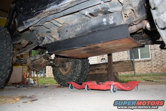

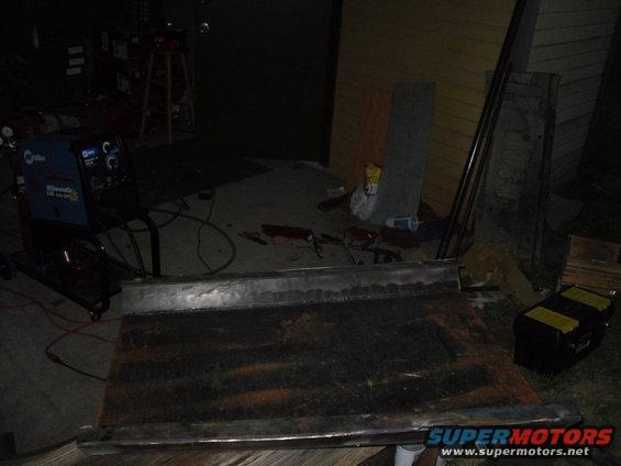

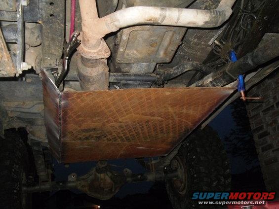

Now for the updates, almost finished the skid.
First, before anyone asks why I didnt just use 1/4" to start with. I bought a sheet of 1/8" to build the bed, and I had nothing else for it, and enough to double plate building a skid. Saved me over $200.

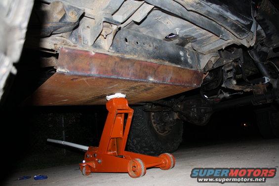

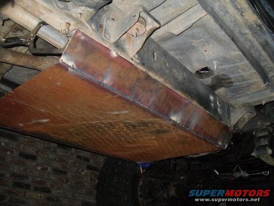

been awhile since I updated. Just got back in town. My wife and I went to Ft. Hood to go visit our friends.

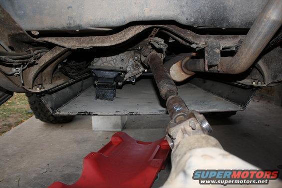

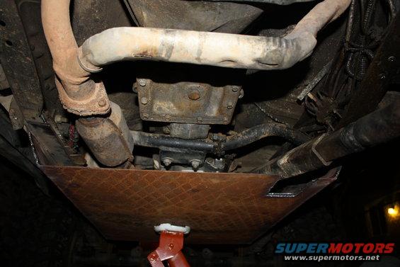

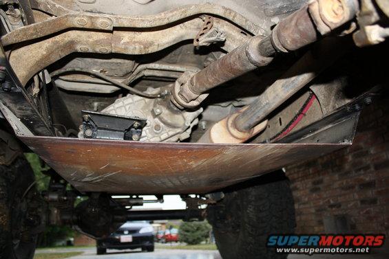

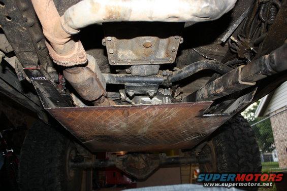

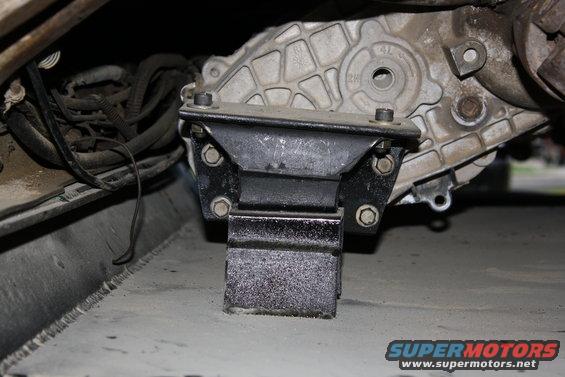

here are some pics of the finished skid plate and t-case mount, Minus more paint. I was able to test it out a little bit friday night and the t-case mount worked wonderfully. Skid ended up being just a tad too low, but oh well.
