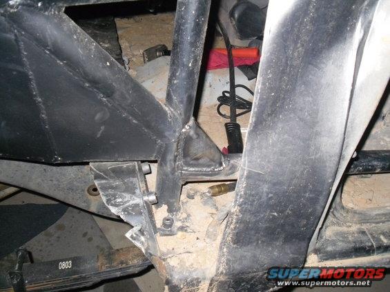

my B2
I figured I'd just mount it that way and let it be a 'self positioning' tab. It if bends, it'll be in the direction it needs to so it won't bend anymore :D
exactly my thought.

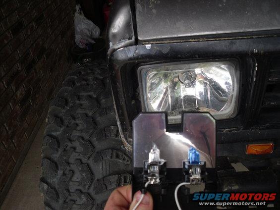

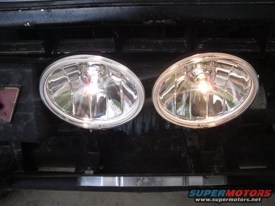

have a big order from ballistic and some stuff from A&A manufacturing im waiting on to start with the new x-member and skid plate and some other goodies. In he mean time.. I seen these so I picked it up.
Hella lights. Already ordered 110w 5900k's for them.

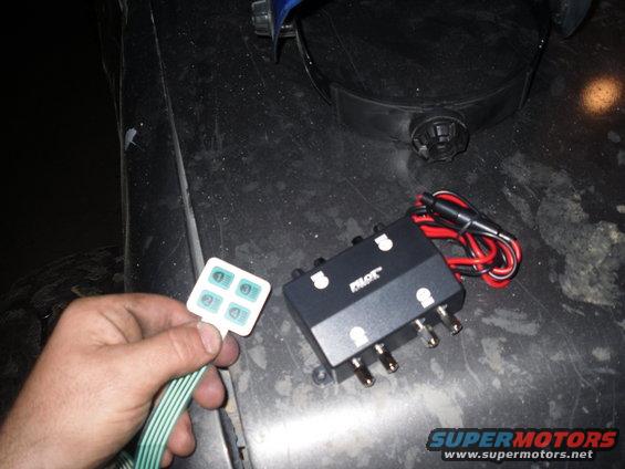

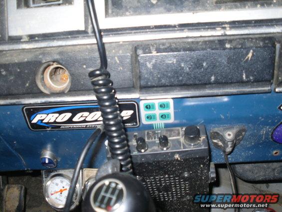

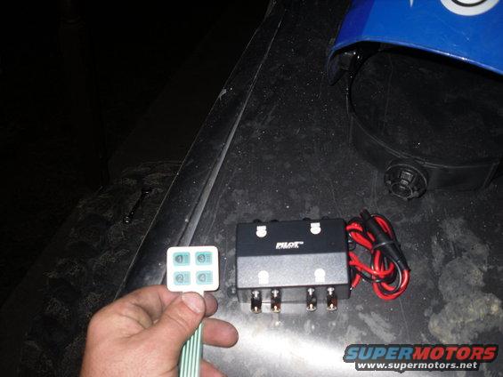

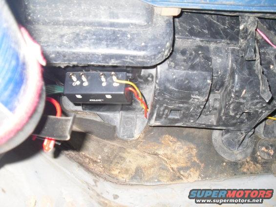

found this cool little switch at autozone for $25. Plan to hookup the hella's to it, rock lights, aux lights, and something else perhaps.
yea ive seen those switches...let me know how it works
wonder what kind of amperage it will hold
not sure on any amp draw specs. We'll see how it works out. Its a pretty trick little peice if it holds up.
Use a good relay for each circuit, and it shouldn't have to deal with too much voltage.

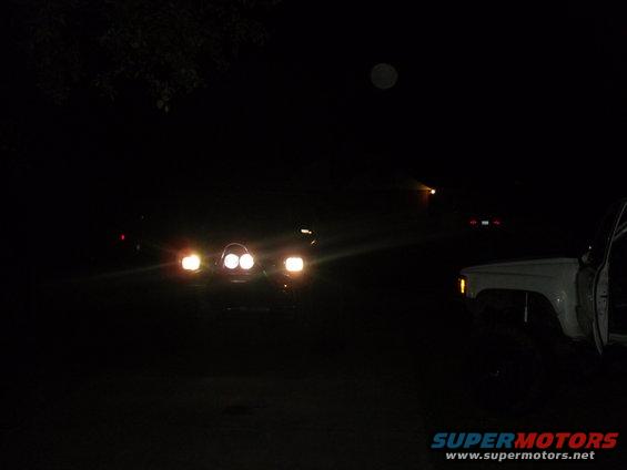

got new bulbs for em.
100watt 5900k

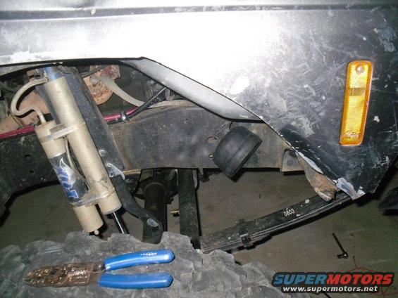

so you went full hydro with a single ended ram?
hows the steering response, Is it slower than a double ended ram?
technically its slower/weaker steering to the driver side. Not noticable though... it will still push the truck off of anything single handed on the wheel.

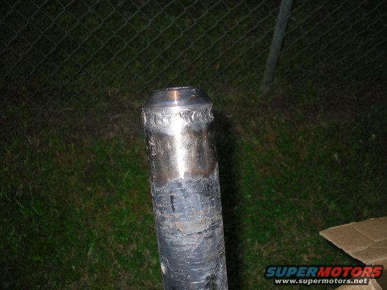

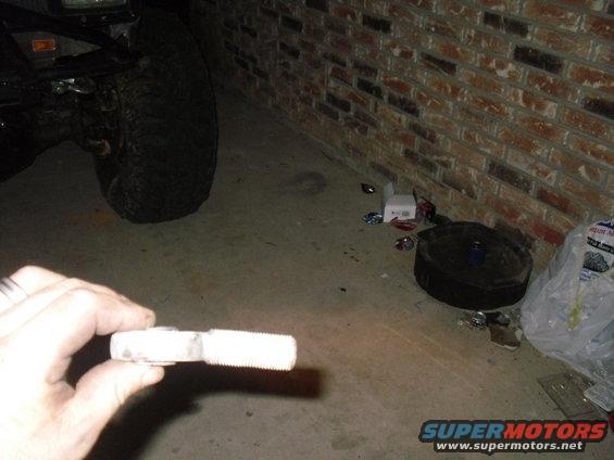

cut the old thread insert that was messed up out... and put in a new one.

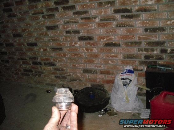

and one of the old Heim joints that I replaced on the ram

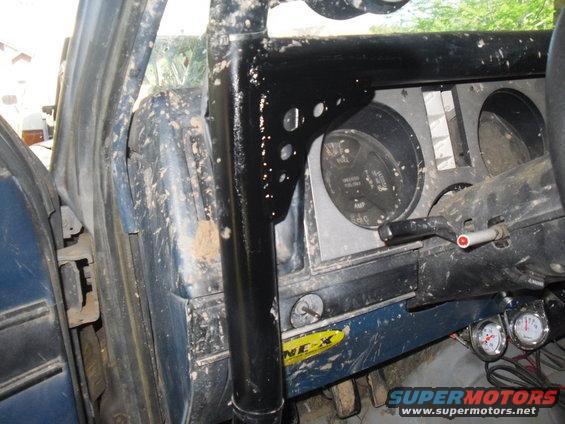

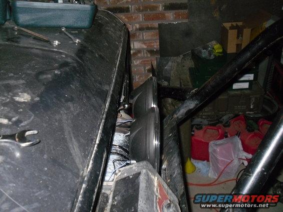

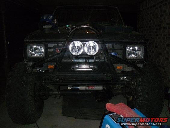

Put on some 4" TruckLite Aux. lights

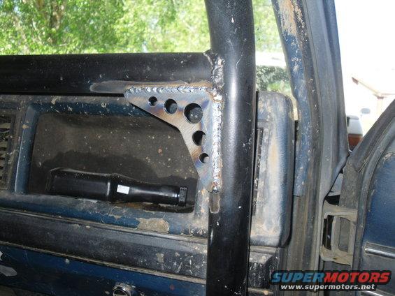

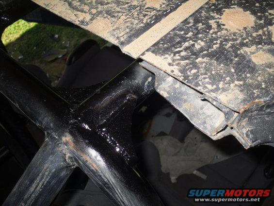

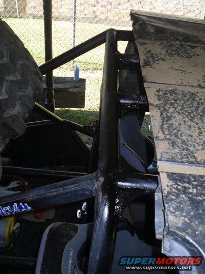

Saddle Gussets
