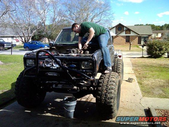

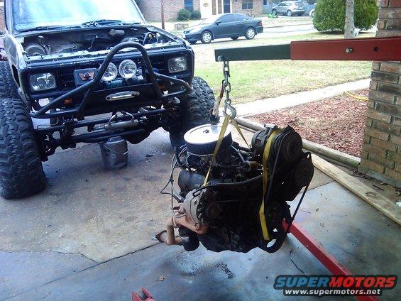

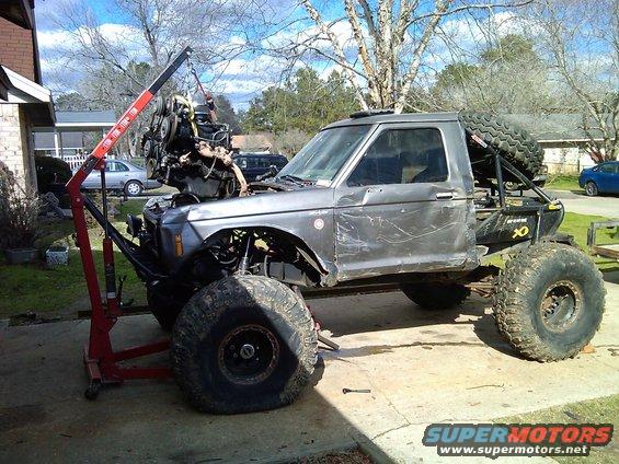

Some updates.... the B2 is getting a new heart:headbang:

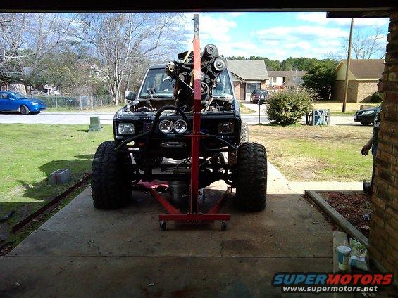

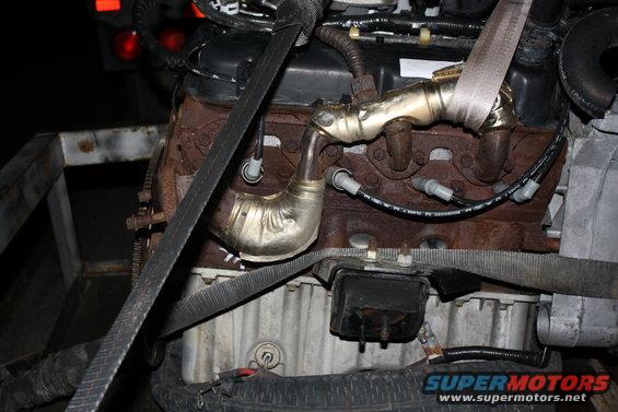

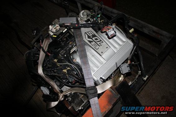

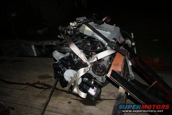

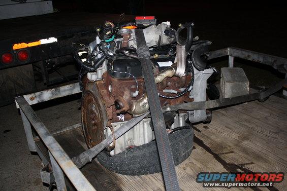

Got a wild hair up my ass and decided to 5.0 and C5 the B2. Motor is from a 98 Exploder, that means it has the GT40P cobra heads, and the cobra intake. Going to put headers on it and a new cam. C5 is getting a full manual reversed valve body with 1st gear engine brake, Art carr gated shifter, bigger pan and new TC. Plan to have this built started pretty soon.

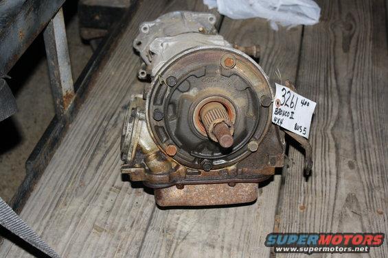

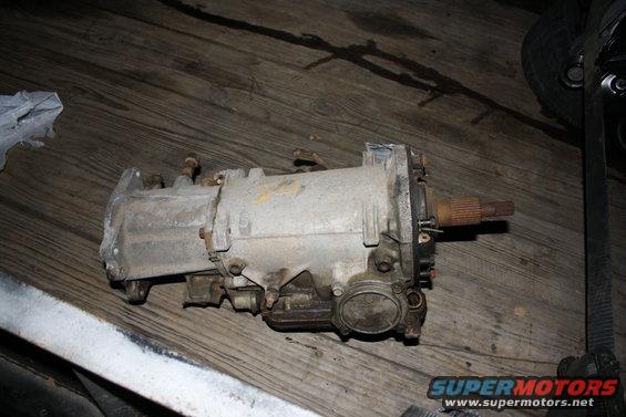

I paid $200 for the trans, has a 90 day warranty, guaranteed bench test.
All the parts I bought for it are 70+ C4. Forgot to mention that I got upgraded servo as well, from patc actually. Broader performance for the valve body and jegs for the TC. 1600rpm stall.

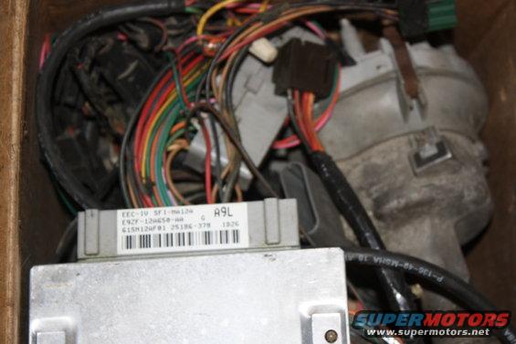

scraped the idea of running OBD2. Purchased an A9L ECU, harness and distributor from a 5.0 GT. changed to a 2200rpm stall converter, H code servo.
Only parts I still need is a new oil pan/pickup and shifter, which I will buy on my next paycheck.

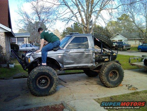

My helper, Adam

Had to air tires down to get enough clearance.

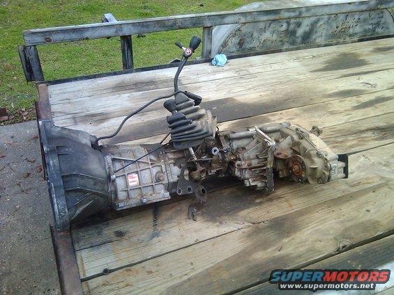

if u wasnt so far away id buy that 2.8 off of u if u was planing on selling it. cant wait to see some video of this thing after its done.
ya im selling the motor and trans.

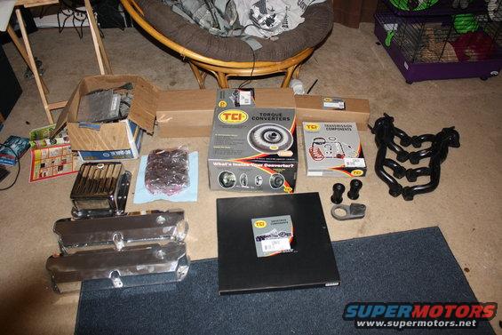

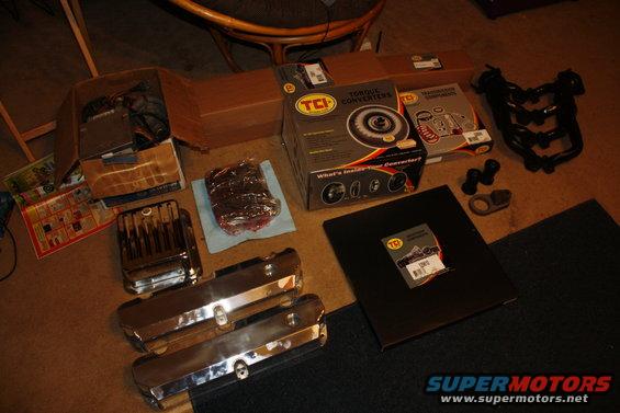

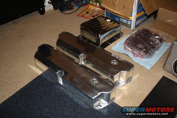

Here is what I have collected so far -

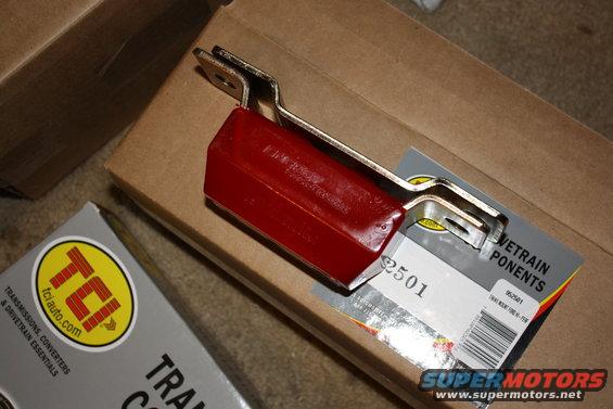

Still waiting on trans rebuild kit, Art-Carr RockGate shifter, Comp Cams camshaft/lifter set, throttle body spacer, intake spacer, hardened C4 input shaft, servo high-pressure seal kit, engine gasket set, and $130 worth of Amsoil to lube up all this junk.
Luckily, I have tracking numbers on all of it, and it looks like I will be getting everything this week. I plan to drop the trans off at the rebuilder on thursday or friday, and get the 5.0 built, and in over the weekend.:icon_bounceblue:
