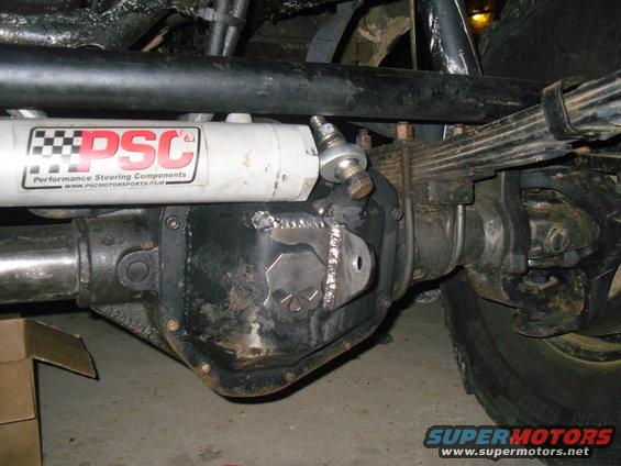

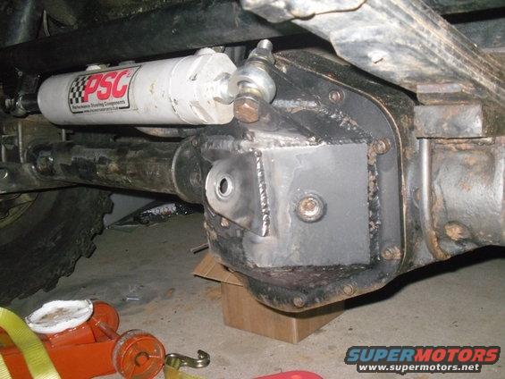

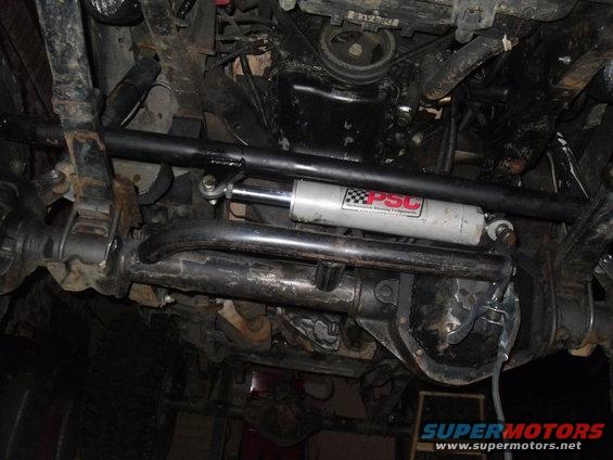

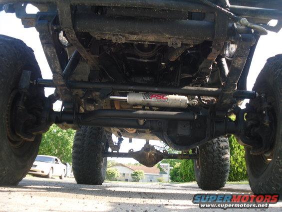

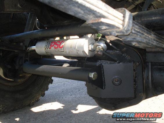

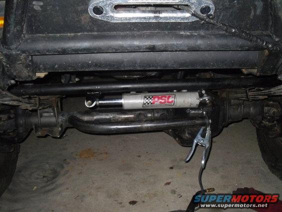

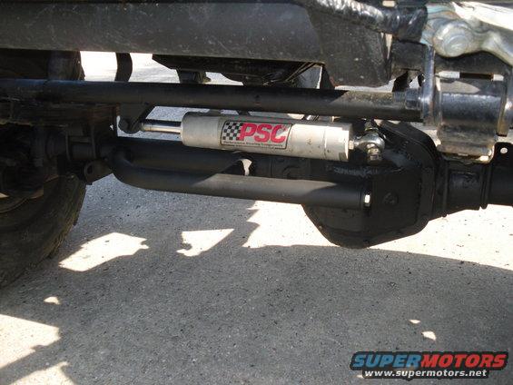

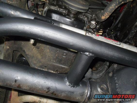

did a little bit of work today:icon_welder:
thats cool, I've never seen a hydro set up and protection done quite like that.
