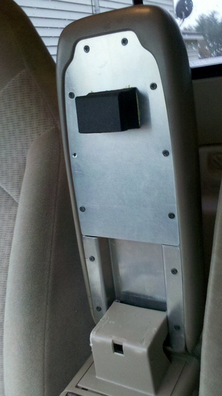

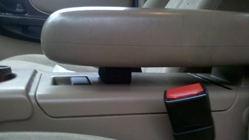

Here's my repair to the troublesome plastic armrest on the bucket seat config. There's a foam bumper attached to the underside of the armrest to provide a cushion. With this Hard dense foam on the underside I could probably stand on the thing and not worry about the screw holes breaking where the plate attaches. I found some of the screw holes had to be built up as they were broken too. If you buy the aftermarket replacement plate I would still recommend adding a bumper as it reduces the strain on the screw holes for the plate. Hope this helps some of ya's

looks good man :icon_thumby:
