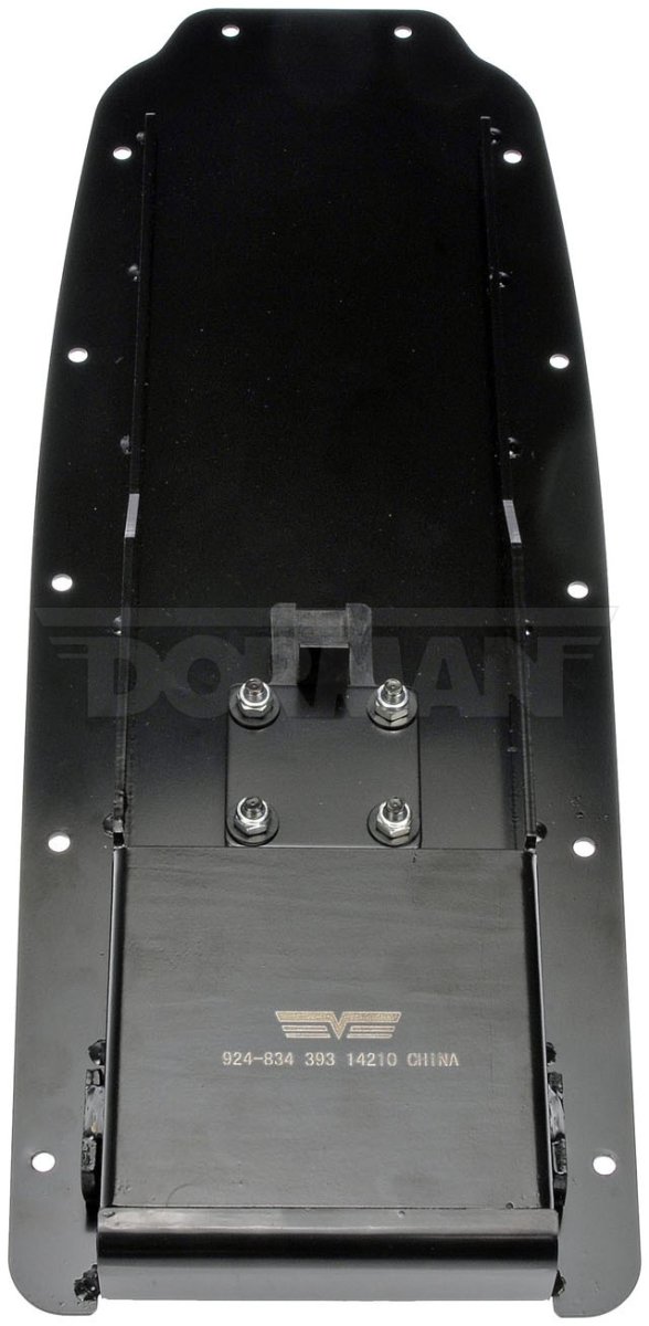

Luckily there is a relatively cheap, easily installable and reliable aftermarket solution. Dorman, an aftermarket parts company makes a solid replacement part that is completely metal.
Dorman 924-834 is the part number, and is a solid metal welded baseplate for your armrest. It also comes with all hardware, good instructions, and replaces the odd square pin with regular bolts.

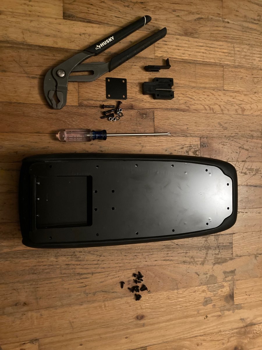

Items Required:
-Armrest with broken plastic base but good condition top
-Dorman 924-834 ($40-100$ depending on retailer, as of 2/25 Amazon is mid range at $55, AutoZone at $78)
-Standard Phillips Screwdriver
-Long 6mm allen key (Rounded ball head preferred)
-Standard wrench or pliers.

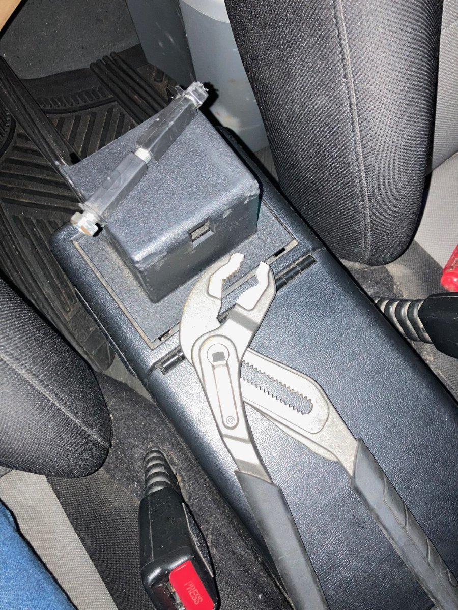

Step 1:
Remove the square pin from the current armrest bracket. Twist the plastic square to line up with the square notch, then grab the metal squared end and pull out. You may have to move your seat forward and/or press into the seat slightly. Pliers may be required if it's old and/or stubborn. No need for excessive force. Its a square hole with square nuts.

Remove the broken plastic base from your armrest, by removing the phillips screws.
Repairing a busted center console armrest 04'-11' Ranger
Notice that my 2 most rearward and closest to hinge screws, are completely broken. Fortunately because of how stiff the replacement is, and the bolted hinge design, this won't be an issue.
-Open the new Dorman kit, and install the new metal baseplate with the included screws. Don't hog down too hard on these, the armrest padding just has simple speednuts and dont need alot of torque.

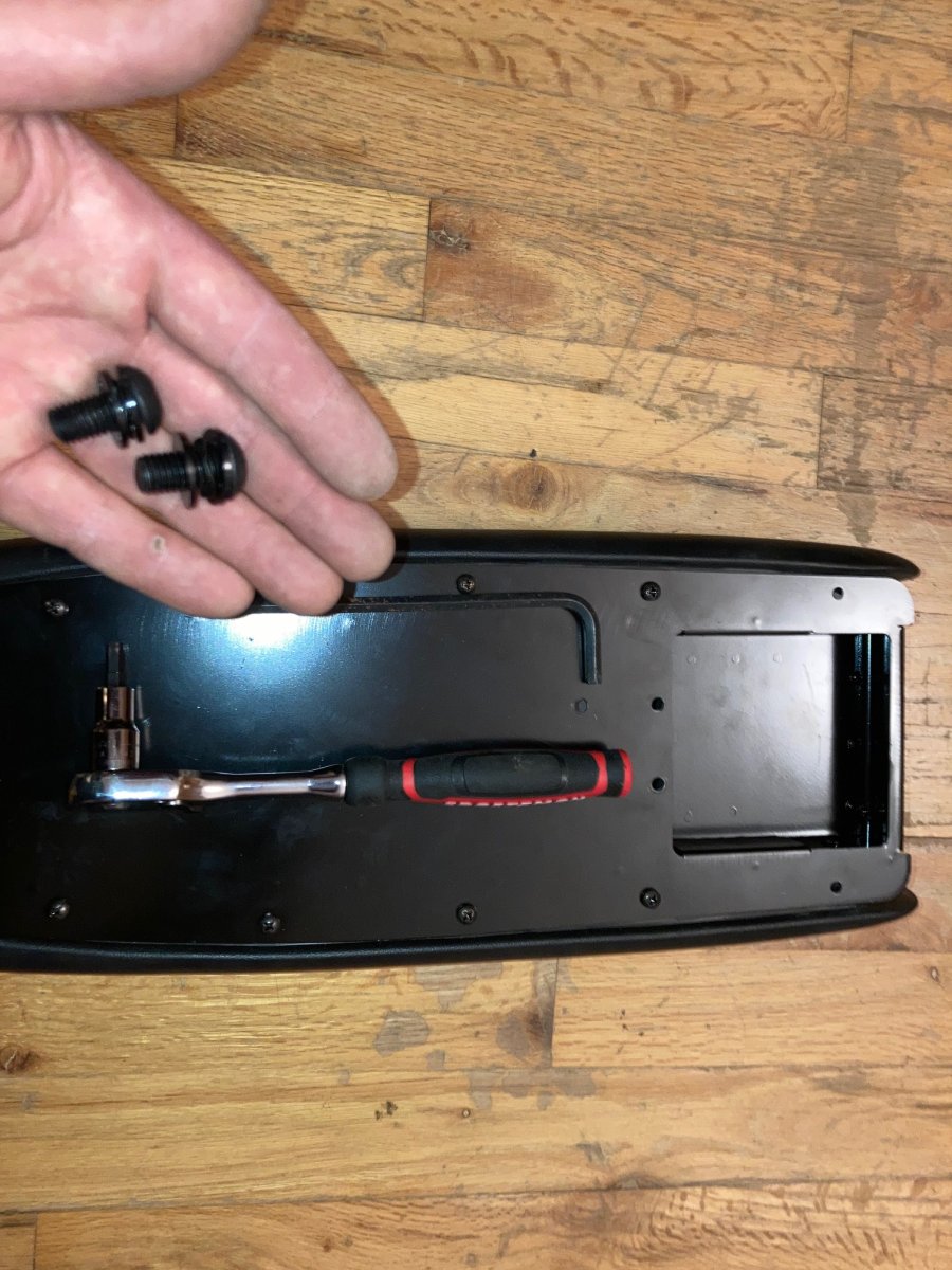

-Install the new baseplate and prep the mounting bolts. They come with hardware, x4 plastic washers and x2 metal spring washers. They screw through the plastic bushings into the new Dorman metal baseplate.
Be sure to stack the hardware as follows; Bolt -> Plastic Washer - Metal Spring Washer - Plastic Washer -

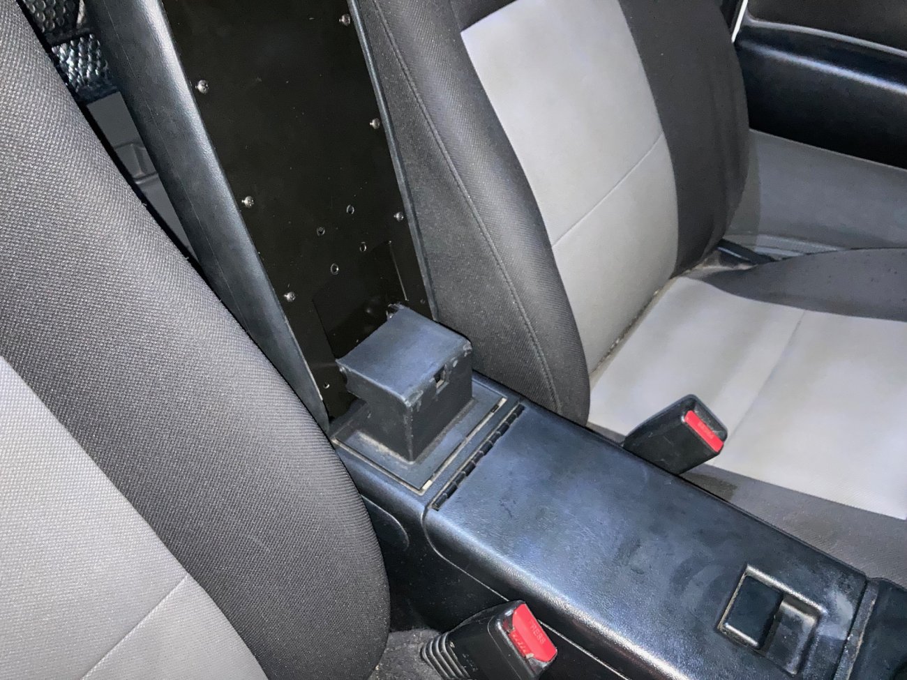

Step 3:
Install the new metal baseplate armrest onto the old bracket. If you're like me, you won't bother removing the bracket from the console. While it is easy to via 2 access ports, I didn't think it was necessary.
Here is where you definitely will hope you have a long handled 6mm allen, preferably with a rounded ball end. You press the armrest over the plastic bushings, then from the backseat, line up and install the bolts.
-Tighten the bolts down as desired for resistance. The plastic bushings and spring washers allow for some slip while snugging down. I preferred mine on the snugger side with some resistance of lifting/lowering armrest.
It's a tight fit down here. Certainly easier to remove the bracket if desired, but luckily I had a long handled allen and while not comfortable, was easy enough. A mini-ratchet could work with 6mm bit, doesn't need cranking down.
