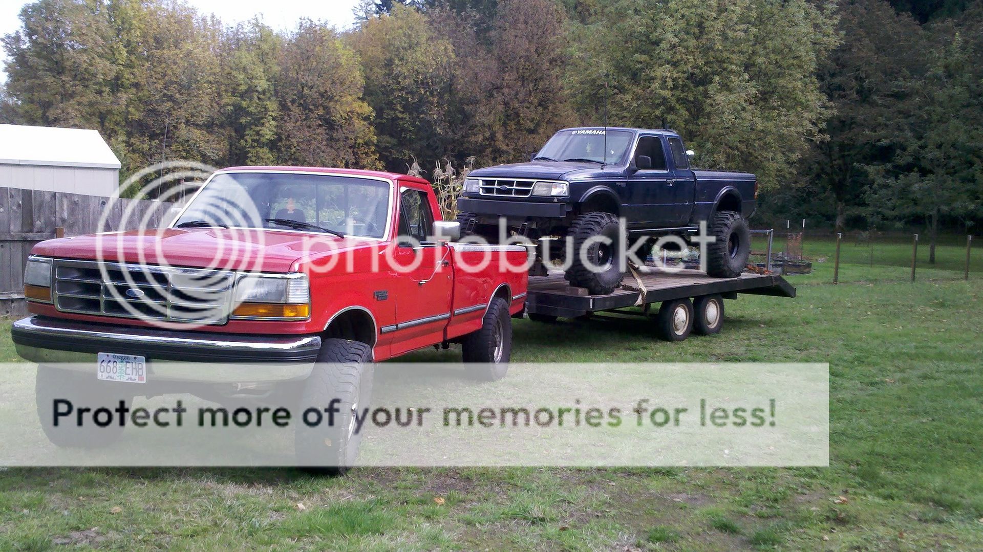

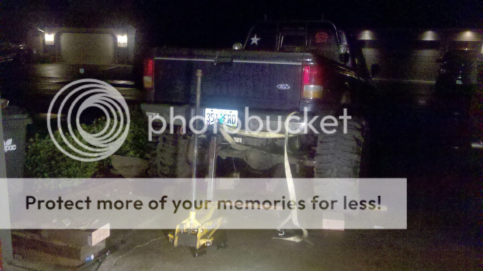

Well looks like a dana 60 hd found a new home in the back of my ranger today.
Im going to drop some coin on gears front and rear hopefully this week and get a new shorter front shaft sent too.
So ill be running 8 lug rear and 5 on 5.5 front in the mean time. I plan on 8 lug swapping the 44 later on and i have 15" 8 lugs i can mix in for the time being.
So my plans for the truck are to be my temp DD till i find a new truck to use as a tow rig.
Ranger ultimately will be running 36-38s for trails and my 40s for sand only.
Well i finally made up my mind.
Sold narrowed 44 1/2 ton for more than i bought it.
Picked up a HP 3/4 ton Full width
Heres a teaser

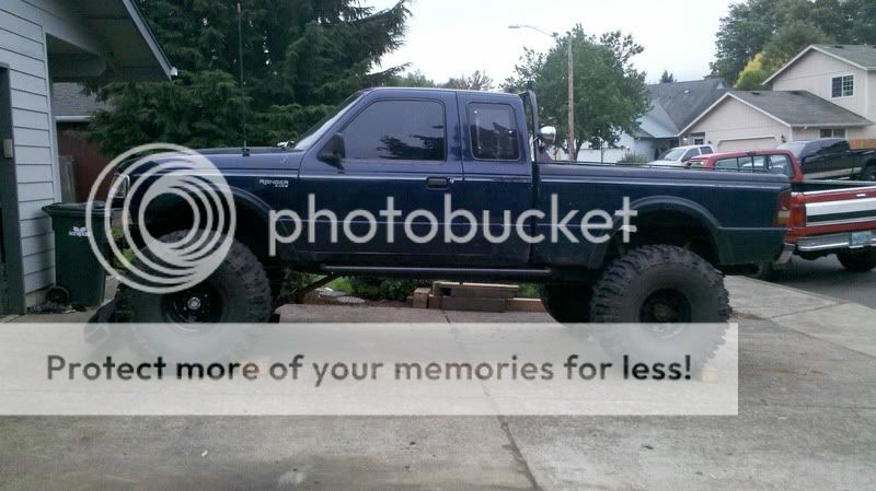

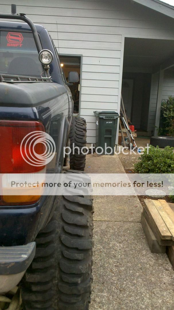

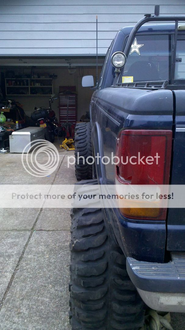

ya ill have better daylight pics tommorow. i work till 6pm so i dont get much light. Tires sit with about 7.5" outside of each fender flare. Those are my wide wheels too so on road ill have a set of 8" with 4"bs it'l be a lil more cop friendly lol

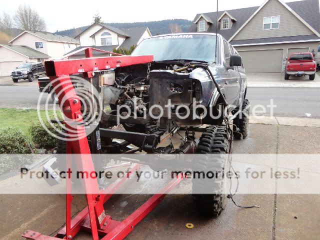

Well i havent had much time to be abe to do things until my boss gave me friday off.
Got the front gutted. Thanks to the use of a snapon air hammer, those rivets didnt stand a chance.

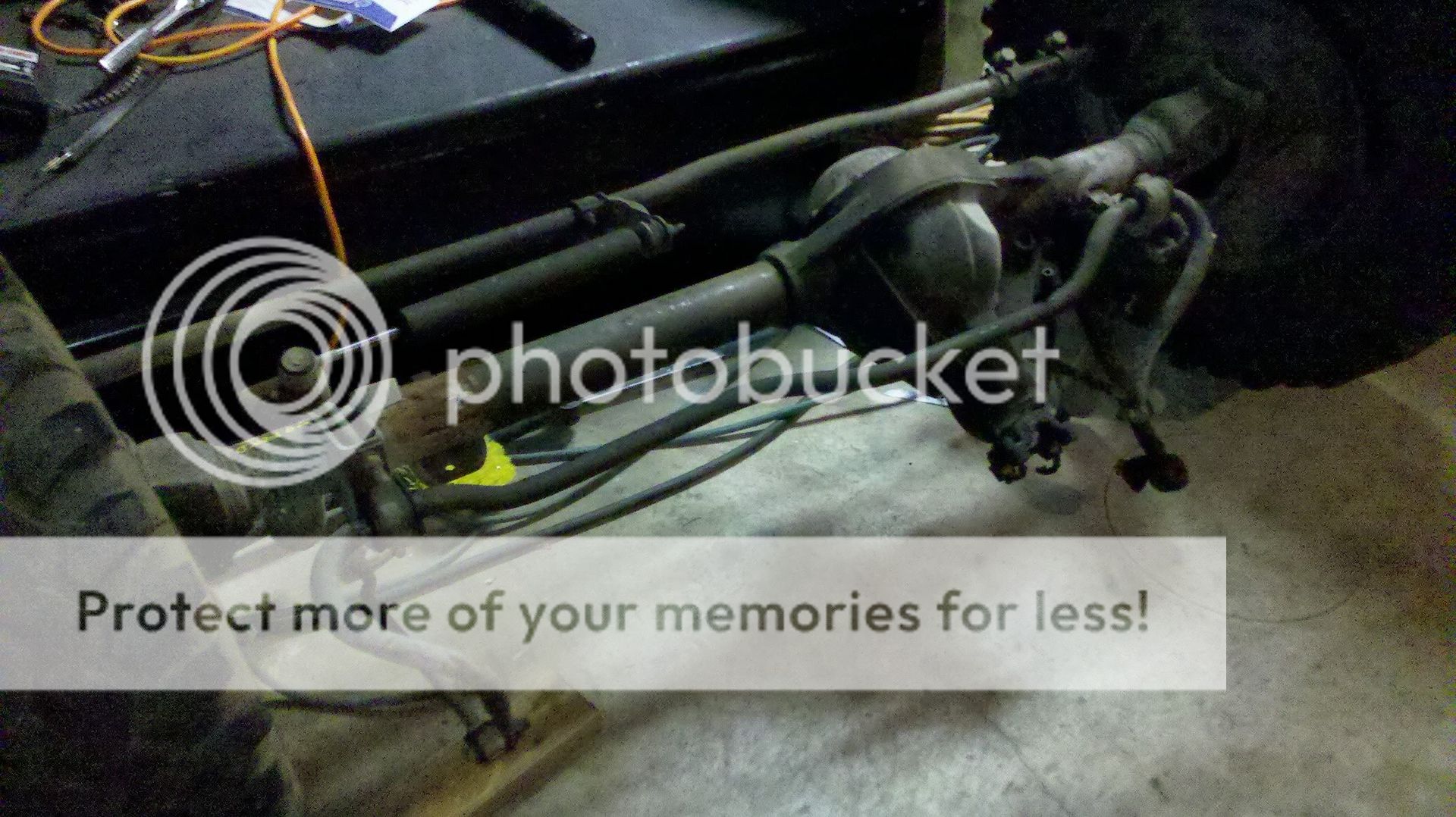

I currently have some S10 rears in the front but will be removing those for explorer rears tommorow. The S10 springs sit too flat, about 2.5" lower than the rear and i fear ill snap or bend the spring end.

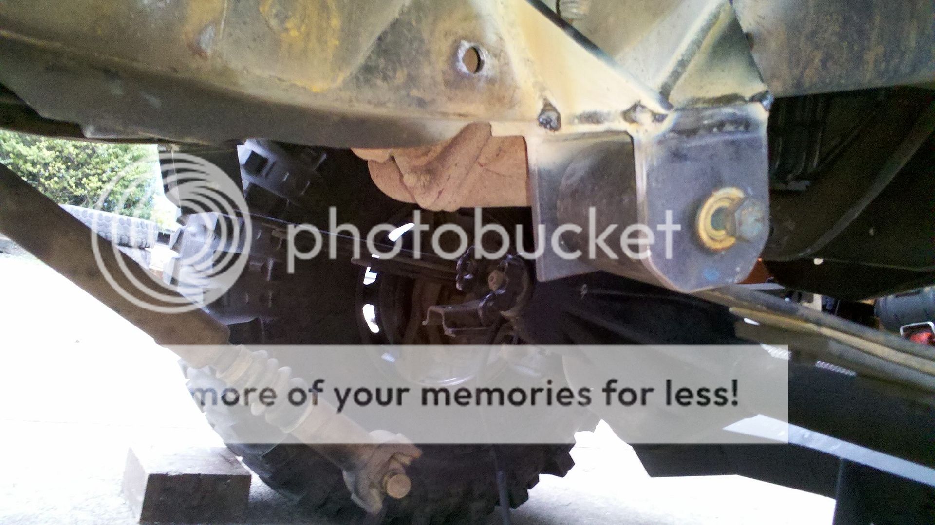

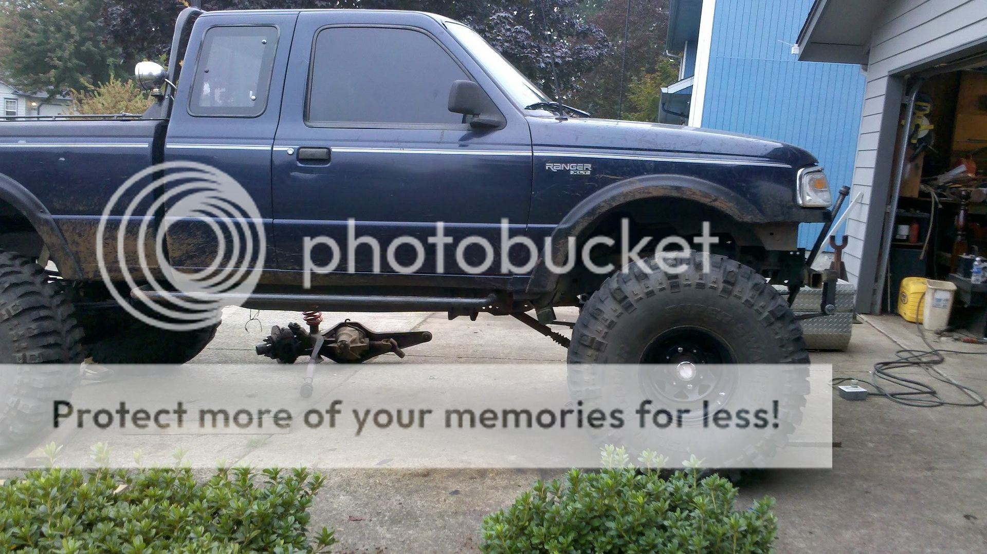

I ended up having to do shackle forward like heeps due to the frame bends dont allow room for a rear shackle or else the pinion will shoot at the ground.
My 94 Ranger RecoveryMy 94 Ranger RecoveryMy 94 Ranger Recovery

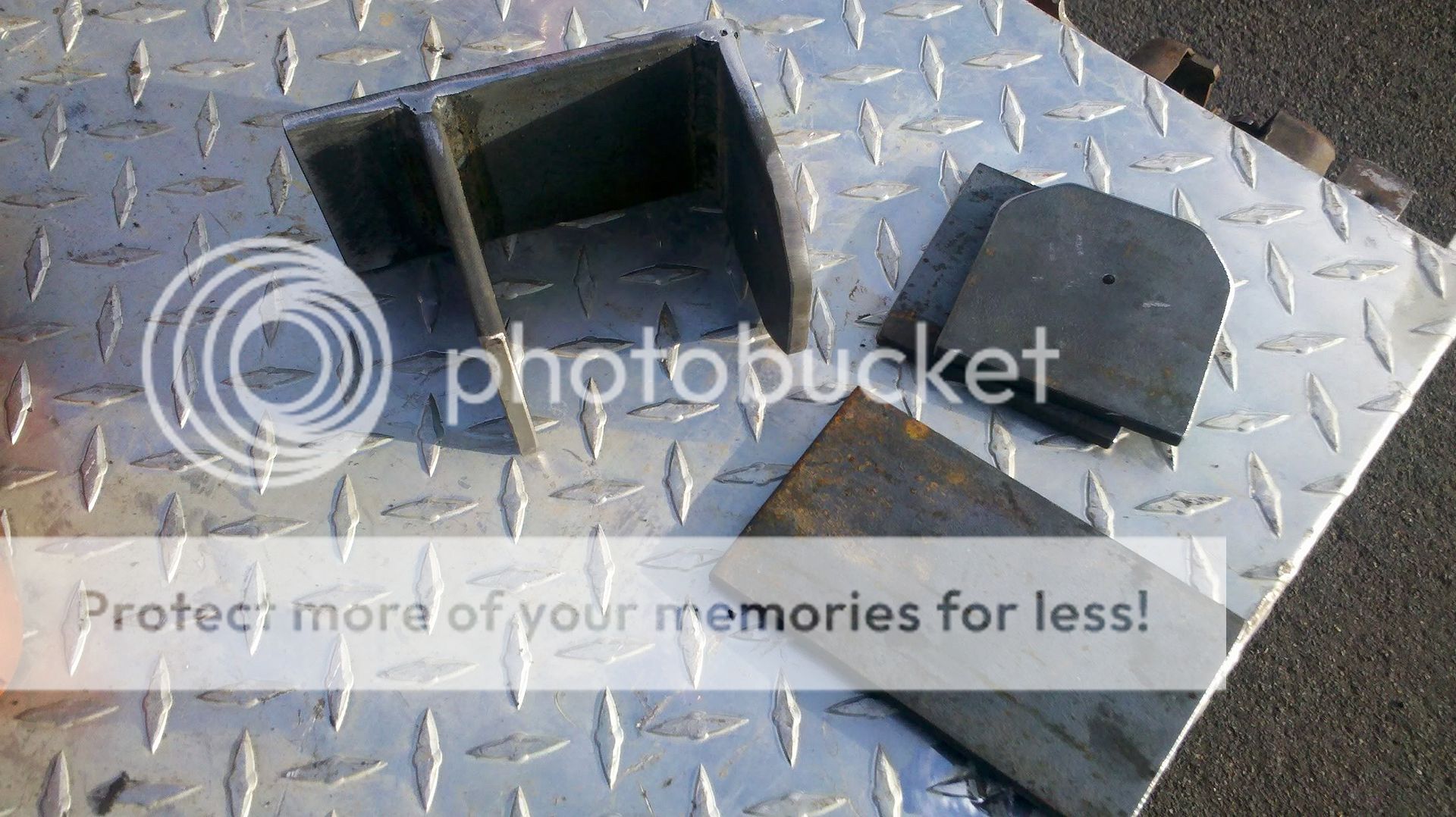

Frame mounts where a bit of a challenge but i got it figured out finally. Lots of bracing to be added soon as i get more welding wire. all bolts in the springs are only mock up till i get new grade 8 and my u bolts are upside down just for mockup purposes as well.

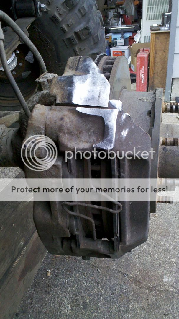

Also had to grind calipers like i did one my 1 ton forgot how much of a PITA it is. For now due to funds im going to use a 1/2 ton tie rod with the factory style crossover steering. Im going to go to full high steer when funds exist.

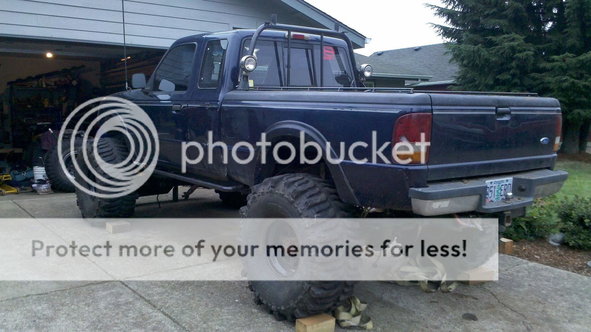

Heres a couple if misc images ive snapped in the daylight. These are all clickable thumbnails that lead to my photobucket of all my other ranger pics.
Funny how those last two pics make it look 3' wide hmmm... maybe a pinch in the future.
Enjoy

i suggest to cut the s10 mains to fully support the explorer mains from past eye to past eye, or maybe just run some chevy fronts with a 2 in lift, or chevy 52's.
i instantly wasted unsupported sploder springs which is why i suggest it...even mid beefed i busted some and a front shaft.
Thanks for the advice on the springs. I was thinking of doing that with the old main leaf off my rangers old rear pack. I will def bastard pack the explorers with some of those s10 for added support.

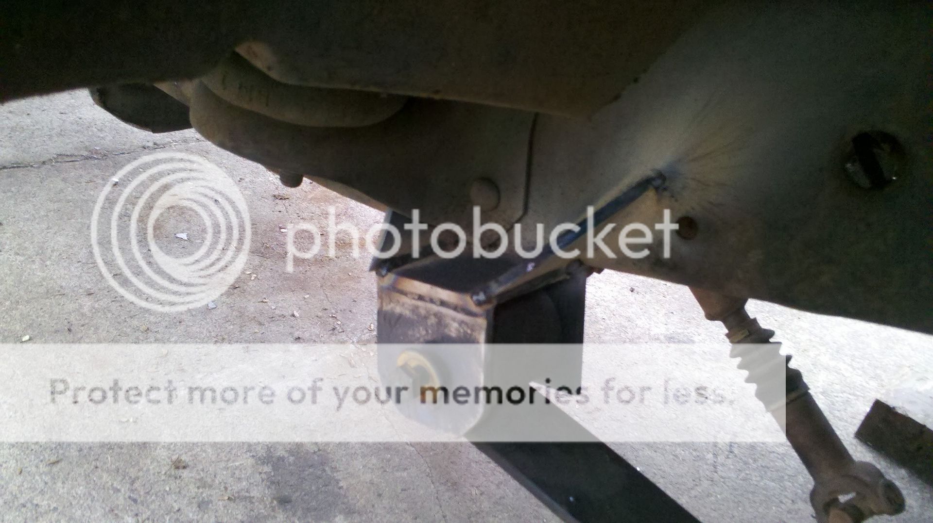

Well not too happy with the shackle placement but not really a good place for it.

She rolls under her own power just need to finish up a few things.

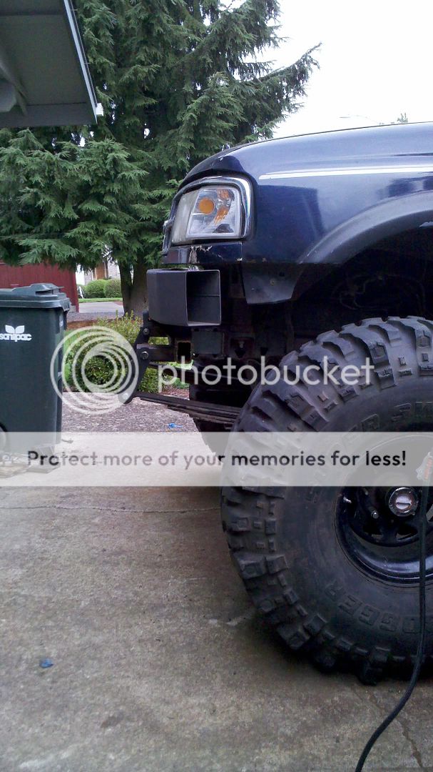

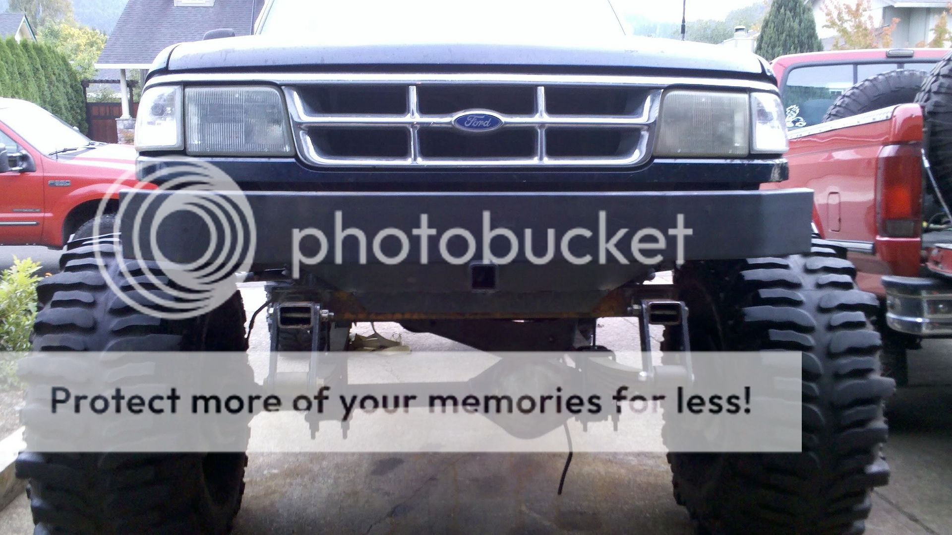

Bumper modified to fit, really cleans it up alot. Still have more attaching points to make for it.

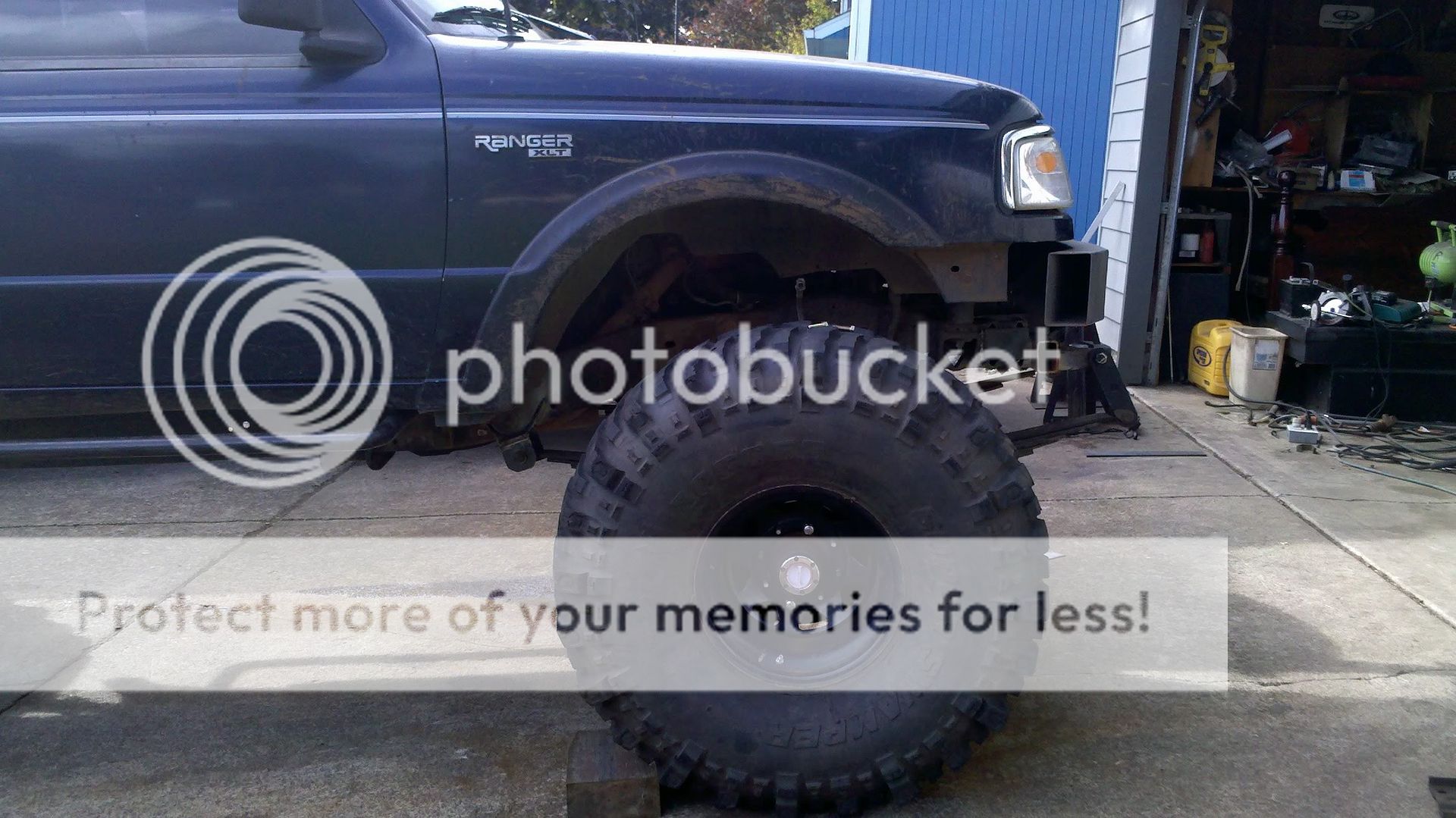

Shackle angle dont look to bad now
Final placement of axle clears the 39.5's nicely
