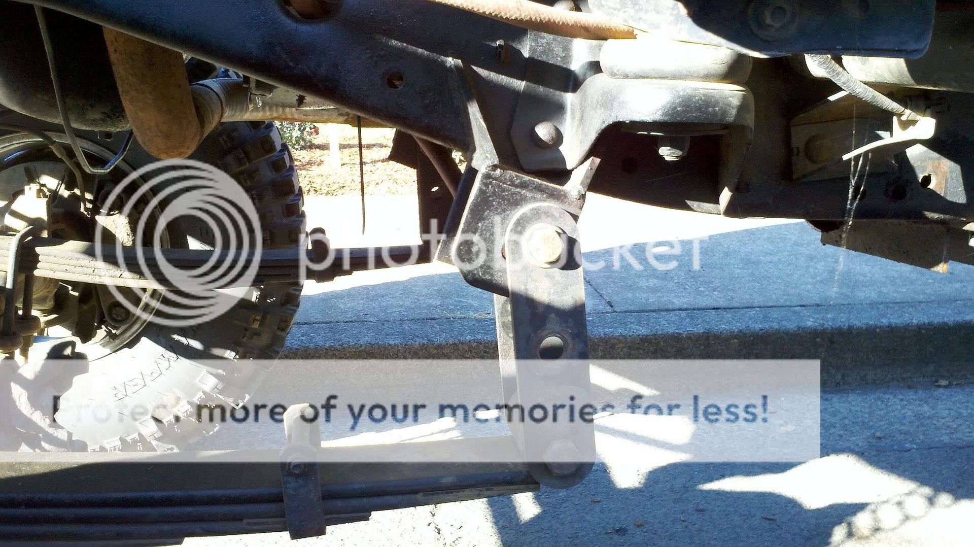

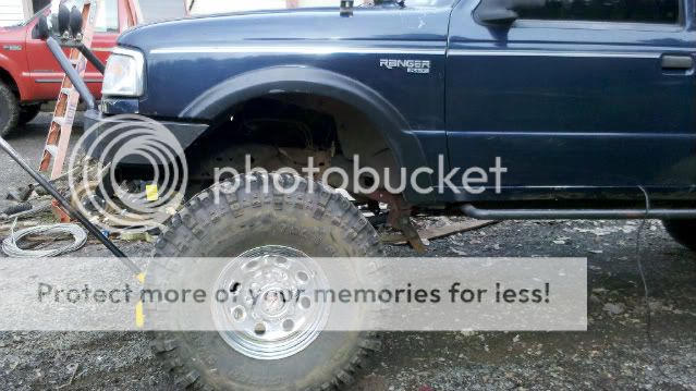

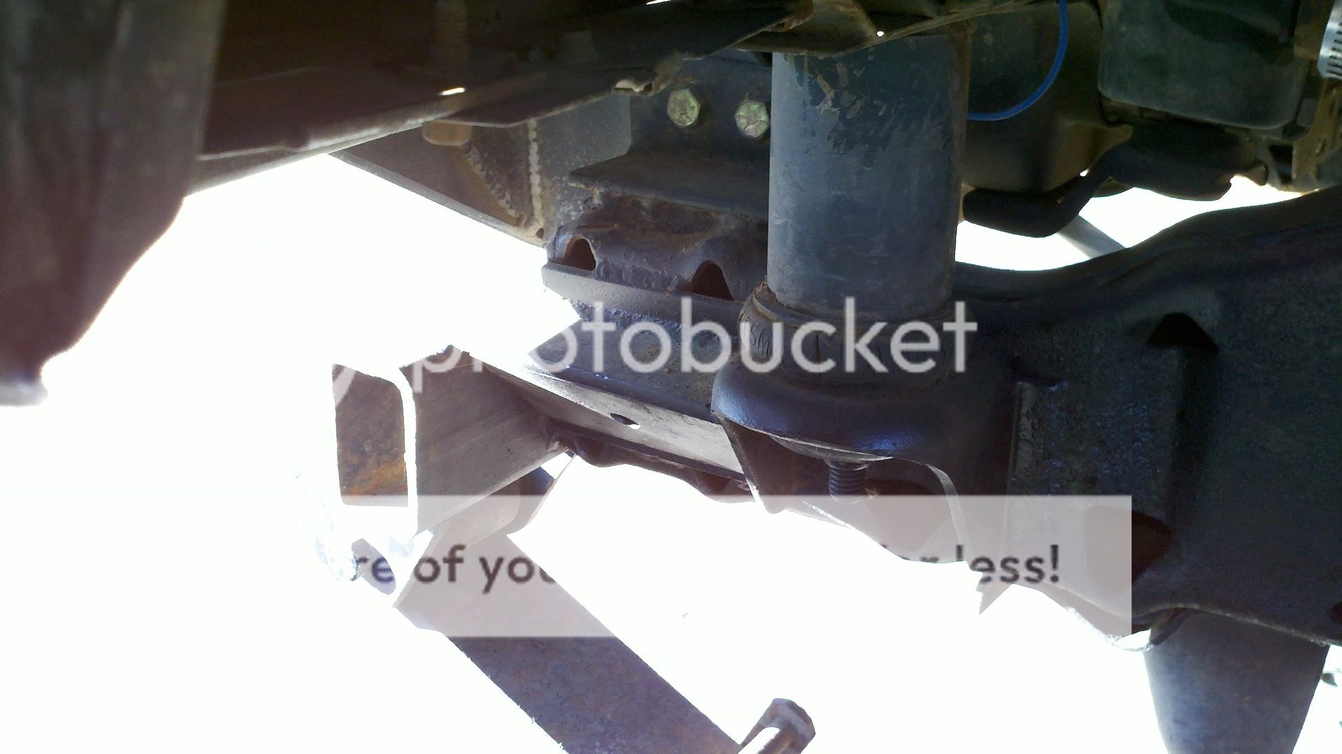

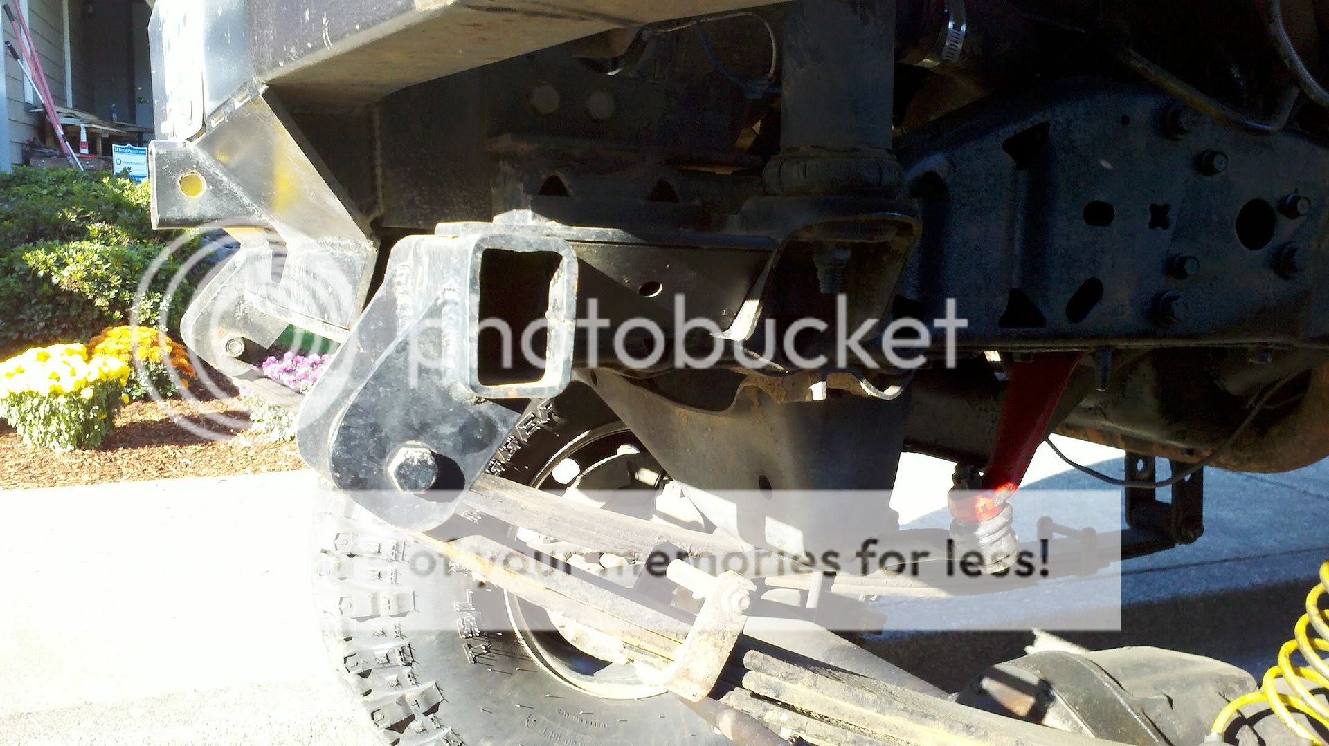

Ugh sorry between work and no internet heres the pics.
I need to cut the shackle mounts off and build a bushing that will sit the shackle closer to the frame, as well as make much shorter shackles. I use to run the middle hole but on the sand hammering down through some whoops would lock my shackles flat.
As for flex, the springs flex really well but if your not running lift springs, yours should flex more. Heres a link to a pic on my FB, i yet to get it on my photobucket. Ill have to look around for the other side of that pic.

Cool. Thanks for the pic. Now I got a general idea of where my rear mount would be.
What did you mean by your shackle lock in place?
I'm no expert, but I think your shackle angle may be way too tall. If you move your mount forward an inch, it'll give you better angle, softer ride, more droop, and better caster. Won't it?
I was running my springs in the middle hole in the shackles and my angle looked like \ but as i would romp on it and the springs would flatten over some whoop roads, the springs would get longer and the shackles would lock like ___
I need to move my frame mount about an inch back and then i can make shorter shackles.
In this pic you can see how my shackle was before and how it could easily invert and lock
But wouldn't moving your mount forward allow you to keep the same angle while using the longer shackle, providing more downtravel and also stopping the leaf from inverting?
