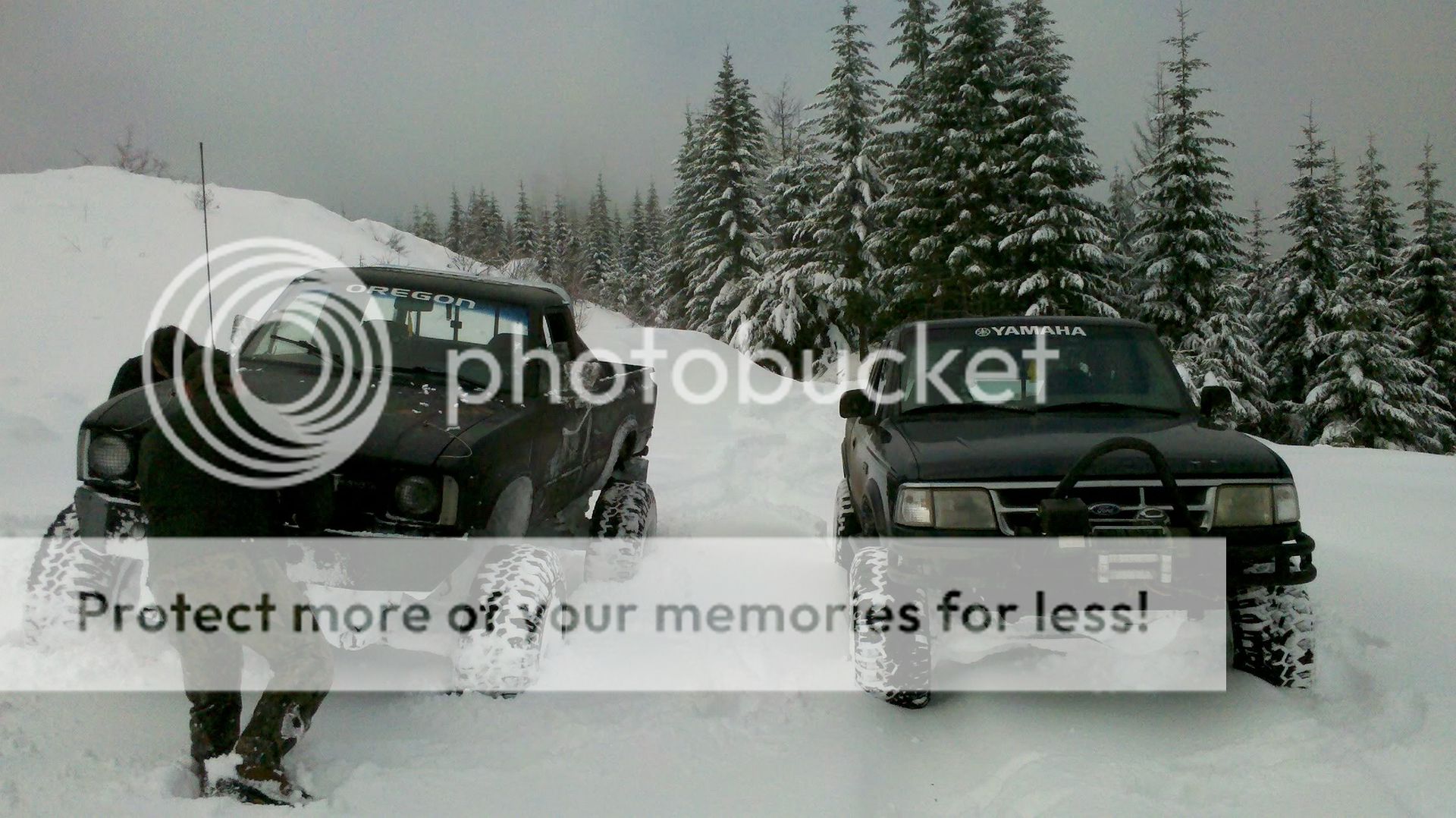

Little update i put a new tube bumper i got off my buddys cherokee works for now but as soon as i get access to a bender again im building a new one similar to Kyle M. Santa blessed me early with a set of 4-6" drop brackets so now im on the hunt for some coils. Id like to get 8" ones and run 35's like the guy that sold me the brackets here localy had. This lil truck is quite the snow machine and they recently redid a rock course trail and it did amazing not even lifting a tire. Future mods are gonna be 4.88's and 35s and thats where id like to leave her for a good DD. Well anyhoo heres a couple pics.

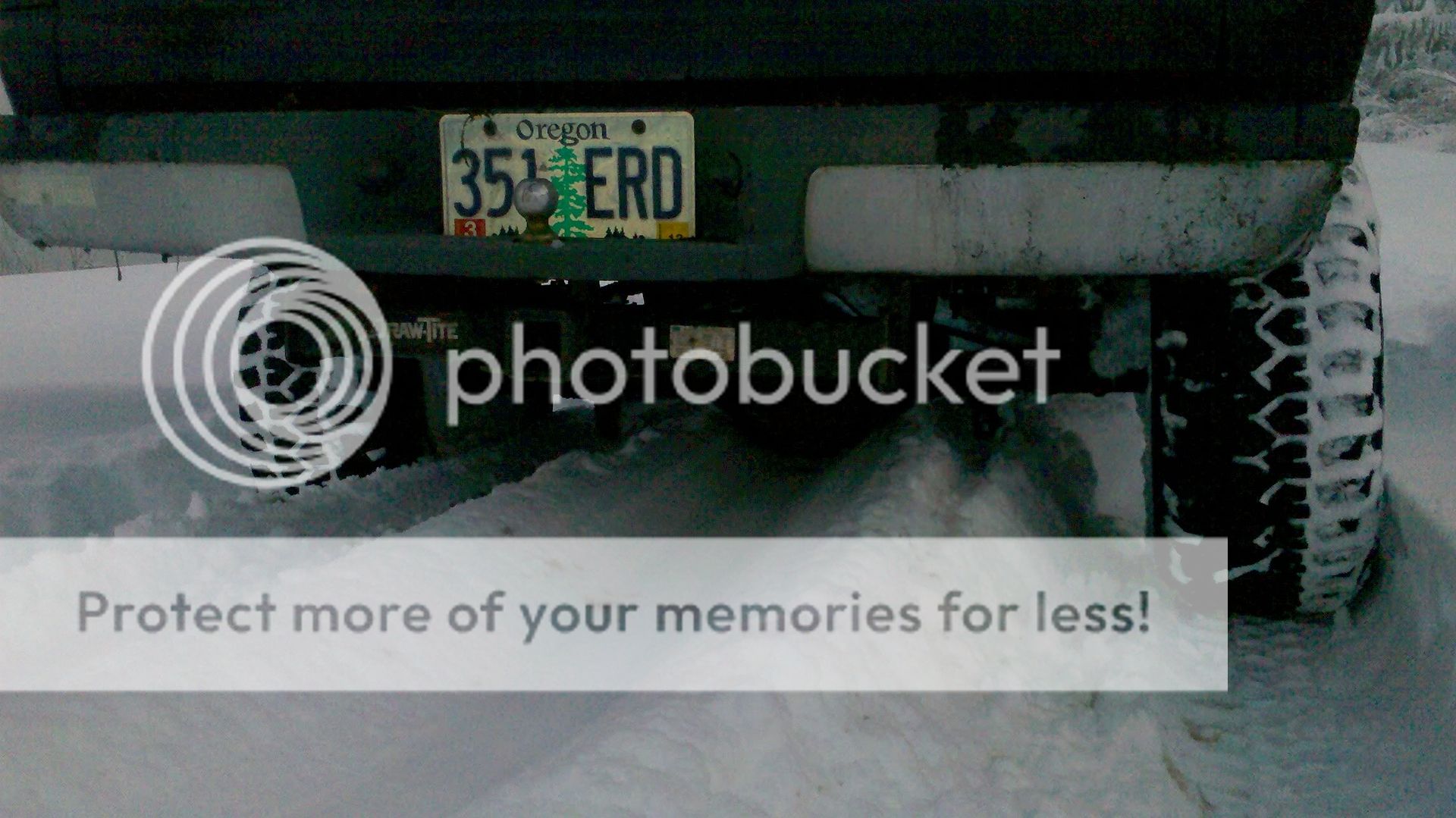

Draggin ass but that dont stop it

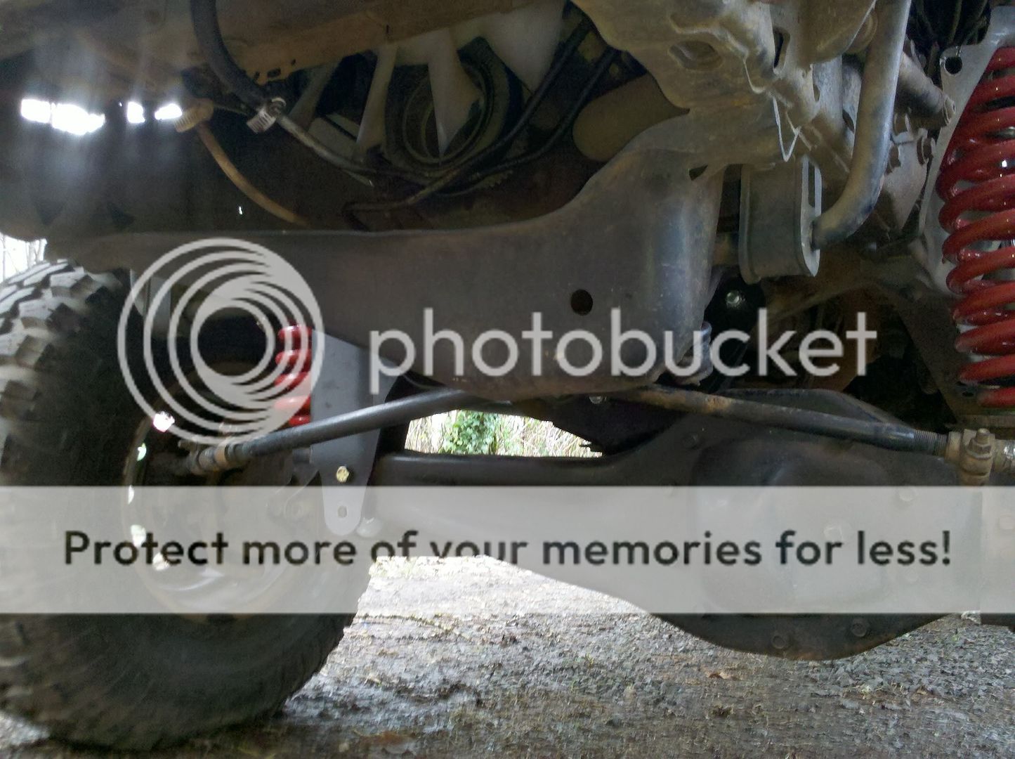

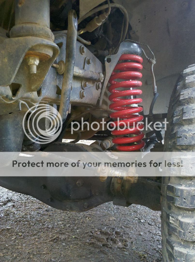

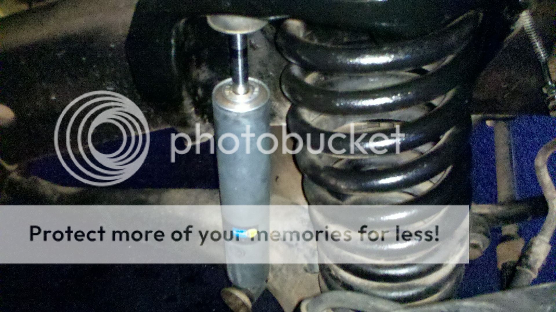

Here u can see the F150 coils and my bilstein shocks off my old 2wd. Good thing the coils dont allow too much uptravel and alot of down travel

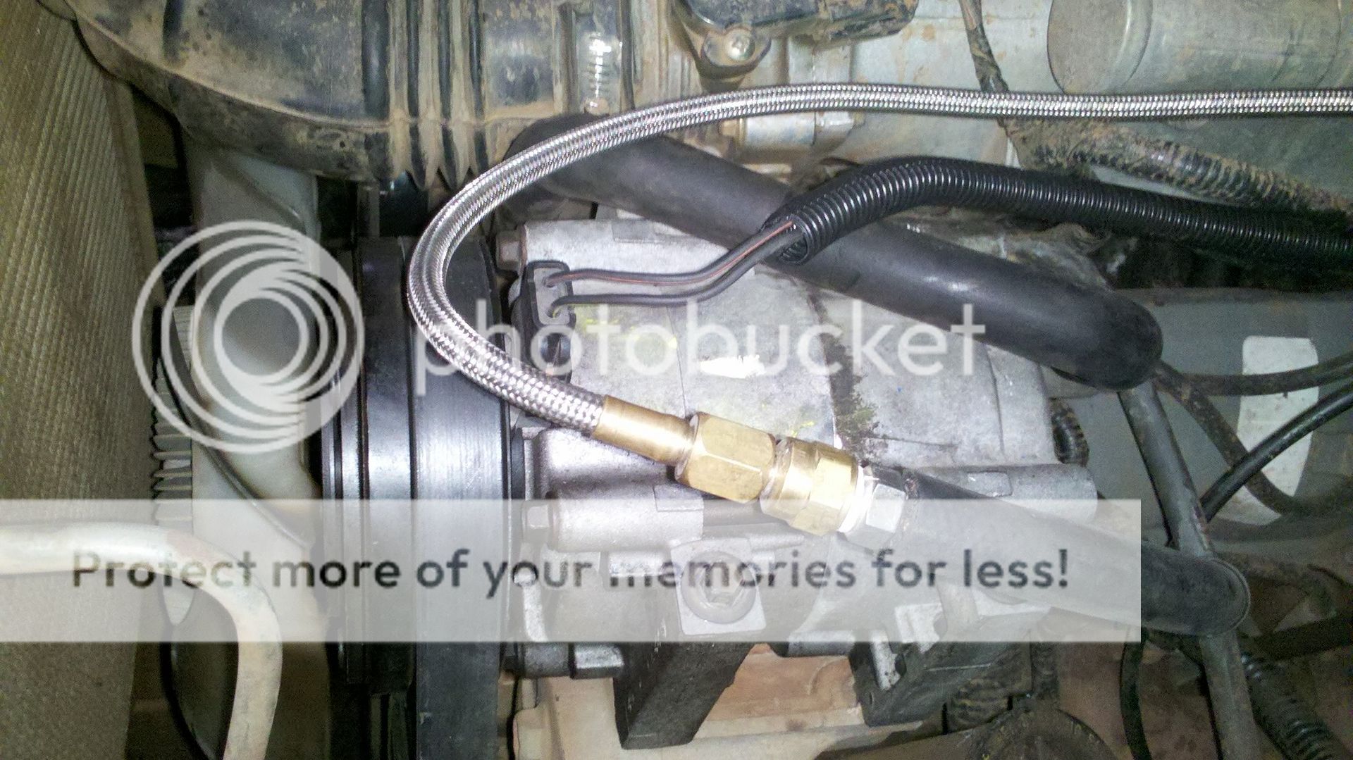

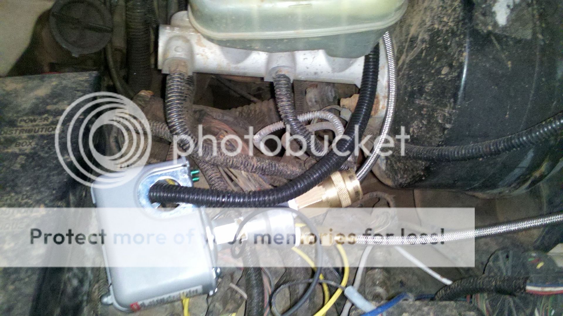

Got me an ac pup from a buddy for free so i built an onboard air setup. Sure was easy to a few builds on explorerforum after aquiring a pressure on off switch for 22 bucks at a local pump shop. Rather suprised it pumps up to 60psi in less than a min in a 2.5 gal tank. Still have to wire in a relay and run a guage inside.

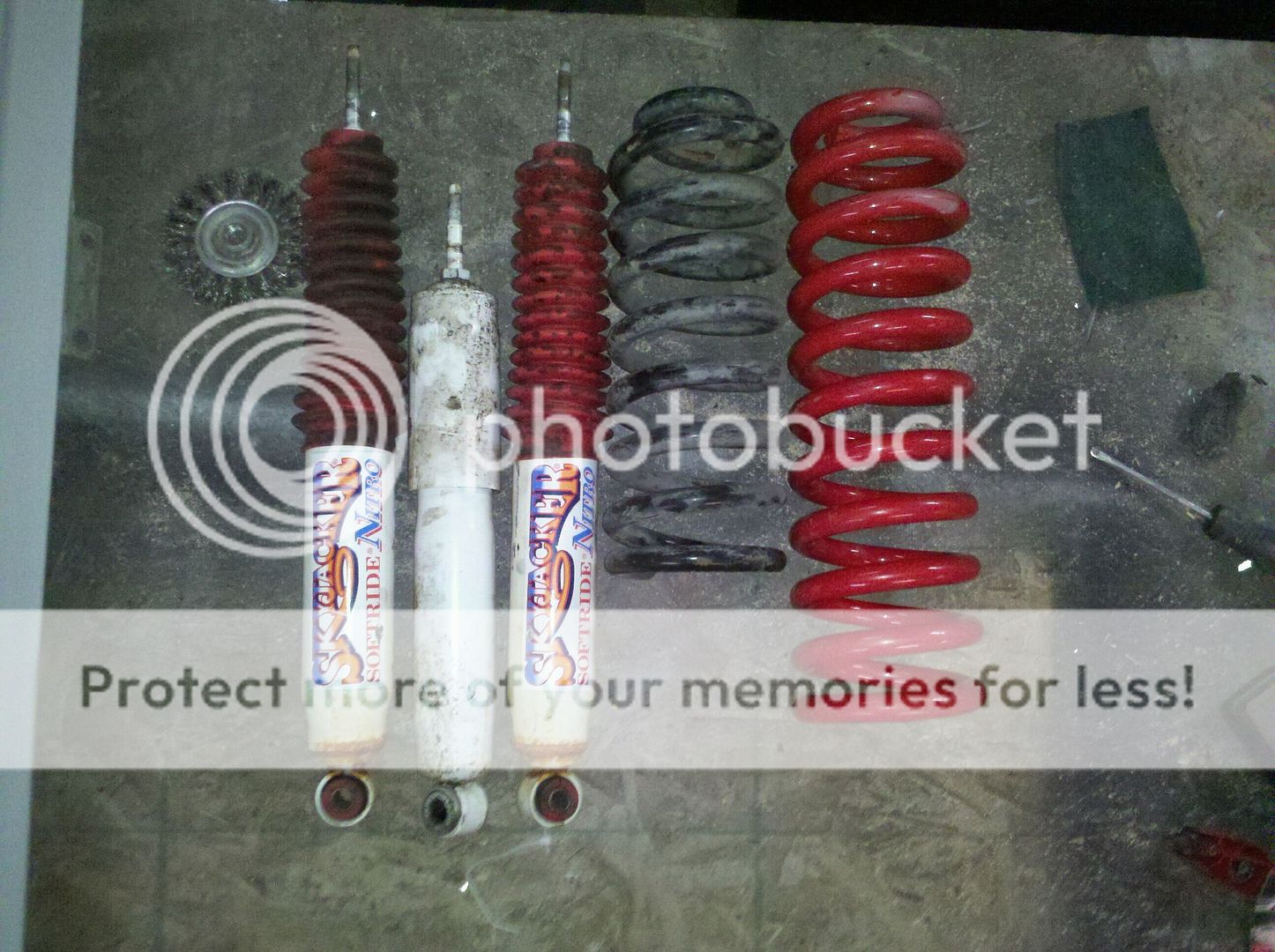

Got myself a set of 6" SJ coils headed my way from the great state of New Hampshire courtesy of gearhead51 as an early wedding present, Thank you very much. Soon as they show up ill be throwing my drop brackets on and fabbin up new extended RA's. As for rear ill do the chevy 63 swap and go from there to make her level.

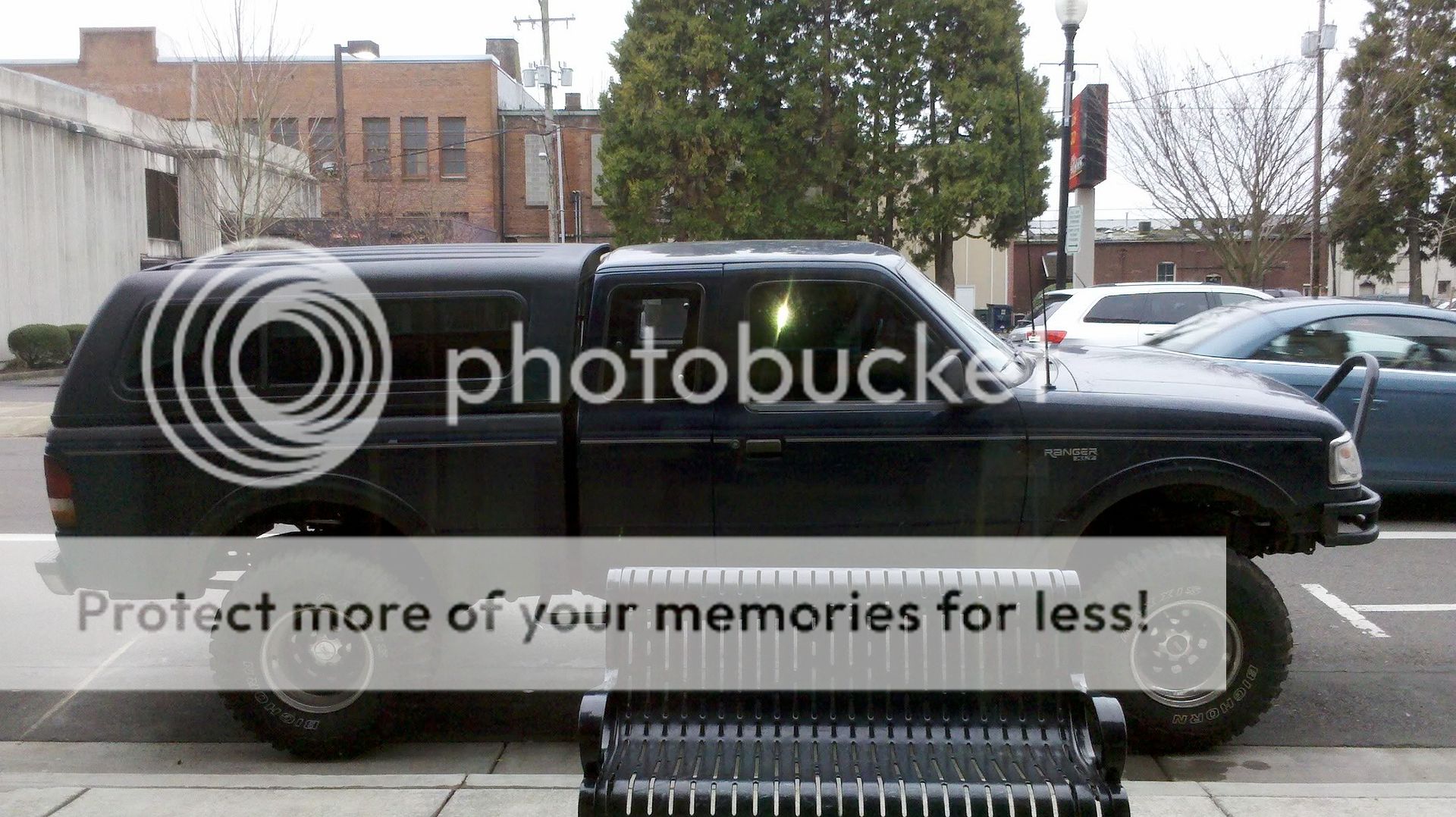

Got a canopy for 50 bucks used of craigslist just needs new gas struts. No leaks and its already tinted to match my window tint. Thinkin it will be great for camping and what not.

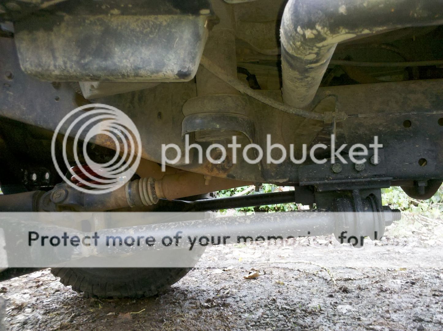

So i got my coils on and drop brackets on last night. Took some DOM and extended my RAs and made new ra brackets got it all mocked up gonna see how it works out after work then burn em in. Took a pair of spare RAs and choppped off 2.5" of the slug so i got plenty inside the tube. Also thre some 1" coil spacers in just cause i like tall stuff. Ill see if i can figure out posting some pics from photobucket via droid.

Ok time has tooken too long and i been working way too much and have not spent enough time on the ranger. Lift is on gonna order some coil spacers to put her around 8" just cause the way i like it. Built Extended RA's but i need to heat and invert them just a smidge so i dont rub on em anymore. Also need to get my new brake lines ordered, just pulled stock ones out of mounts for time being. Also put my drop pitman arm on just need to get her in for an alignment.

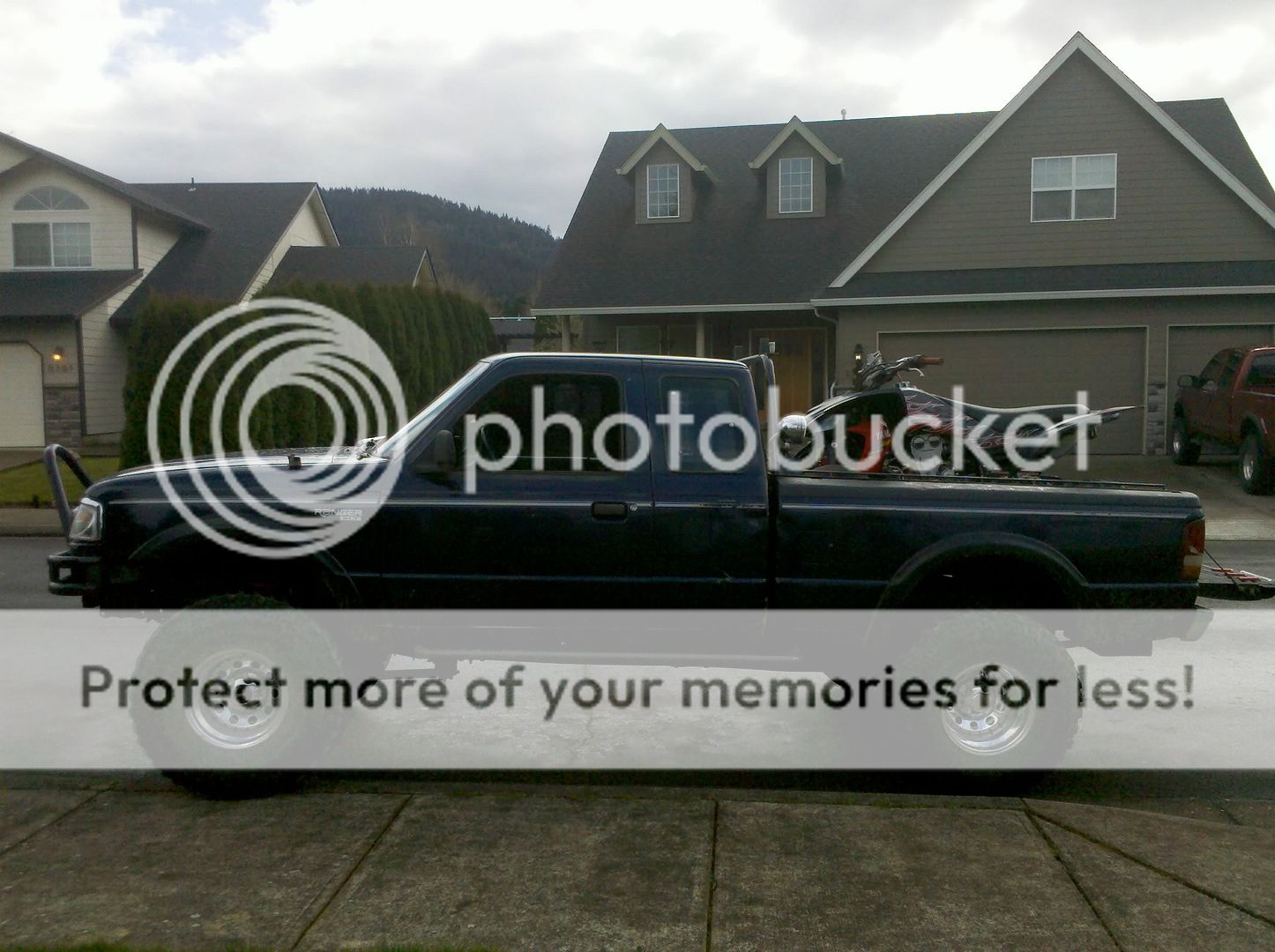

Posin with 35s when i was dropping my bike off at my dads
