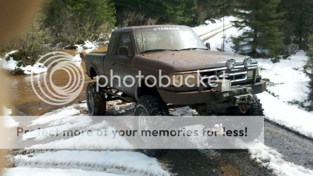

Well i been up for 36 hrs straight working on this thing and it finally paid off. Shes 2 wheel drive for the moment but shes a driver now. Built a 2 into 1 exhaust exiting the pass fender into a 3" muffler inside rock sliders. Some mild tuning and she will be good.
Now its time for bed...

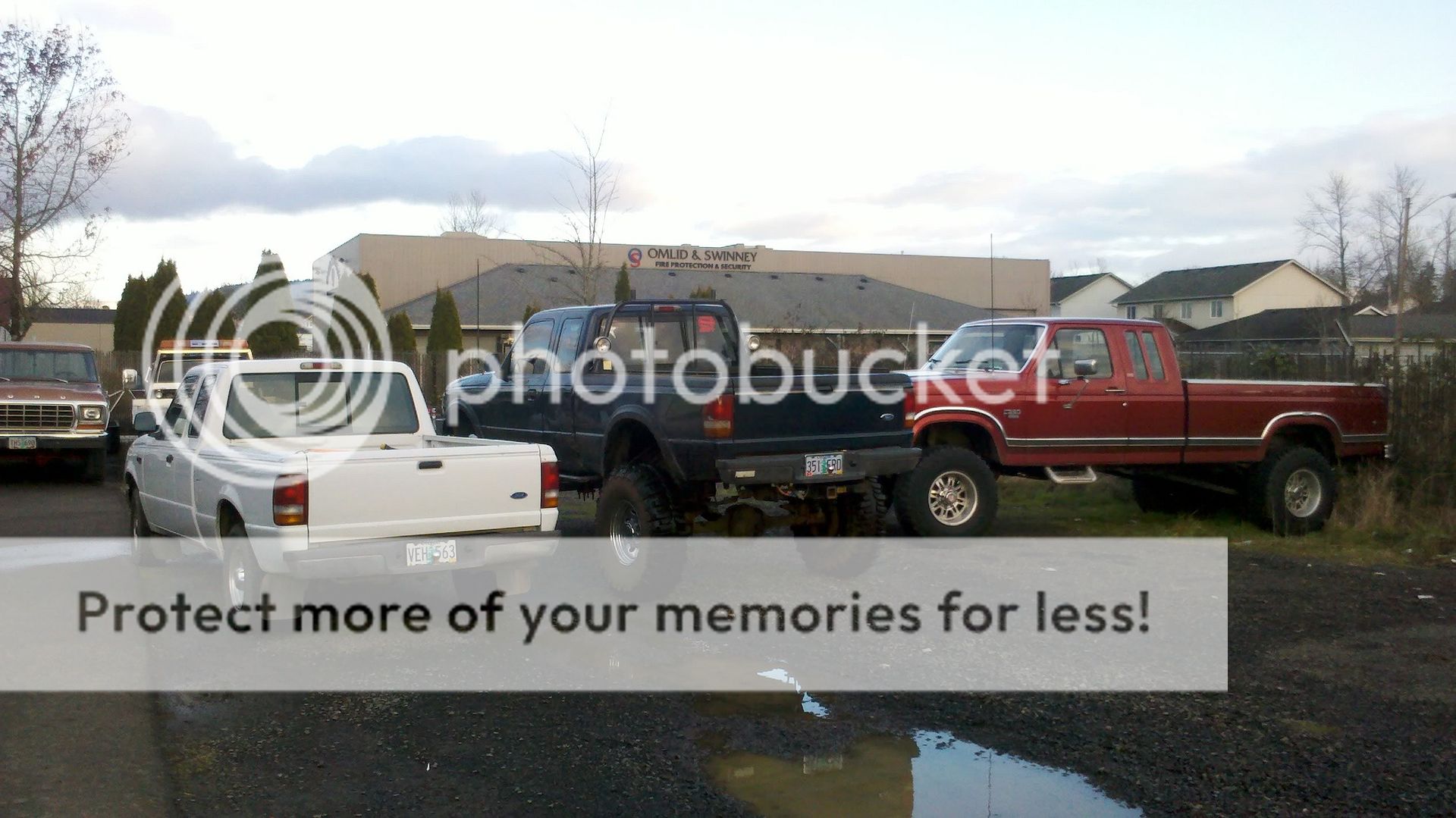

Sitting next to my buddys freshly fixed up 2wd

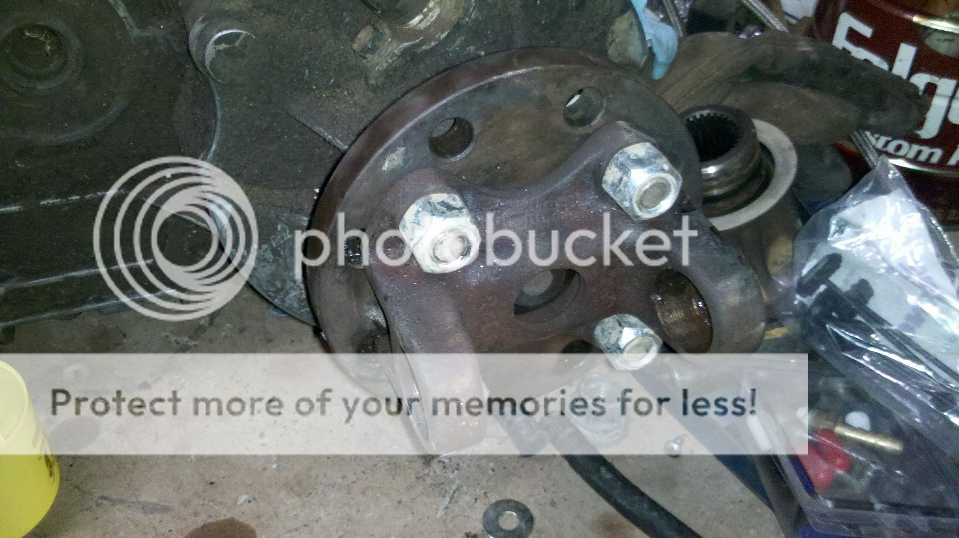

Drive flange redrilled for ranger yoke

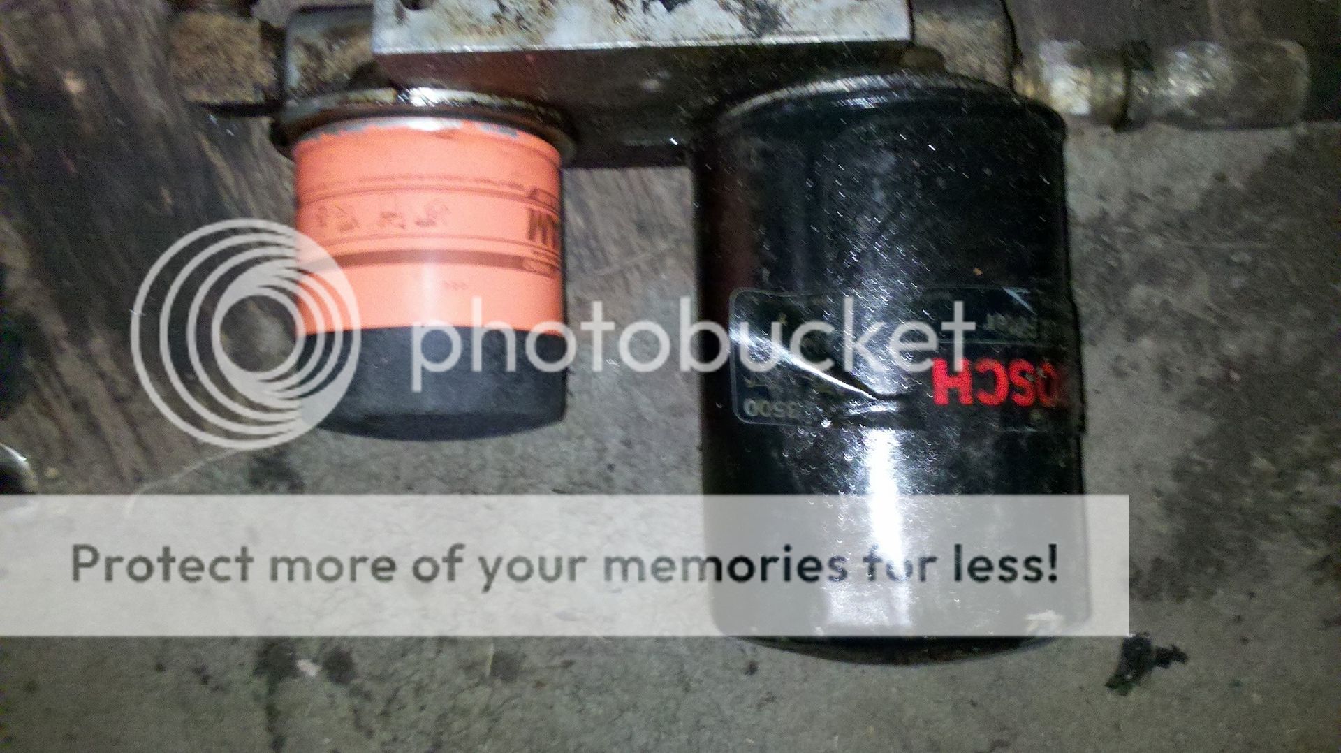

My baby oil filter that flows the same as a ph8a

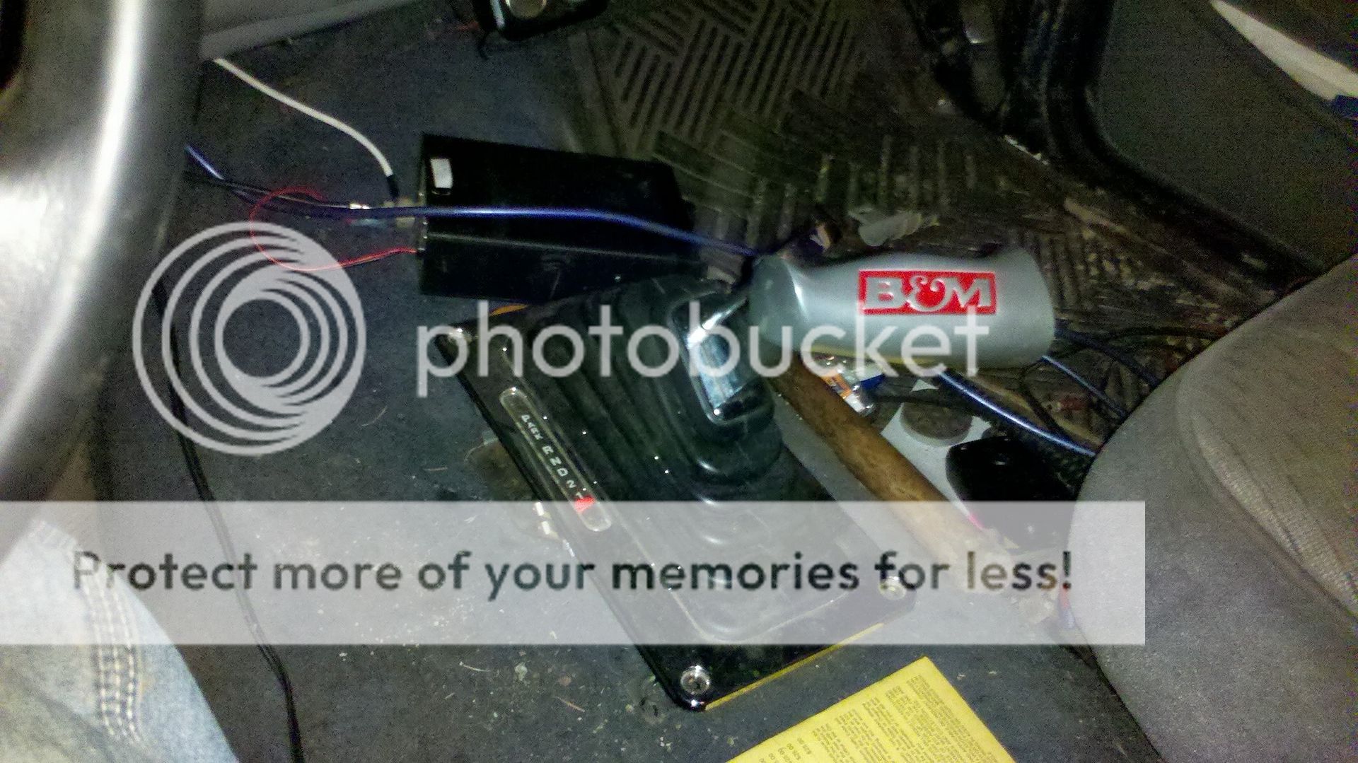

Picked up a B&M mega shifter from a buddy

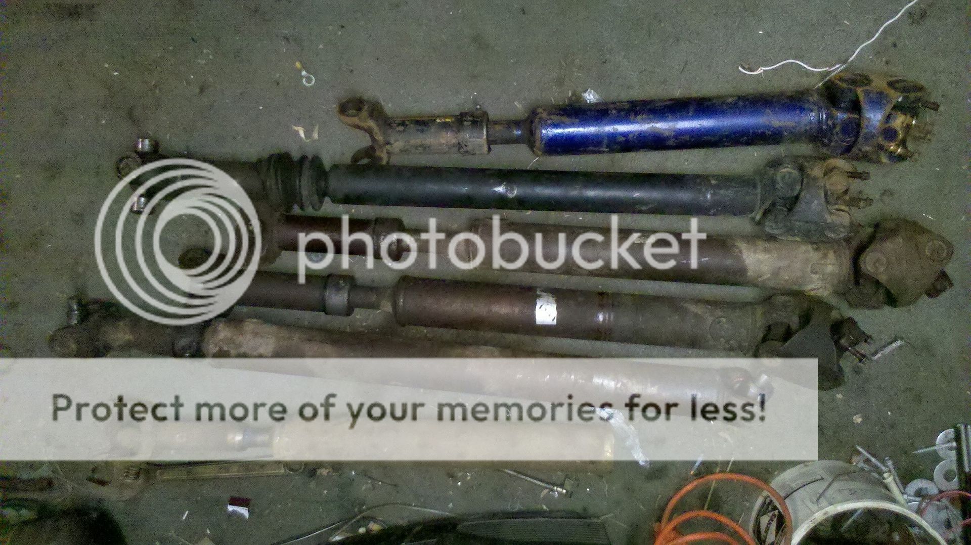

Got a couple front drivelines for when i get the right yoke

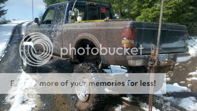

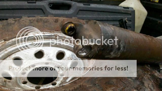

Toasted the rear driveline and debeaded my bogger. Rear driveline had suffered damage before when it was in my 78 so i think thats why the ears tore. And i was attemping a sloppy hill climb out of a mud hole that my buddy on 44's and a BBF could barely make. Going forward i kept stalling out so i did it backwards. Got up it but coming down debeaded tire and blew d line.
Did all the snow in front wheel drive only had to get a pull twice cause of ice. I have to say that that dana 44 sure surprises me with the 38.5's on it and throwing all the power of the 351 at it.
Time to build a new shaft and get some beadlock rings
