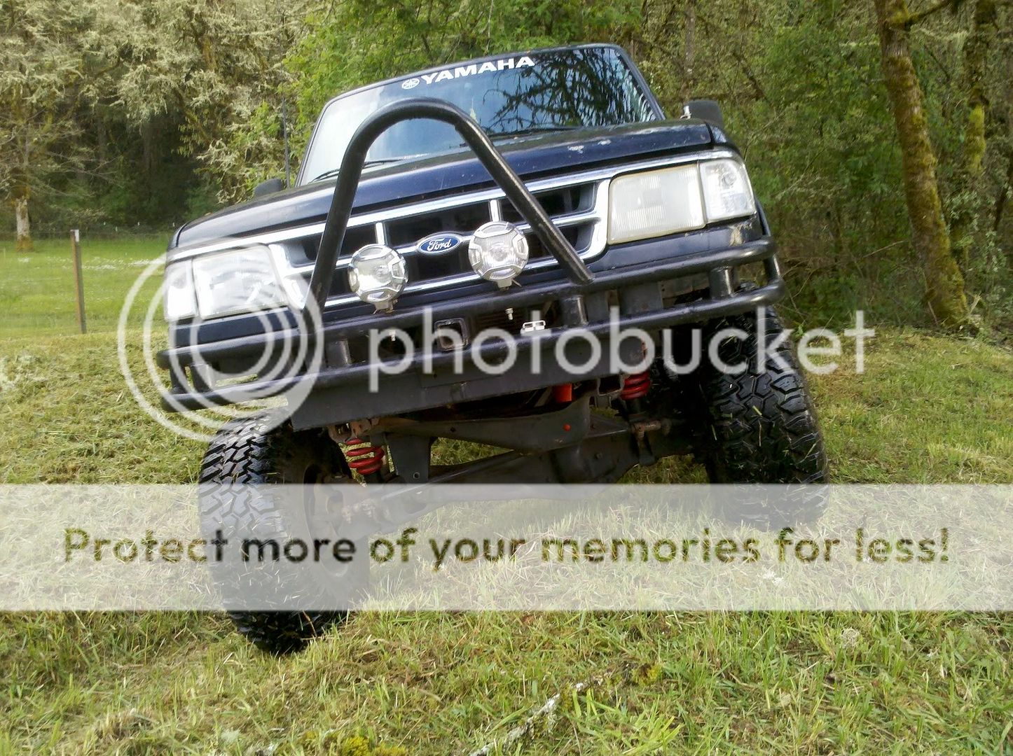

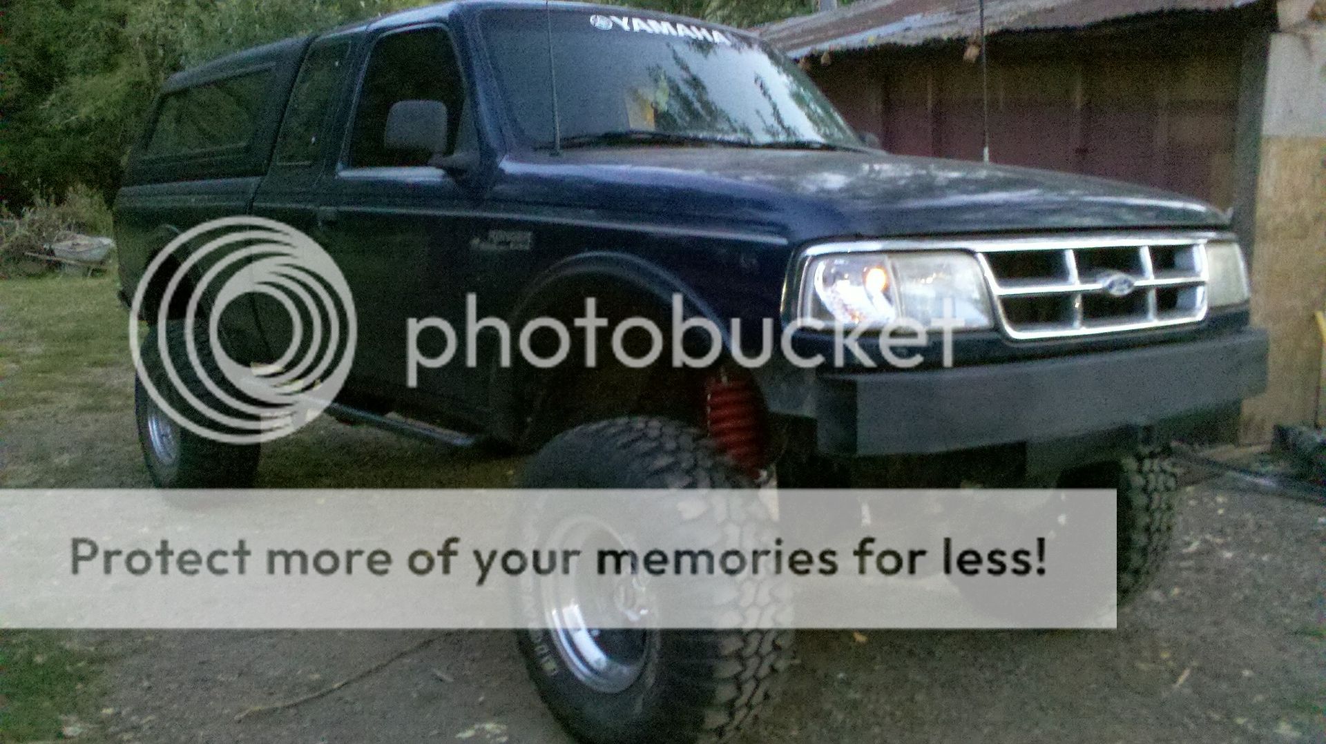

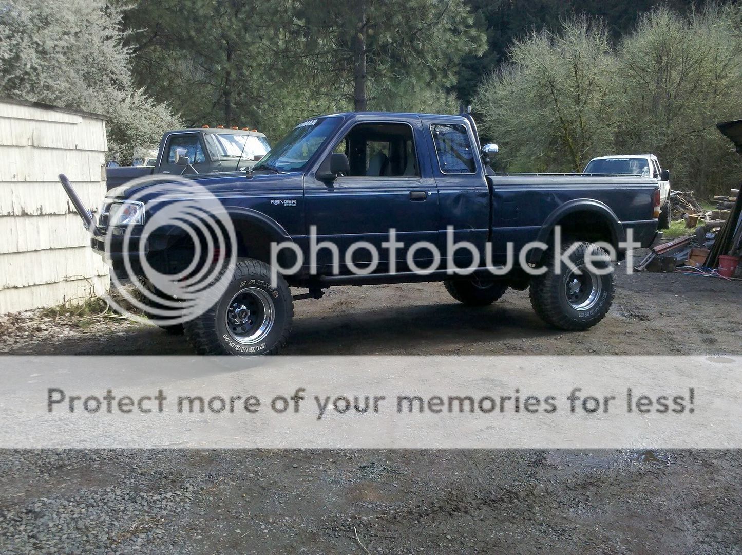

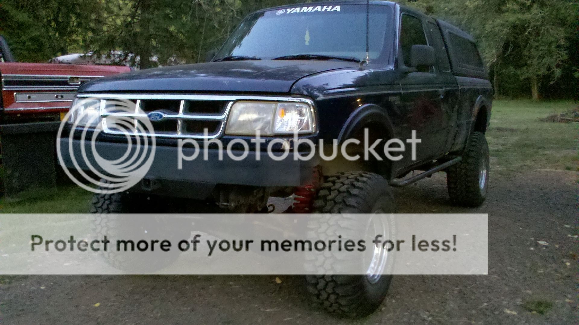

Ran some 35's on her, loved it. Now if i can find someone to trade my like new 33s for 35s ill be set. LOVE the new suspension it rides soooo goood. Just need to push my radius arms forward another inch i think. Finally got some rear shackles to help make it look like a truck, not a baja 1000 truck.

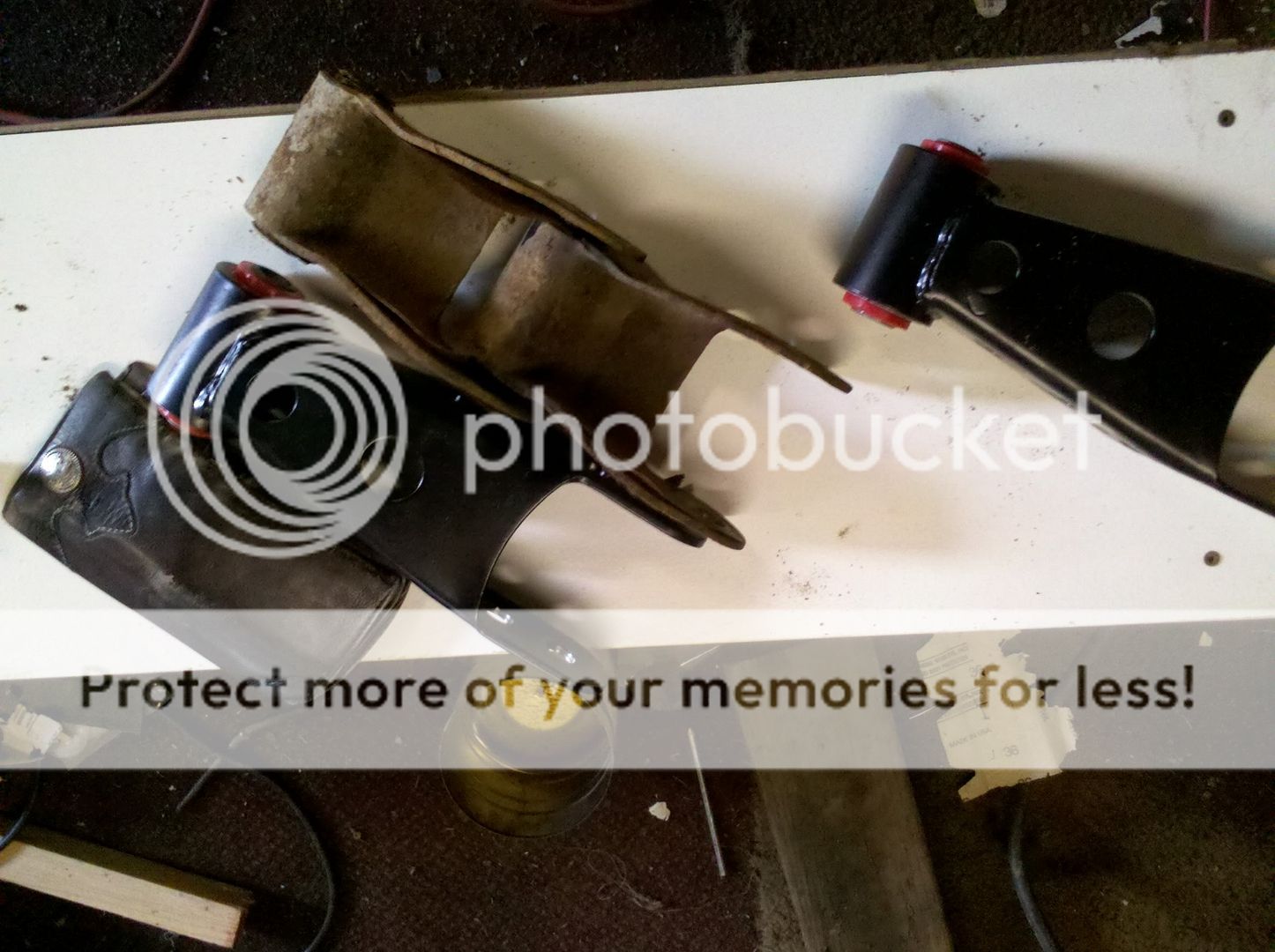

Heres the new shackles for the rear gained 2.5" of lift

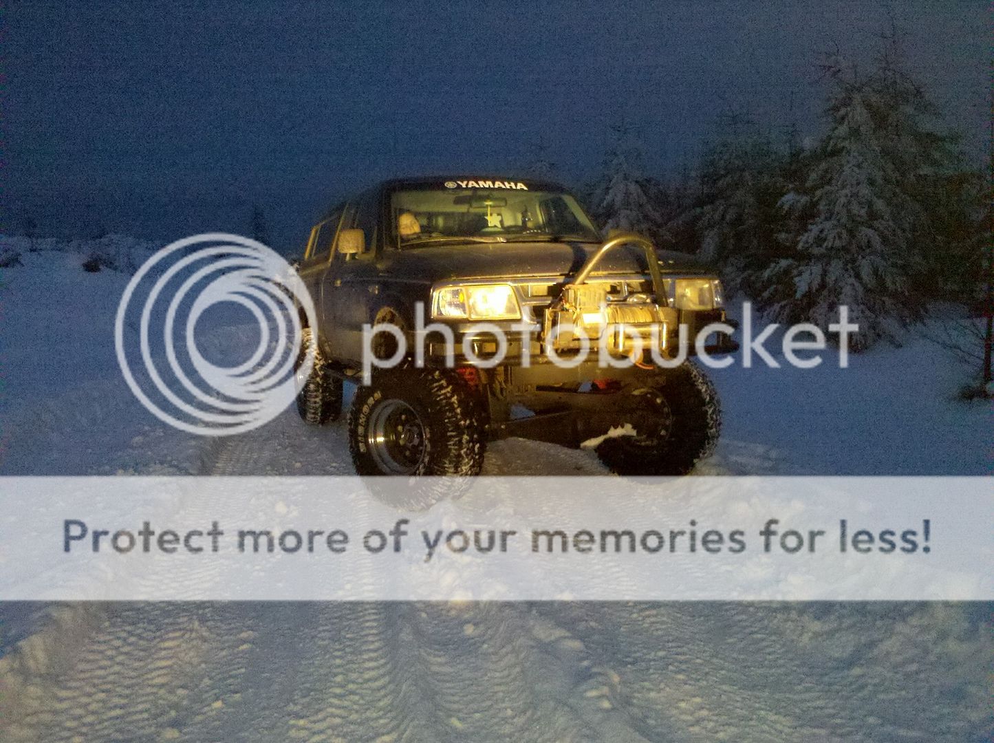

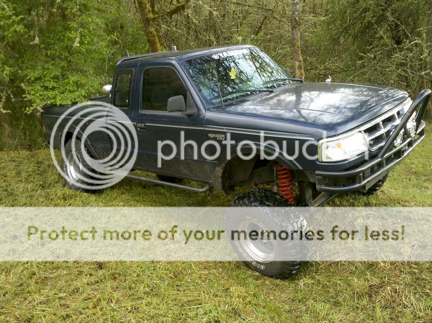

Here was a night run in the snow testing the suspension out

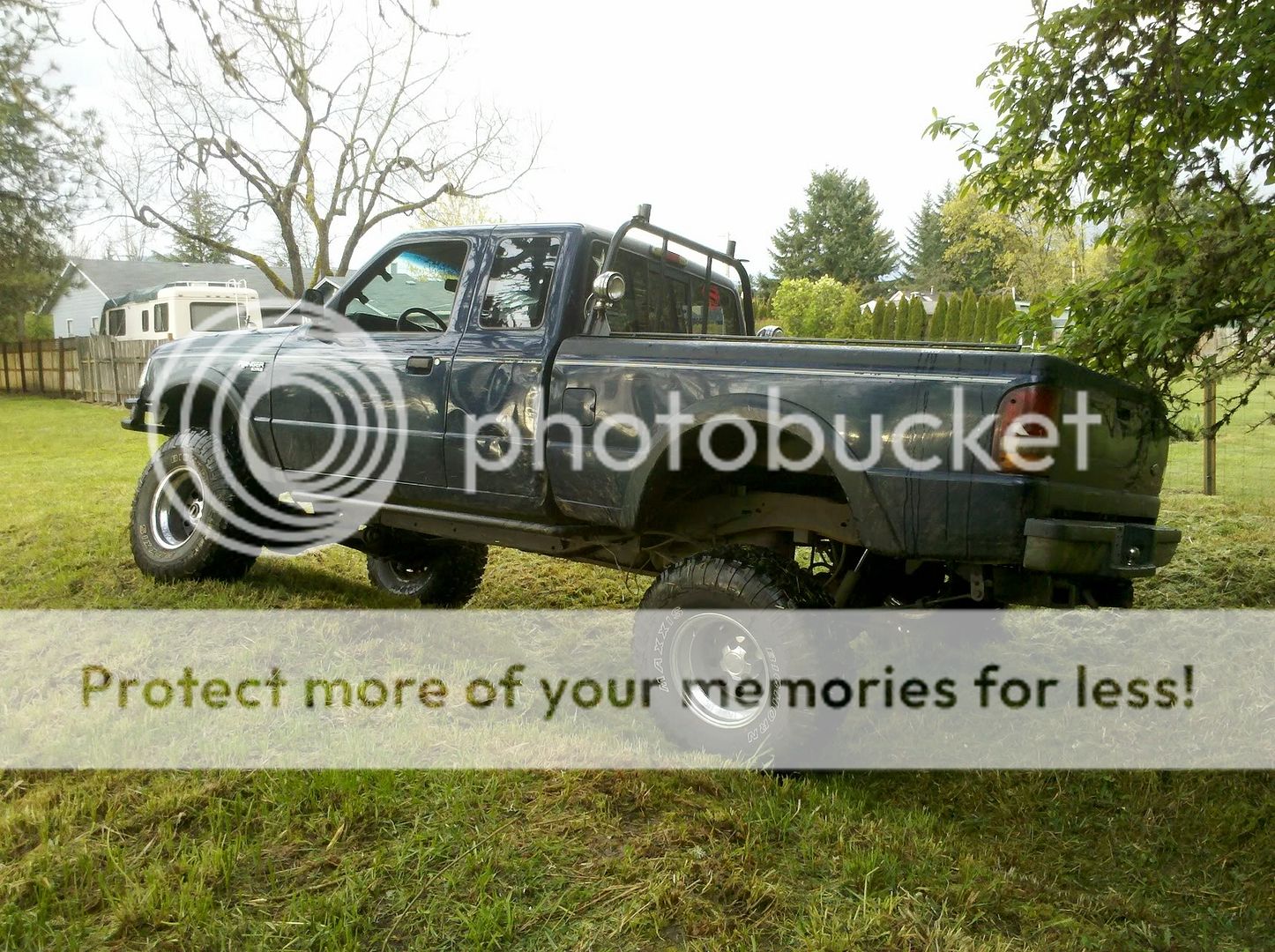

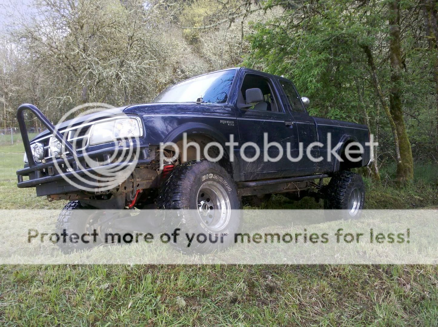

Posin with the new shackles on. She is sitting with 11" of lift now, 3" is a BL that is for anticpation for a 303 swap. Yes i know i need 35s

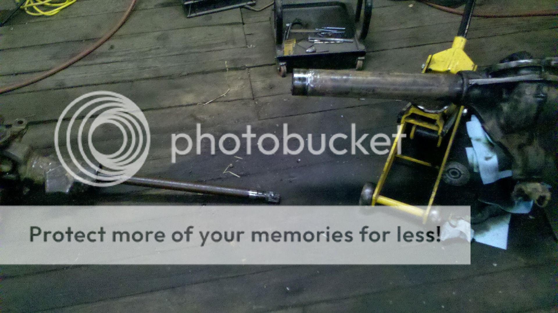

Worked in my back yard a lil today and found a ditch that i decided to flex in and i wasnt very happy with how little the front flexed.

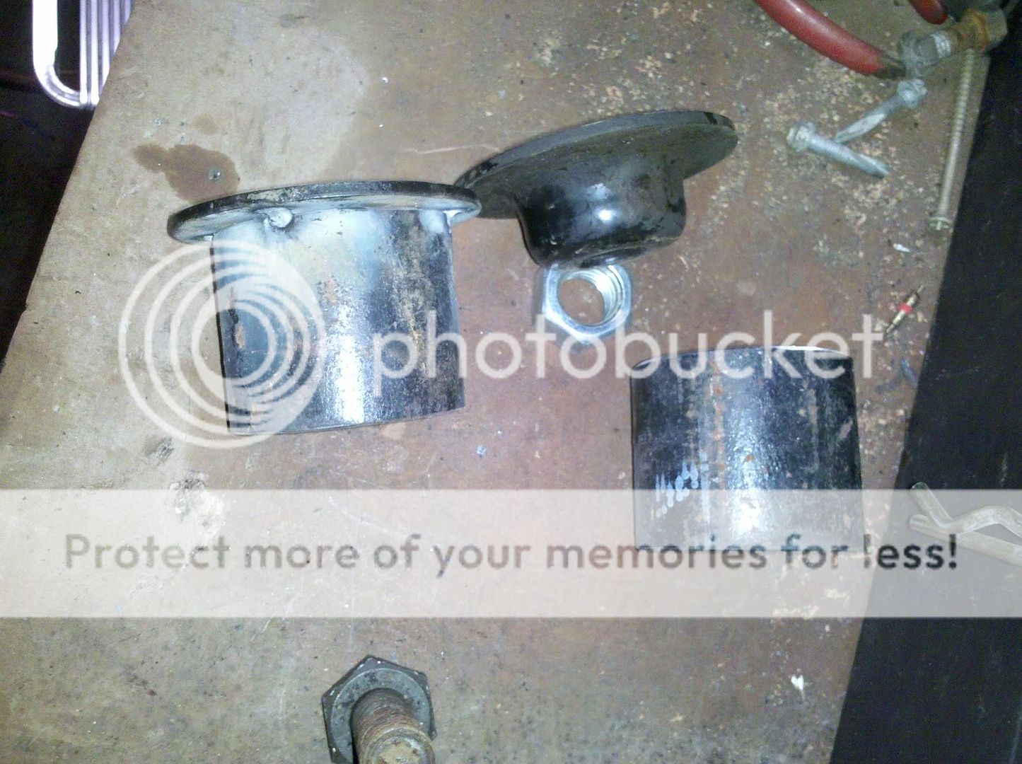

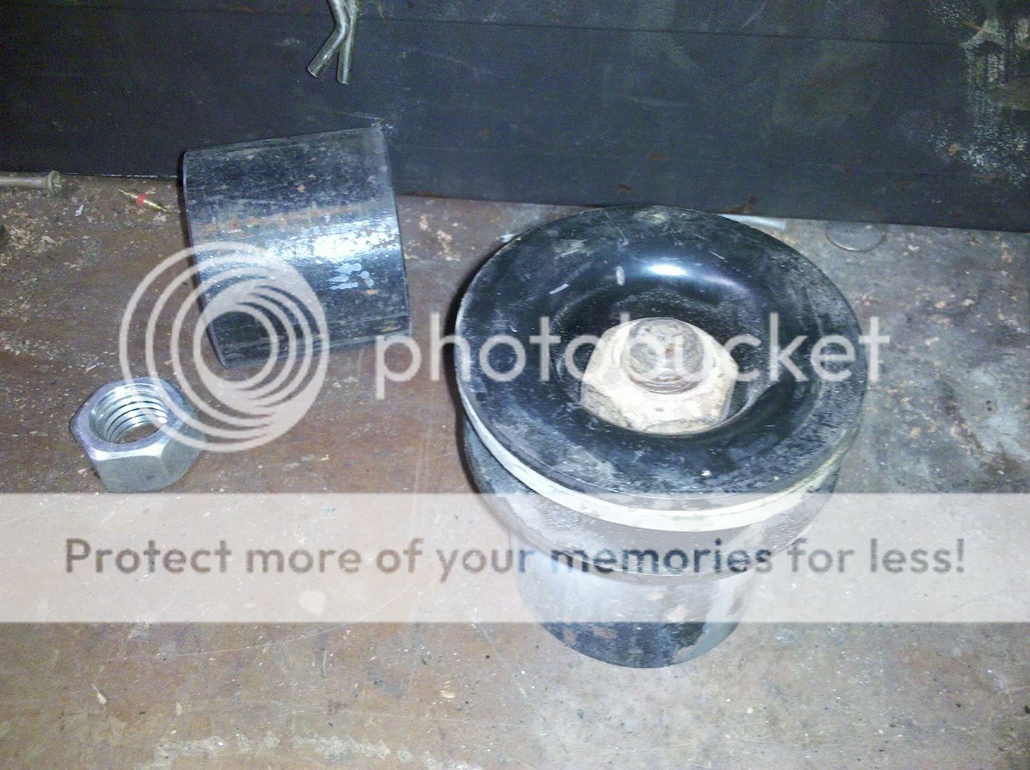

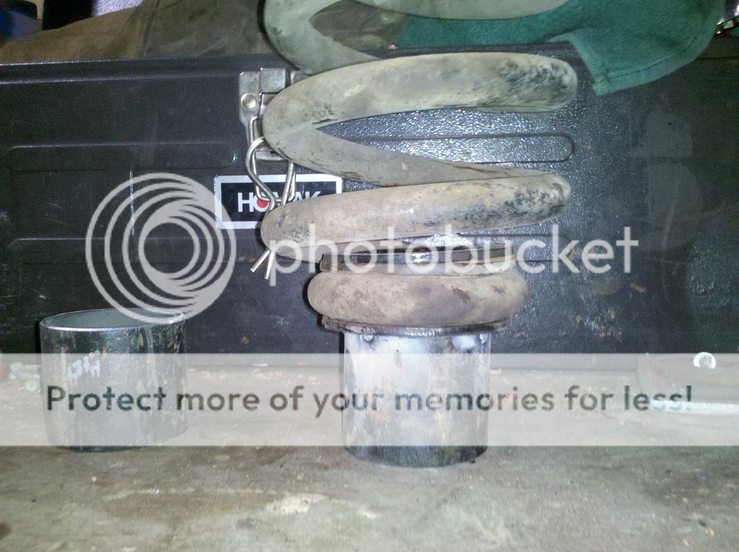

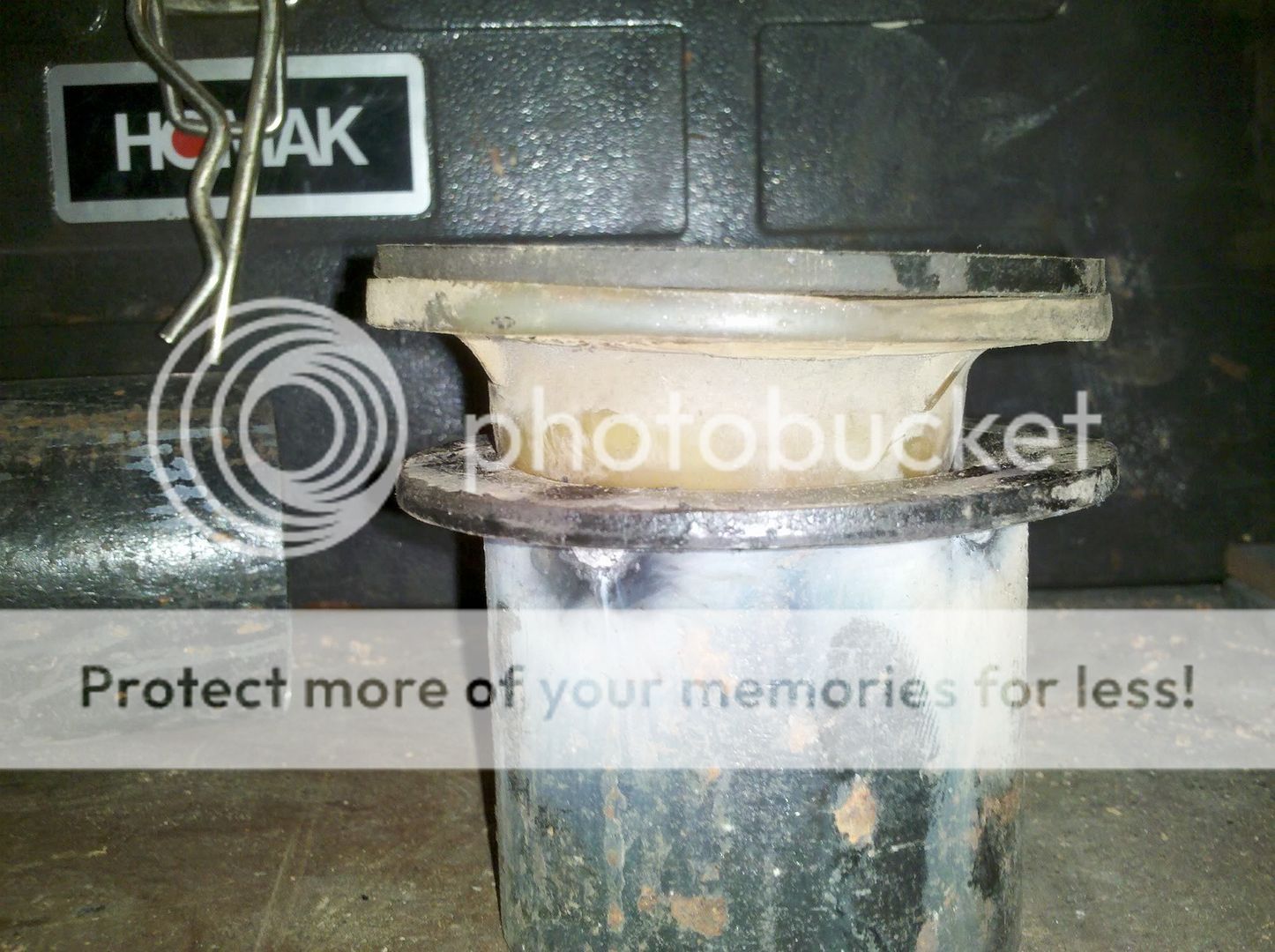

Also forgot about my coil spacers i made out of some scrap DOM and a set of spare coil seats that i welded that net 2"

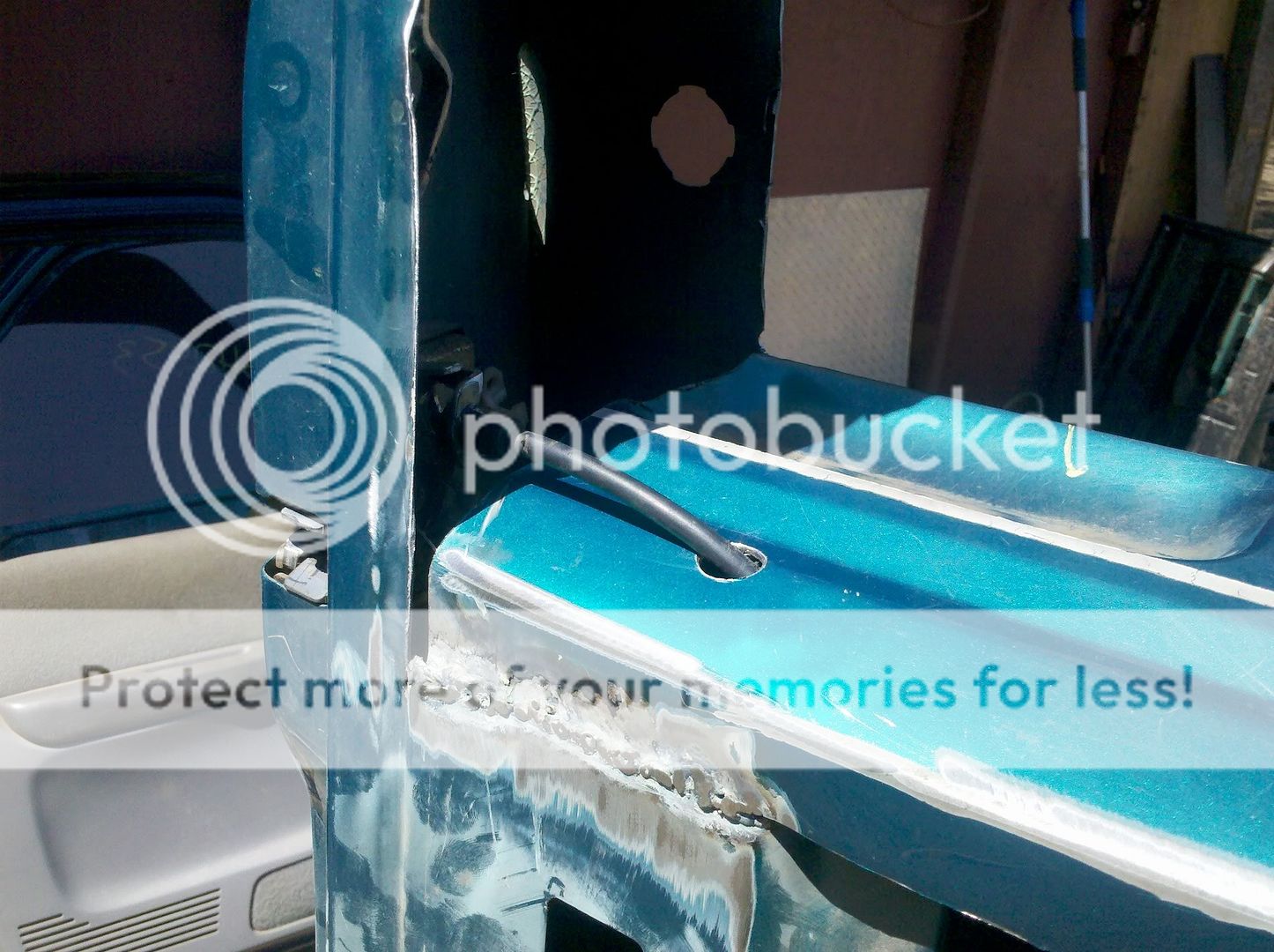

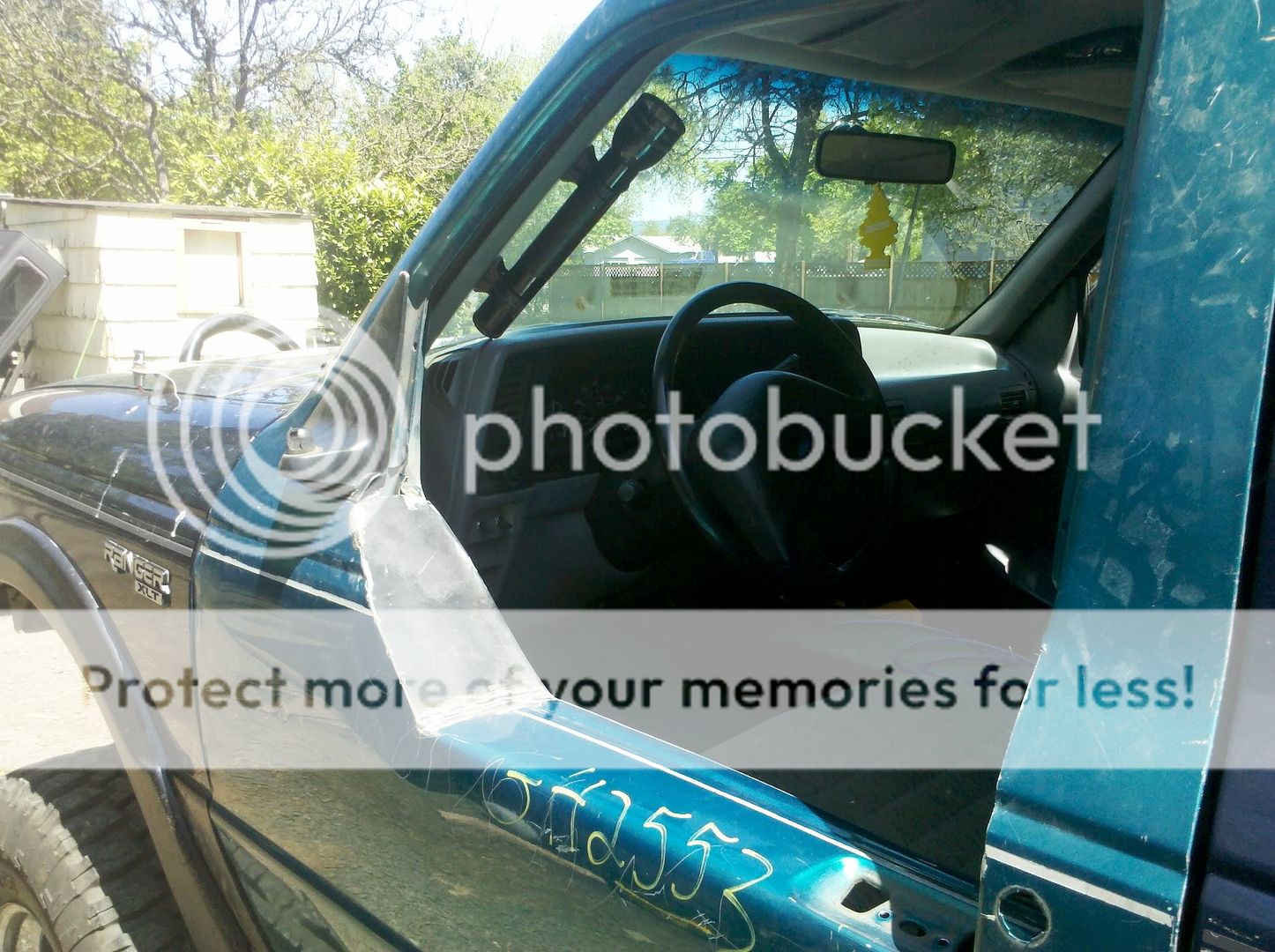

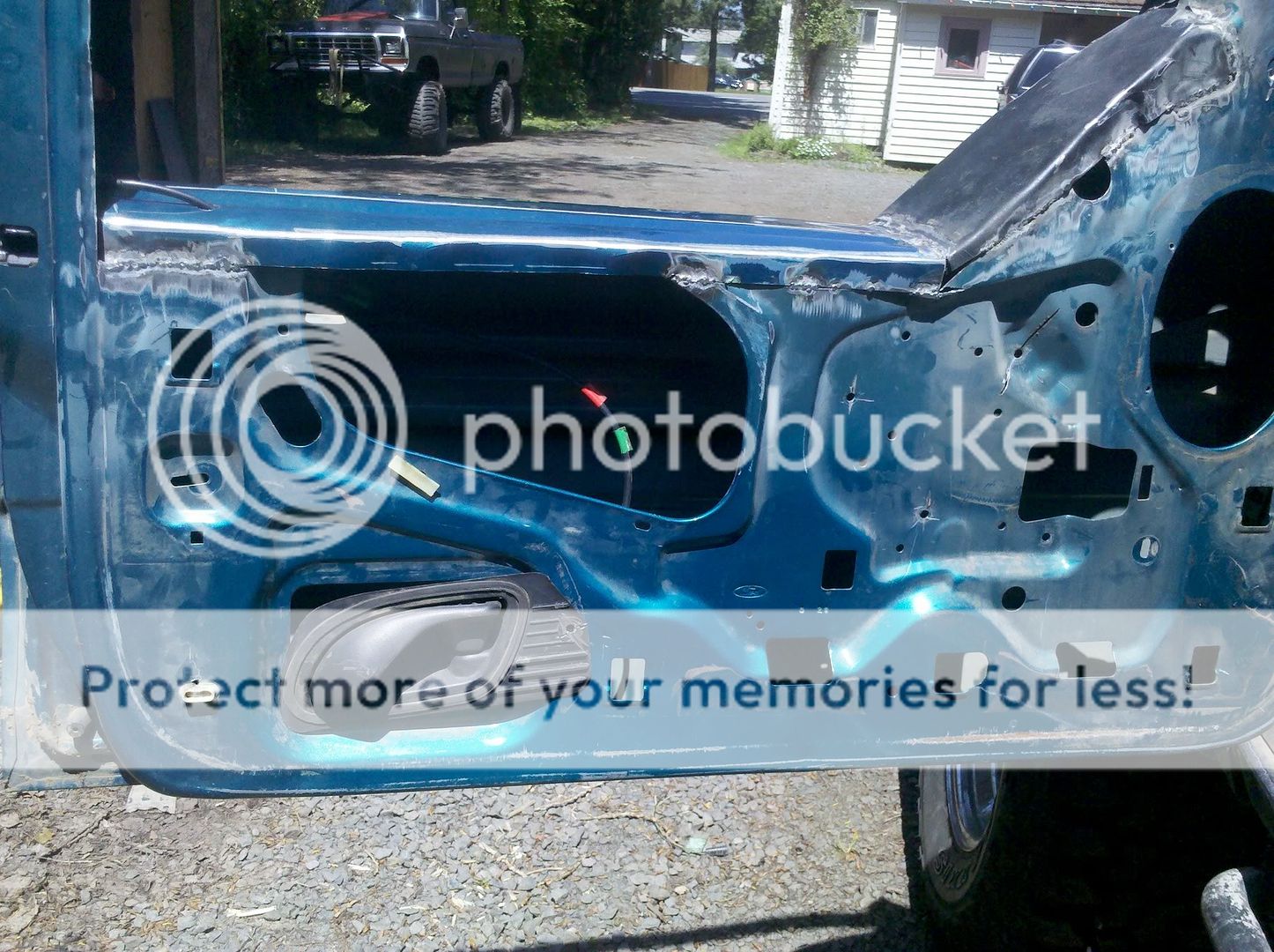

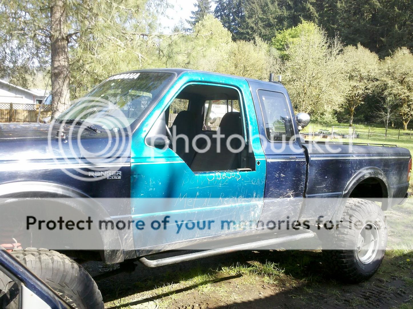

nice! are you gonna rig up the door handle so it works in that spot
I was but i couldnt get the rod to function correctly. So i did the next best thing, i reused the cable operated interior handle and put it where the door vent was. It works great and from either inside or outside it is comfy to use.

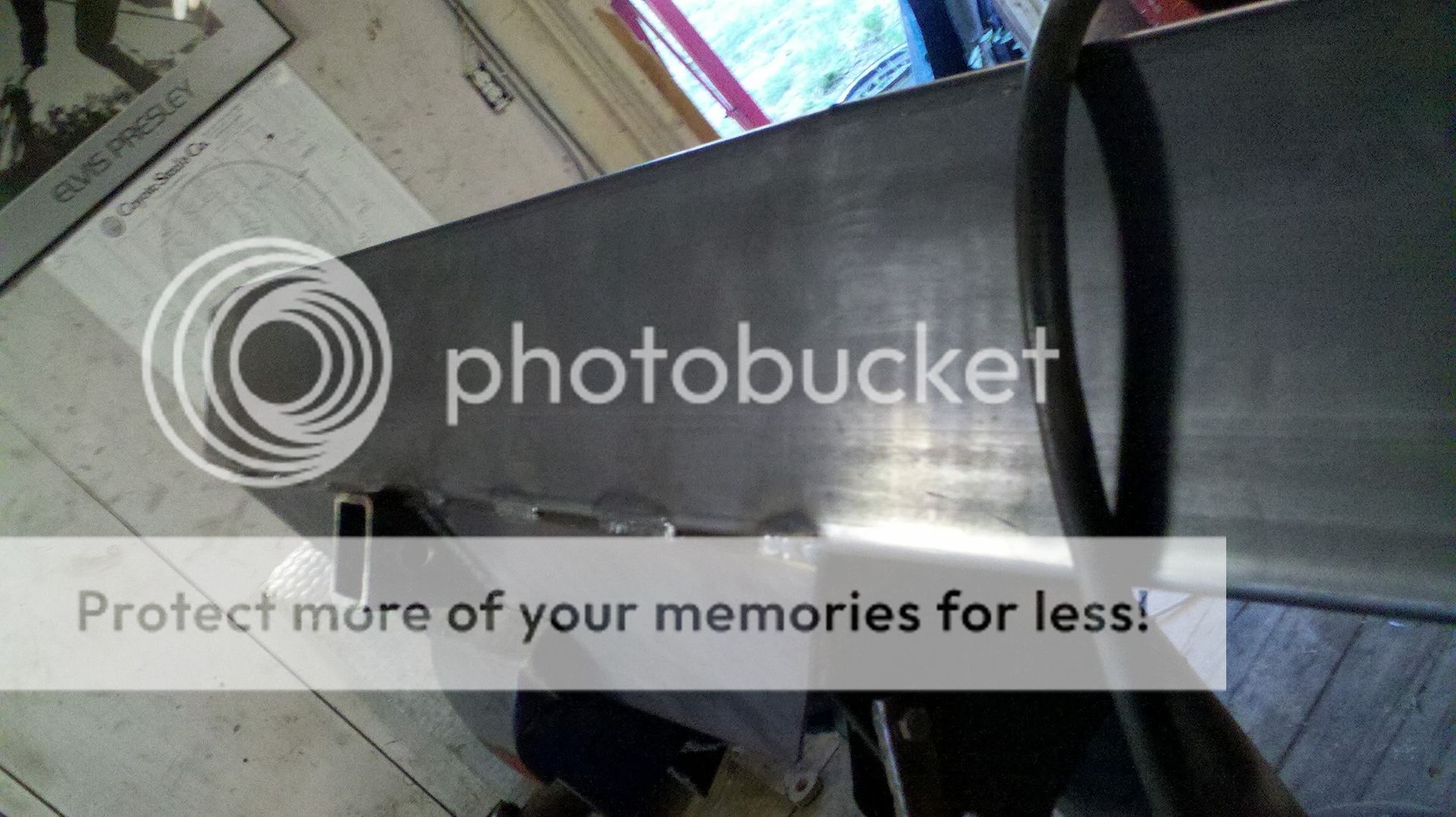

I think im gonna do the other side now so i can do the body work to them together not one at a time. Gonna use some paint match and on the top im gonna bedline them for use as a step if needed
Then i think im just gonna use some 16 guage to make a door panel to make it look a lil better
In my opinion if anyone was to do this like this, cut and fold right above the door handle to retain it and hide the interior cable like shown on mine

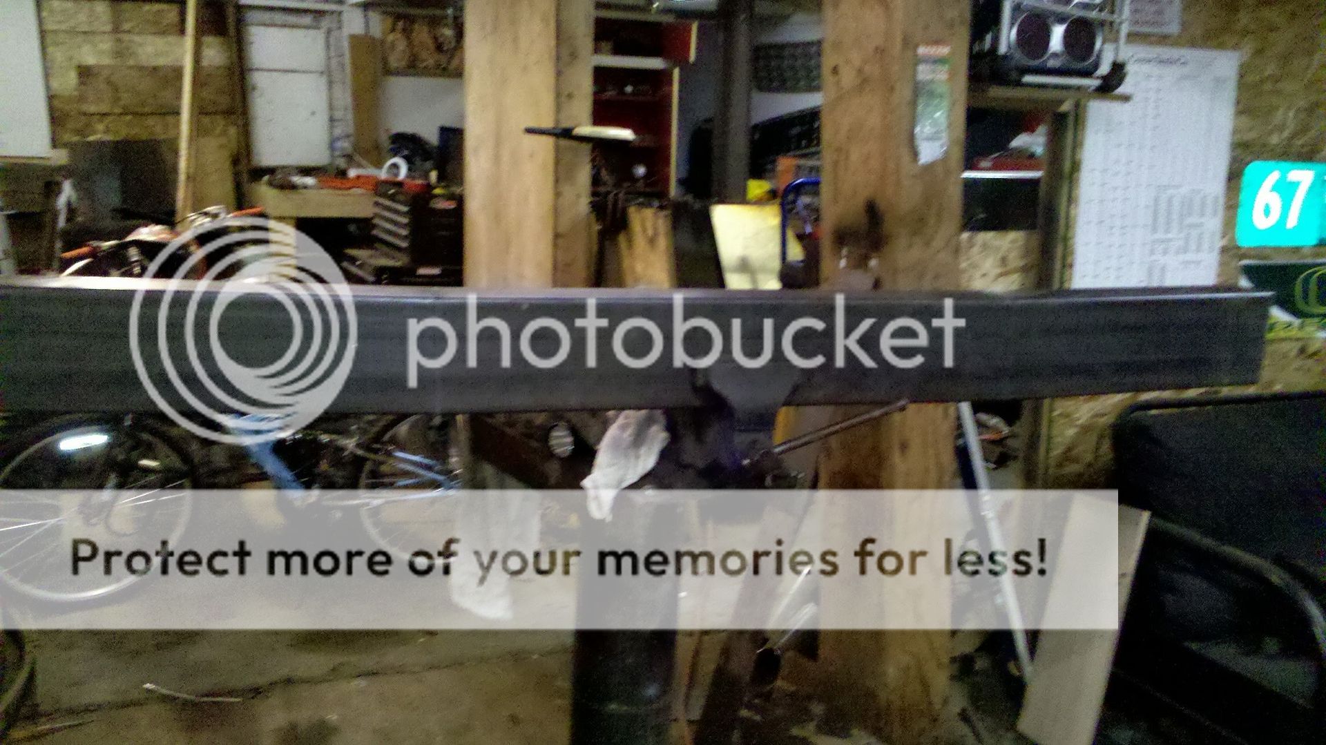

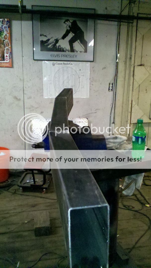

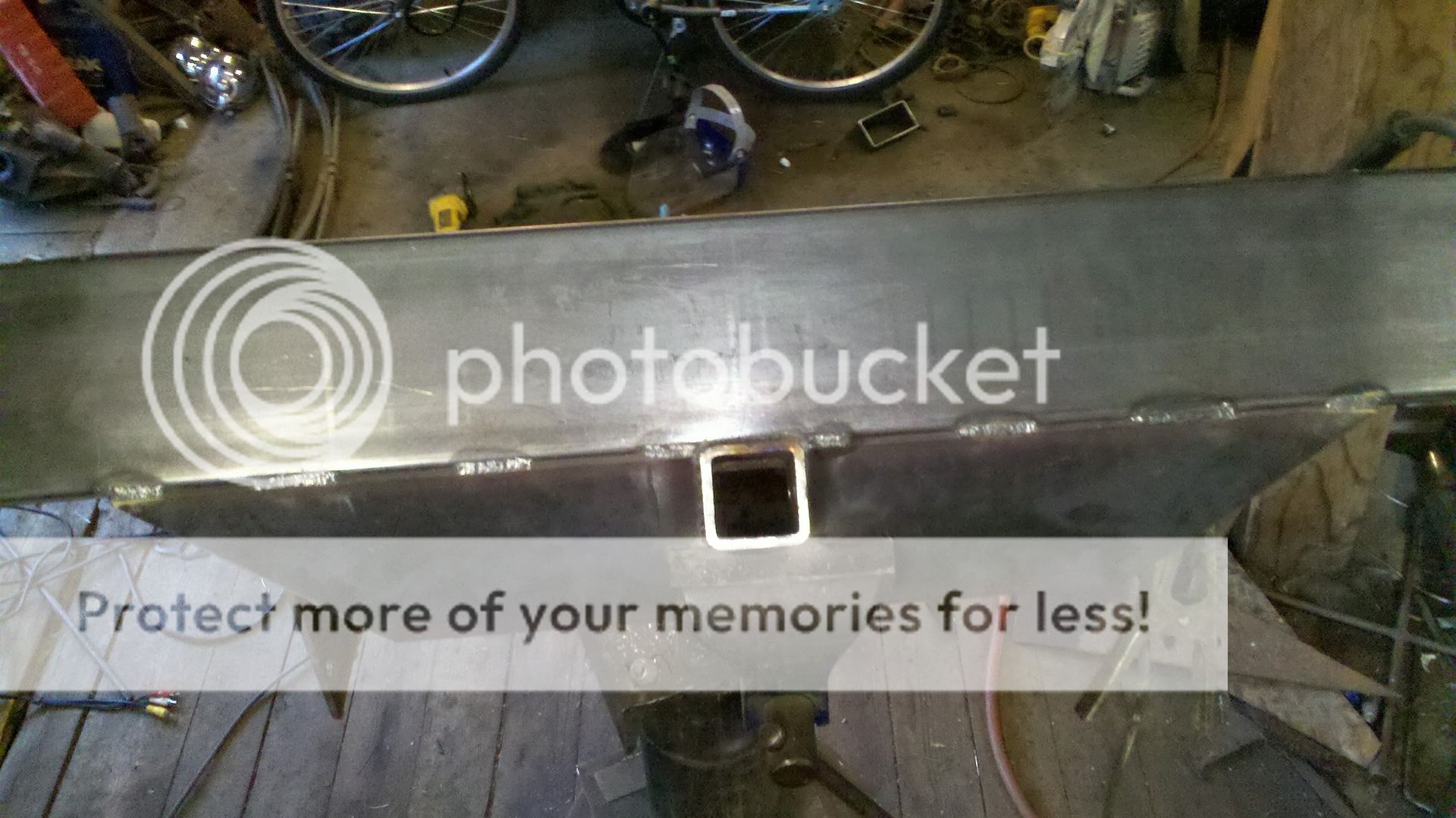

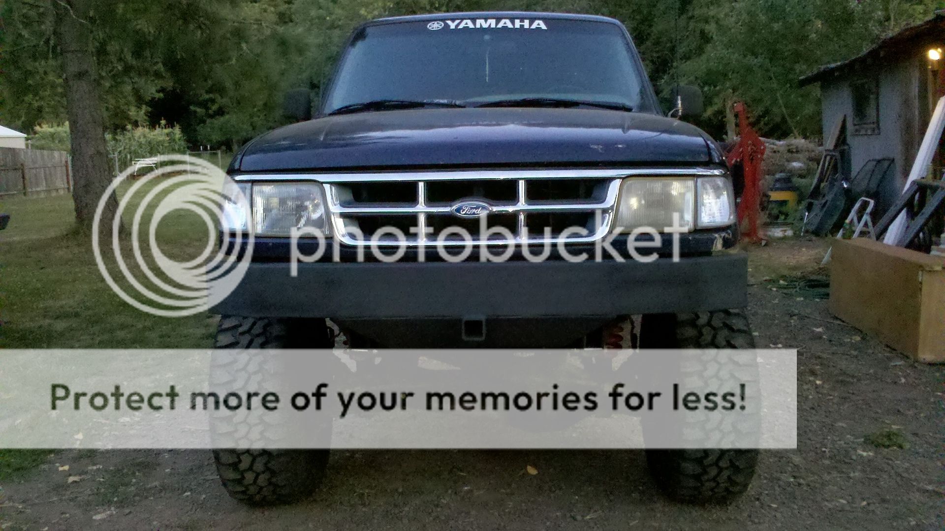

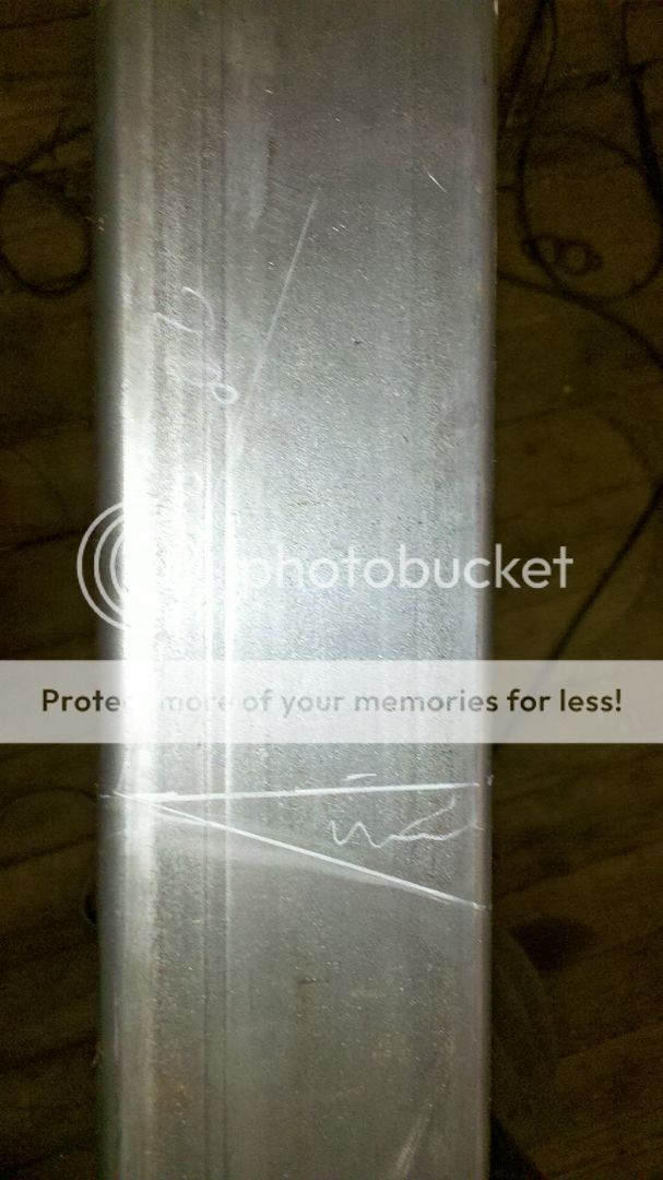

Meh not too much of an update just got some 3" 63's in the rear with no block and beltechs, got her level now. And started fabbing my new front bumper, still have alot to do to it like tieing in the side profile to match fender opening. Sure is a pin to get a good mounting point with a 3" BL.

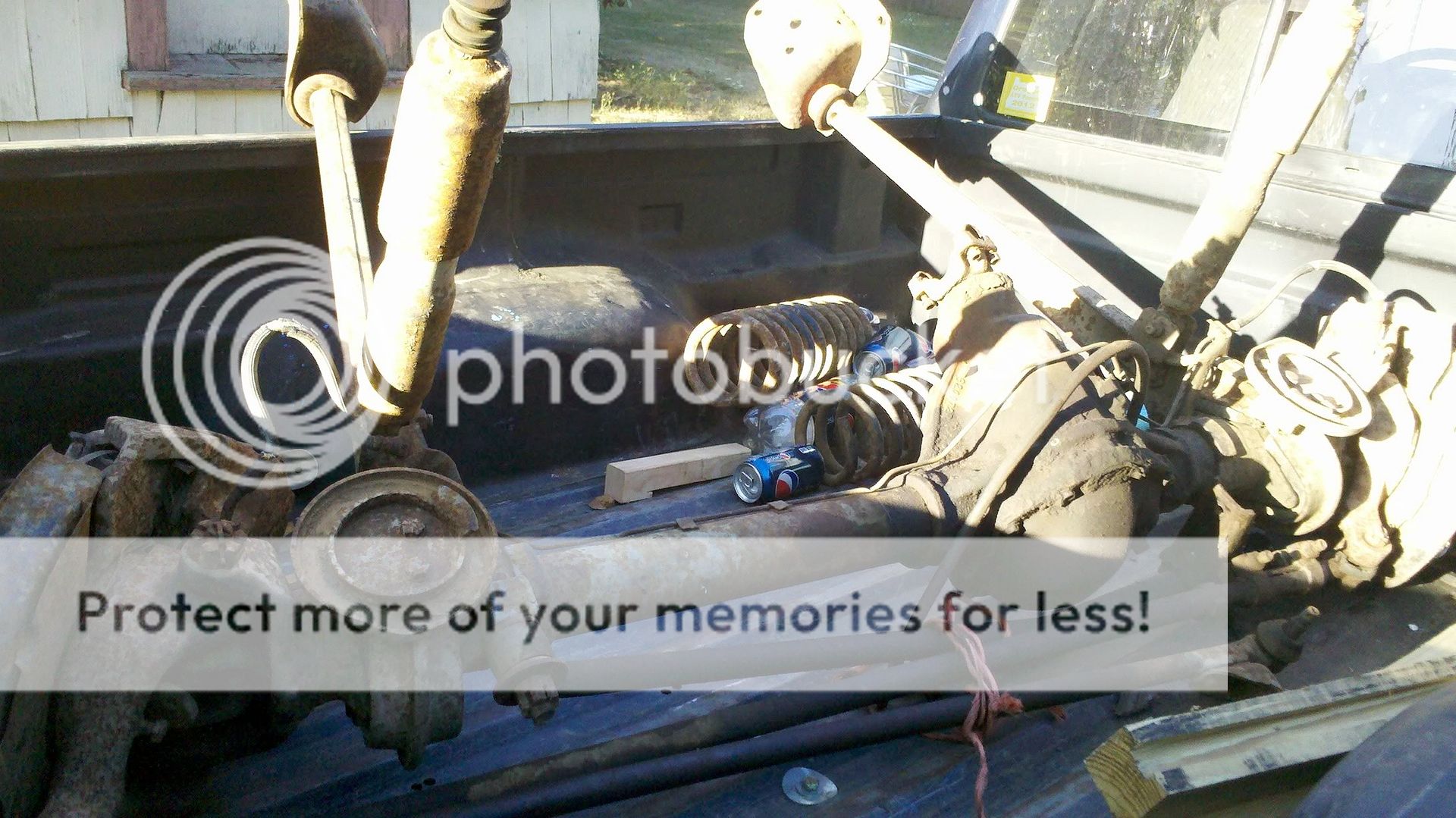

Man that faq. has good info on narrowing a 44, but it just doesnt tap off with a hammer lol

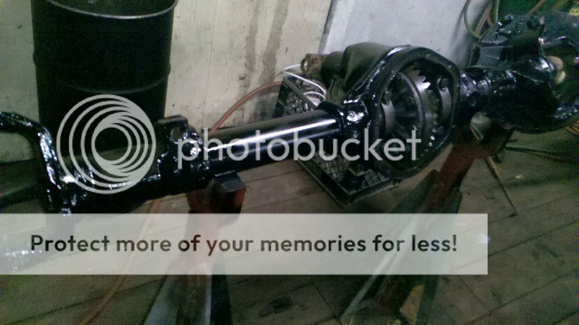

Well a lil progress so far.
Got her narrowed and it took alot of cleaning but she looks decent now.
Grabbed a set of 4 wheels off C list for 60 bucks just so i can get this thing closer to go. And if i wouldnt of narrowed the axle i coulda used these wheels and still be at the same width.They are 15X7 3.5" BS
So im debating of upgrading my 8.8 to 4.88 and some sort of locker or just throwing a 9" in there and use these wheels to stay the same width i am now. I just need to research my 8.8 a lil more to see if i need a new carrier seein as i have a L/S 3.73 28 spline.
Here shes all cleaned up almost all assembled

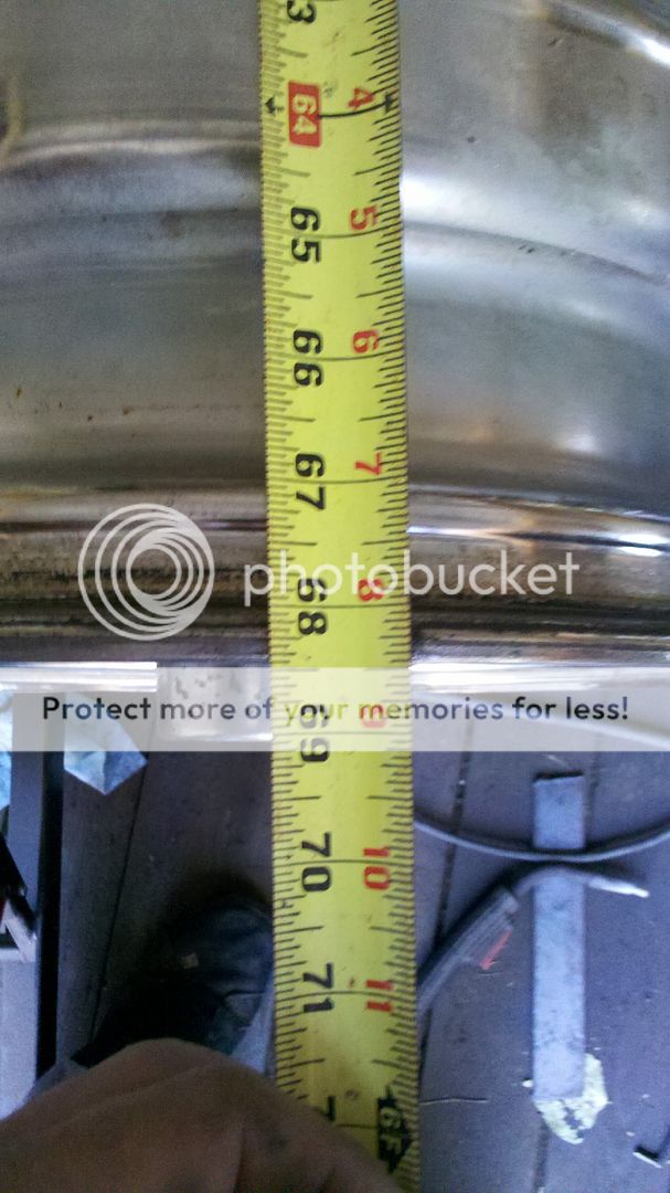

Heres when i bolted the 15x7 wheels on the EB width axle
68.5" to outside of wheel to outside of wheel
My Dana 35 right now with 15x10 3" BS sits at 73.5" outside of rim to outside of rim.
If i would have left her full width, id be only an inch wider than now.
