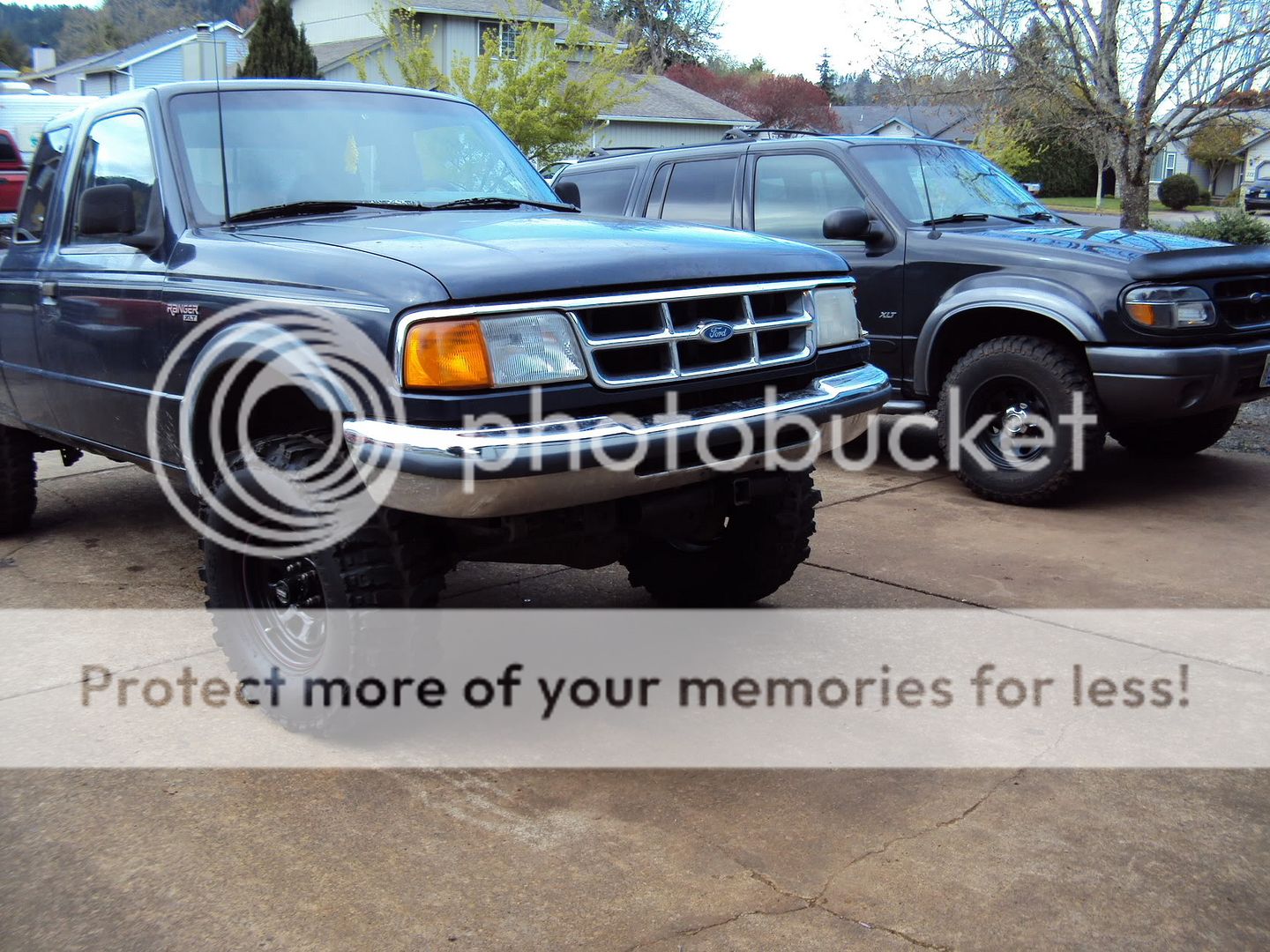

So here it goes old man had this in his back 40. Been sitting since '06 he was orig. owner so when i got it, it had 119,000 miles not bad. has a dent in driverside rear cab and bed but its fixable. So i towed her home and popped the hood found a 4.0 auto 1354 with new 4yrs ago plugs wire oil filter everything. Seems he thought a headgasket went out. Had to remove carpet due to mold and grass. Then me and my dad Powerwashed her, paint seems good need to polish it out tho. ran her found out water leak was bad freeze plug replaced it and 300miles later shes still runnin strong. Installed a 3" BL and made new bumper brackets and sectioned the rear hitch 3"s to raise it up. Also put my stock premo explorer 16" wheels with 32s on it and ditched the 29s. So all im into doing now is installing new coils in front to remove sag and add some lift and gonna try to find some 33 - 35s to put on the old 15's. Oh last i built my own front receiver so i can snag my winch off my 78 f350 if i need it. Grand total in this rig is 500 bucks 300 for ranger 200 for registration tags plates and etc.

So far loved my lil steal of a deal ranger but as we all find out 4.0 auto starters are expensive like 140!! Thankfully a local parts store thinks i work at an ol company so got one for 64 thank god. So far she is on a 3" bl 1" coil spacer and runnin my buddys 33 bogs to see how i like the size. They drive great rub a hair at full turn full stuff, have the power to light both on dry pave and cruise 80 down the hwy. Lookin like im gonna find me some 33 tsls or some 285 75's m/t. Before i got new starter i did a lil lookin and found out that a couple of magnets where broken not sure how so it stranded me ass ended in a puddle sunday night lol anyways enjoy. Looks like the misses wants her exploder to sit higher than mine now lol

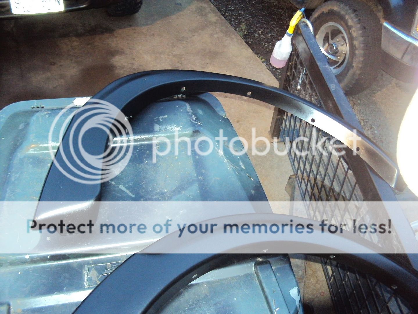

Well even tho it dont have a power plant im gonna keep on fixin her up. Removed carpet due to alot of mold moss and crap and decided to clean the floor and bed line the floorpan. I am goin to put carpet back in seein as the flowmaster is a lil loud but not as bad as my big truck. Removed the seats and stripped the covers off to get drycleaned and im stuck between leavin em alone or removing the lil seat attached to the drivers seat. Either way i am gonna keep the center consol. Removed the fender flares cause the rears where a lil beatup cleaned and painted black, thinkin of gettin some screws with black caps to give a fake bushwacker look. Installing switches for driving light and reverse lights nice there is a factory harness in there i just got to tap into. Anyways this is my lil update seein as i am not workin due to physical therapy on my arm im gonna try and get alot done

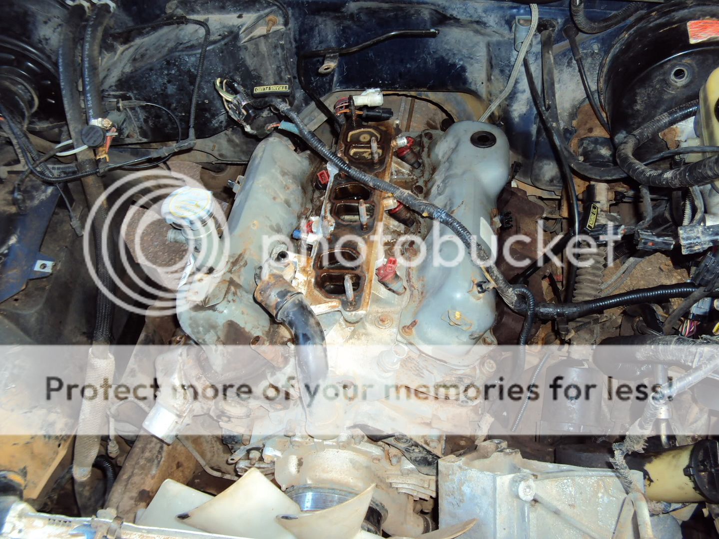

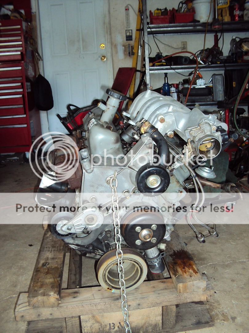

Appears the only diff between egr is the drivers side exhaust manifold and the intake plenum? Is that correct? I took mine off and it fit perfectly on new motor so i believe it was really that easy.
So if thats it i will have old motor out tomorrow and new one in by weekend. Heres a couple pics, I hat when threads are all typing lol
New engine with my non egr plenum
Old motor u may be able to make out the water in the rear 2 intake holes. That was alot of water in this engine

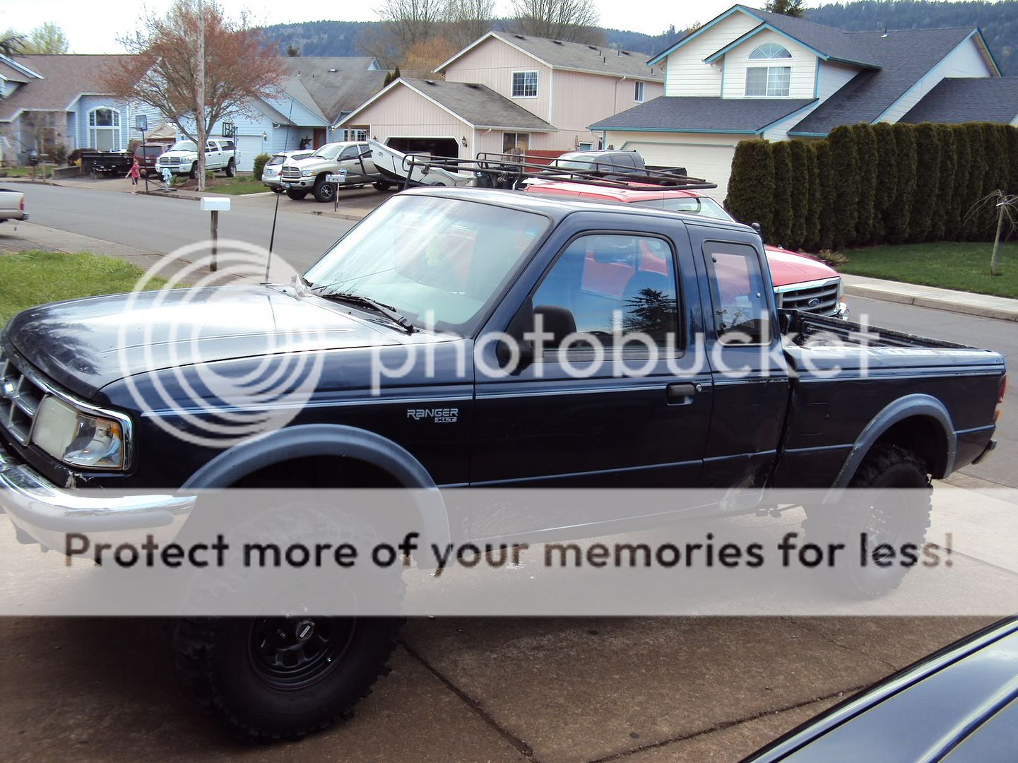

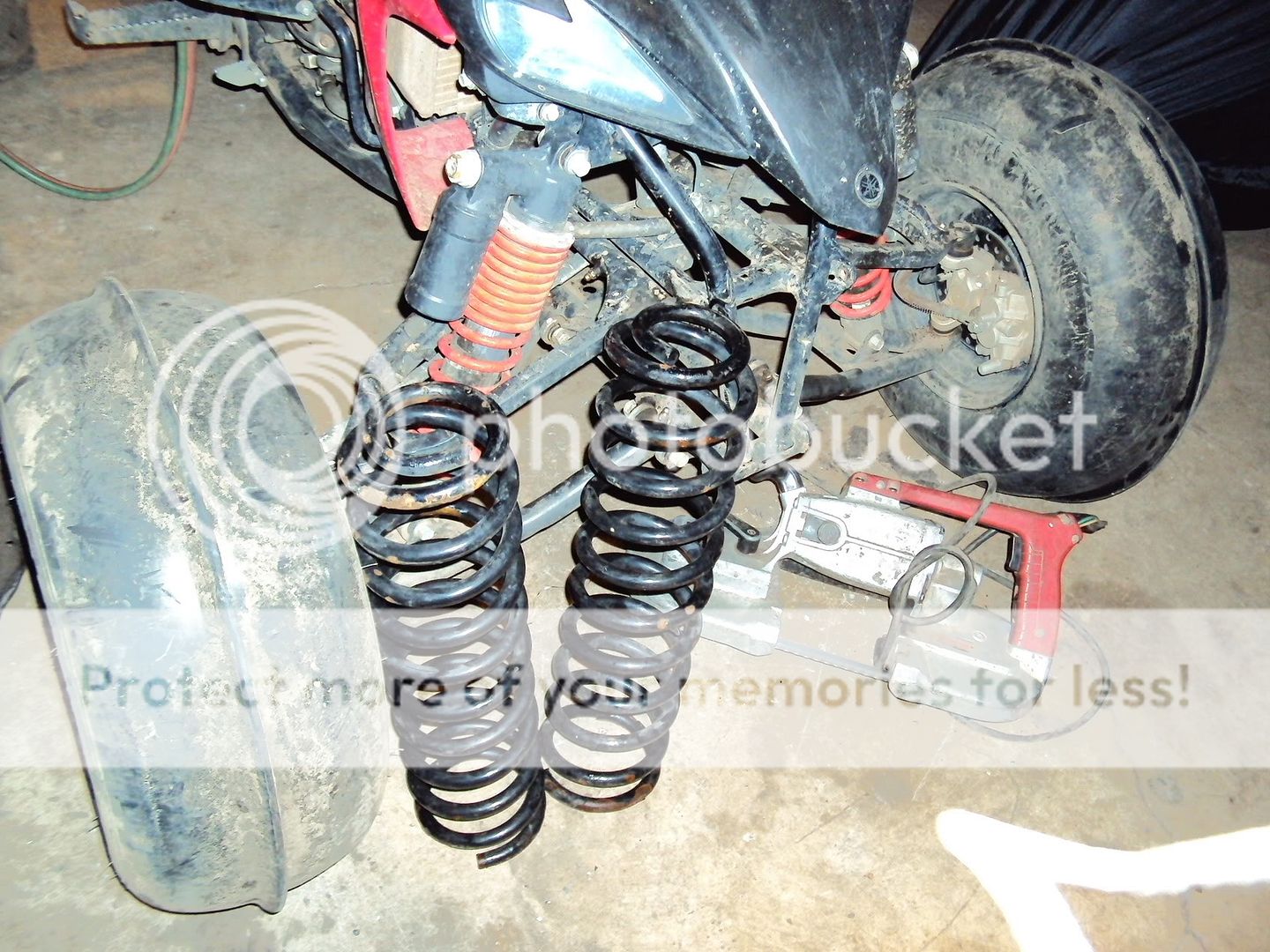

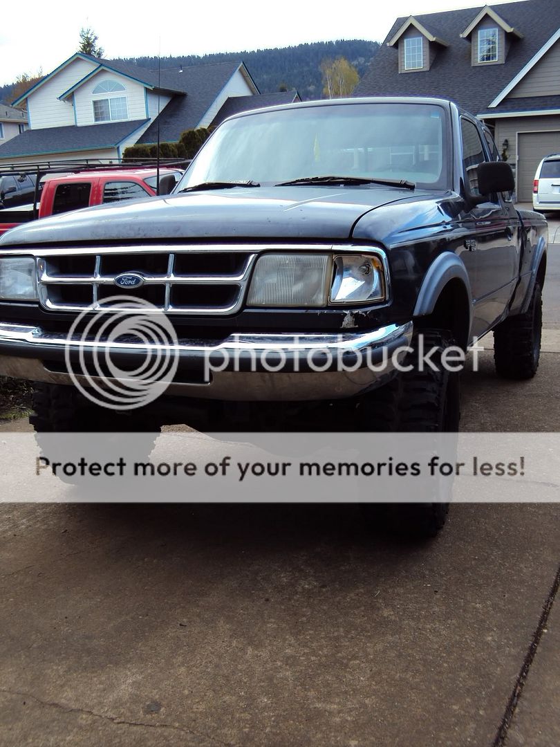

Been a while since I've updated. Finally made some sliders and a headache rack with bed rail tie downs seein as I use this for my dd work rig. Did the F150 coils with 3 degree bushings sits nicely. Also swapped my body lift out for a beefyer one that's 3 5/8" tall. Just need to made 2 inch taller rear shackles to level her off. Well here's a pic till I get home and get on the computer. Sporting 33 12.5s
