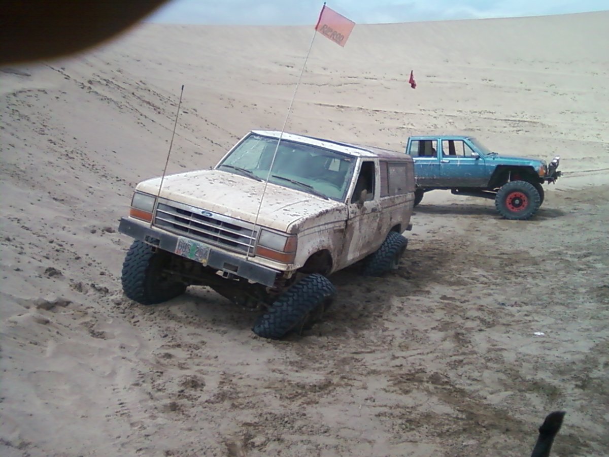

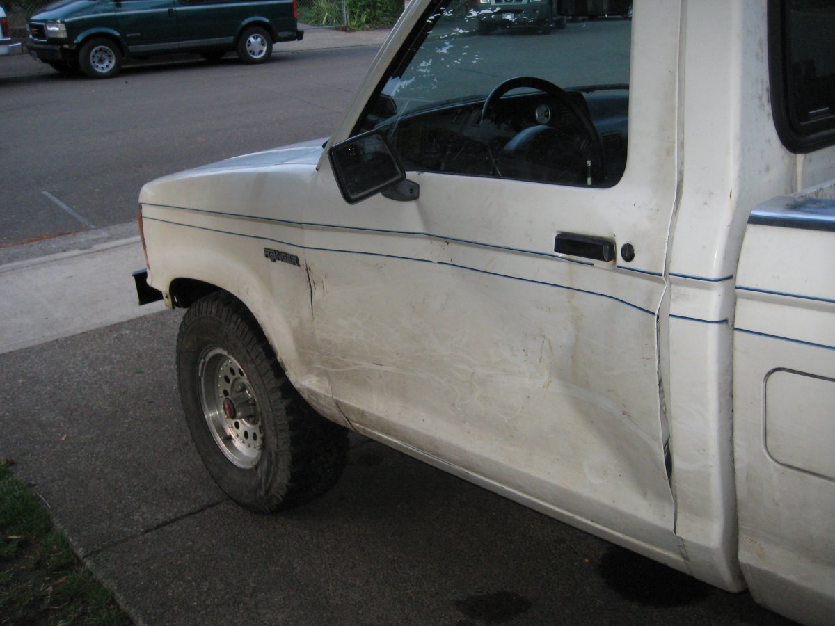

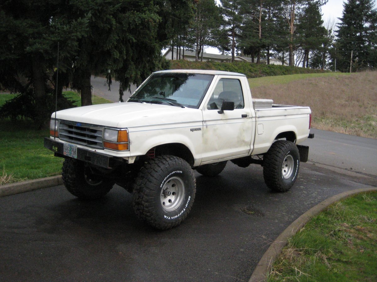

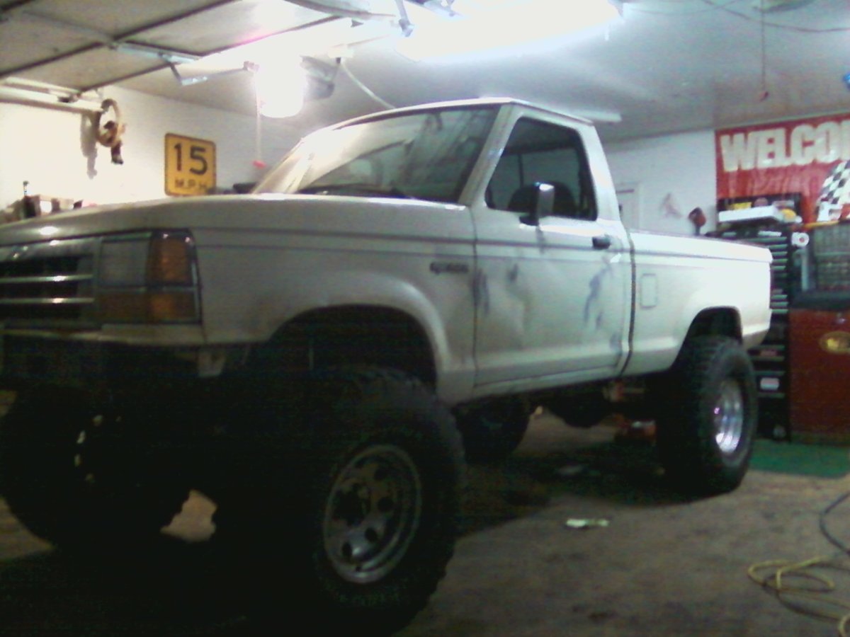

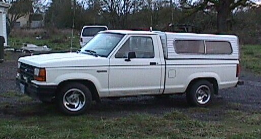

Got the thing in November of '99 when I was 17, was a stock grandpa mobile with a WOOD framed canopy that weighed like 200 pounds, it was all me and my brother could do in our teens (we both played football) to lift the dang thing... anyway, stock 5 speed 2.3L zero options with the much sought after 3.08:1 gear ratio out back... I have a pic somewhere but can't find it... a couple years later I was into the old FordRanger.com forums and happened upon a 3.73:1 rear axle for $15 so that was the first mod, then I put new leaf springs on it. Then a few years later I found a 4x4 4 cylinder chassis that had been rolled on craigslist for $350 so I did a body and engine swap, that was in '05 and I was still very green mechanically at that point but I managed...

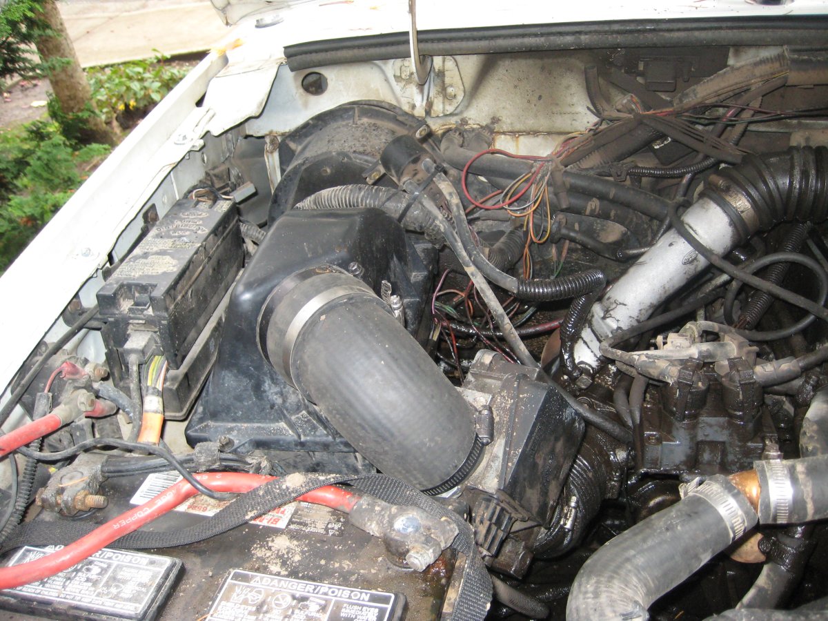

Then in late '09 I had gathered parts to do a turbo swap, I was cocky and thought I could do it over the Thanksgiving break, well it got finished on new years :). Again, still green and learning but made things happen.

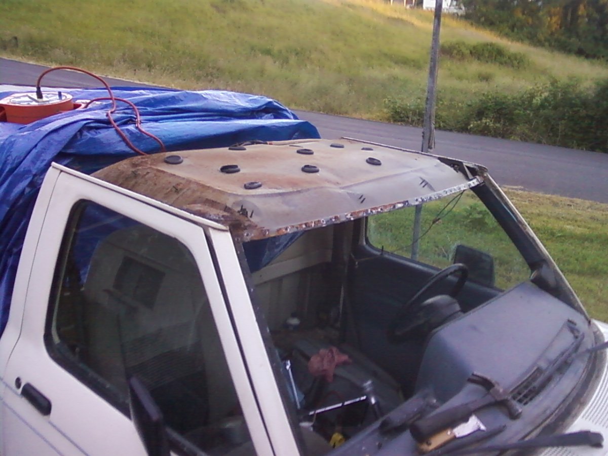

In '11 I had gathered some used lift parts and a D35 and explorer 8.8 and 5.13 gears and some used 35" tires and a friend offered his garage to do the work, over 2 weekends and some weeknights we got that accomplished, then on our wheeling trip I managed to roll it because the engine stalled at the worst time possible because I failed to ground the ignition module... about July I did the body work and got it to hold a windshield again and everything, pulled the roof skin and everything.
Oh, when we did the lift we rebuilt the transmission and put in a Centerforce clutch, we did all the things...

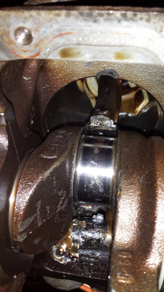

Ran like that for a while, eventually a rod nut had came loose at 5000rpm and broke an engine so I threw another together with spare parts I had around, that engine is still going, had some oil leaks from dumb things but that's mostly sorted...

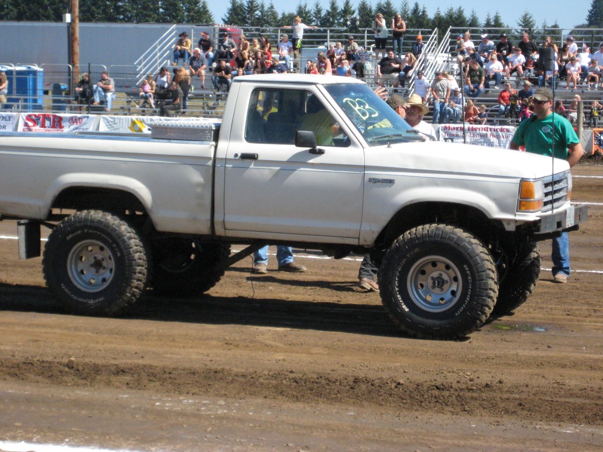

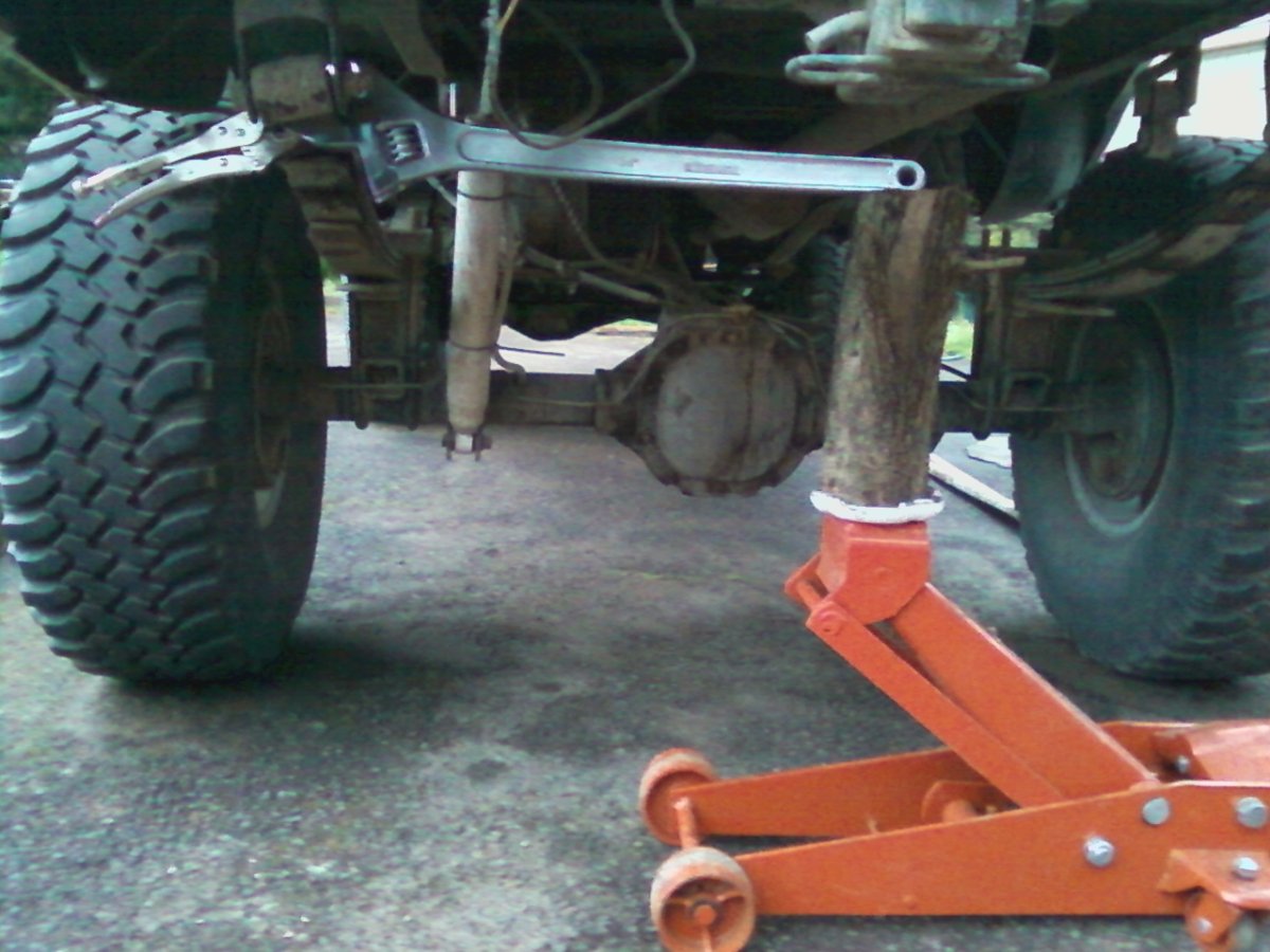

I've done some tractor pulls with the thing, went fine on 31" tires but when I did it with 35" tires there was too much axle wrap and I managed to twist and bend the rear driveline, twist an axle tube, bend a leaf spring, break the rear bearing retainer notch in the transfer case and pierced the radiator with the fan... so that ended the tractor pulls for a while, eventually 4 years ago I made up a traction bar but haven't had the nerve to try it again...

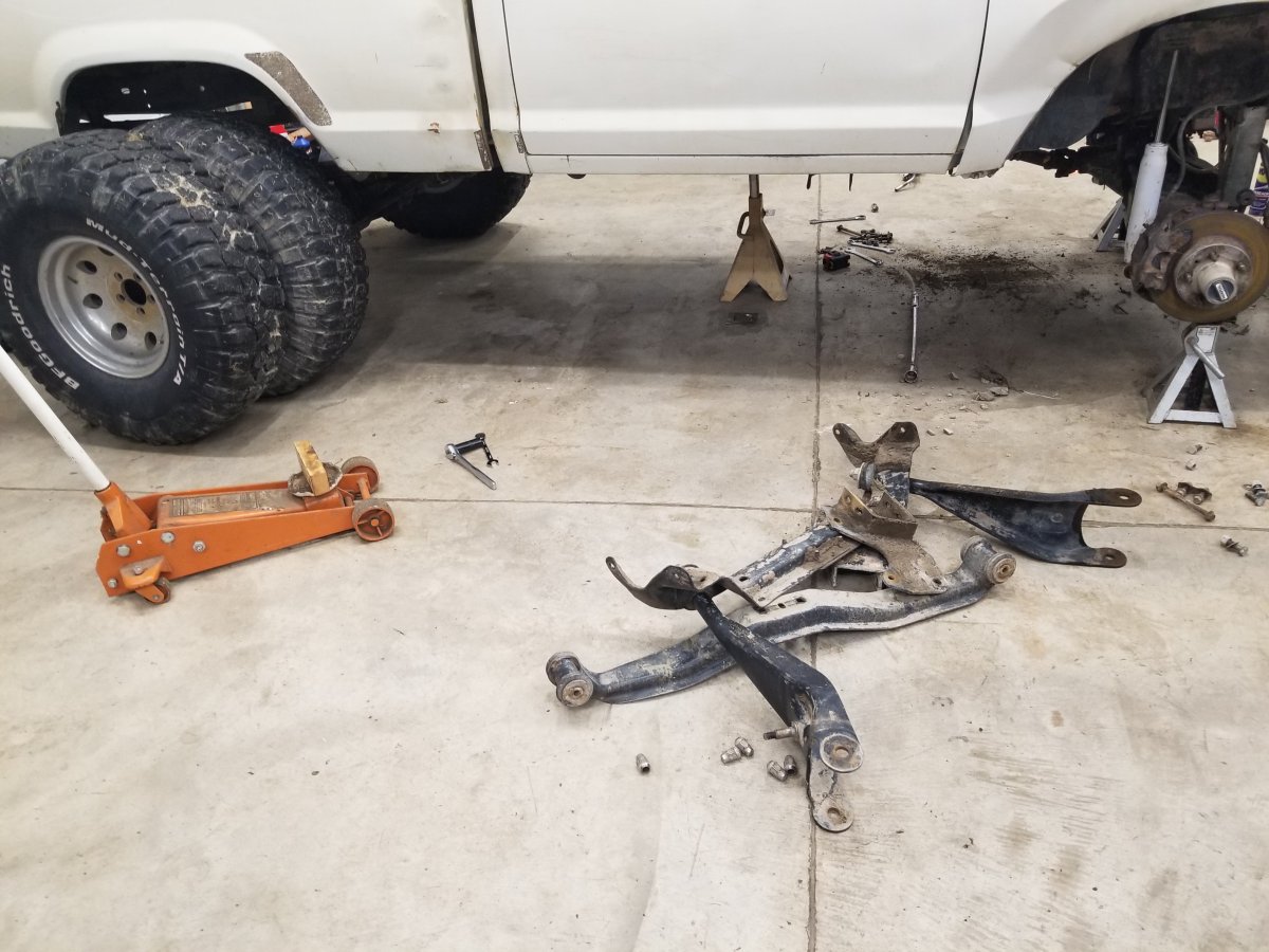

Now it's under the knife again as I'm finally making extended radius arms and making a new transmission crossmember...
Since I didn't structure the text well to include pics I'll put them below in chronological order...

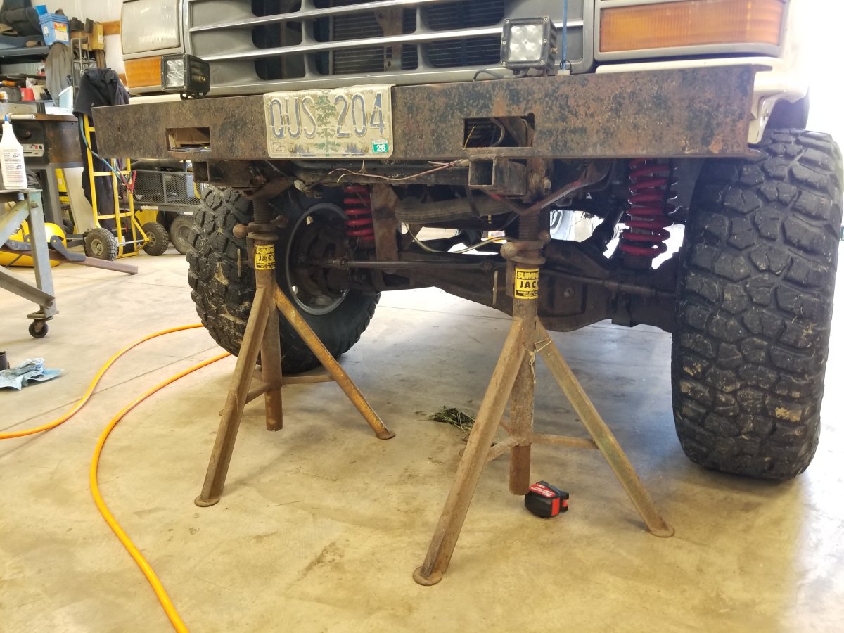

A couple more details, obviously by the traction bar pic it has disc brakes in the back, and the pic above that at the beach there's a dangler, that's the parking brake cable, I think it was still drum at that point as I never had a parking brake with the 8.8 and drum brakes for like 5 years... swapped to disc and finally hooked that up even though it's useless...

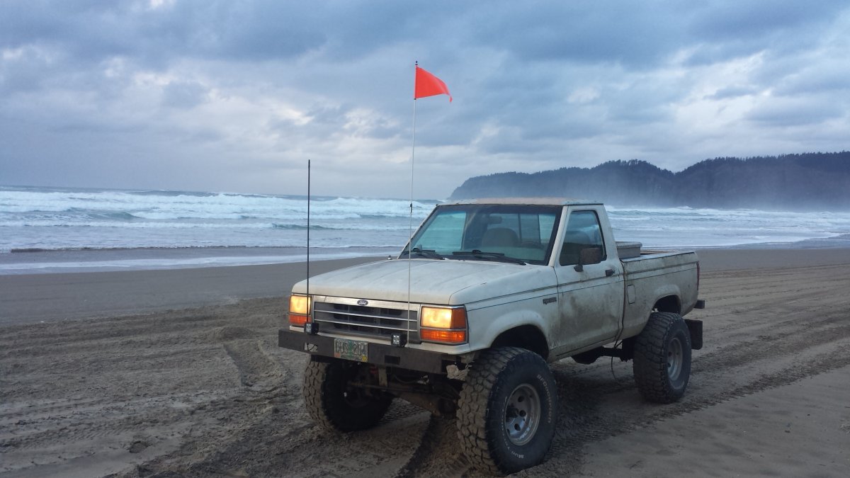

Here's the picture I have from back in the olden days...

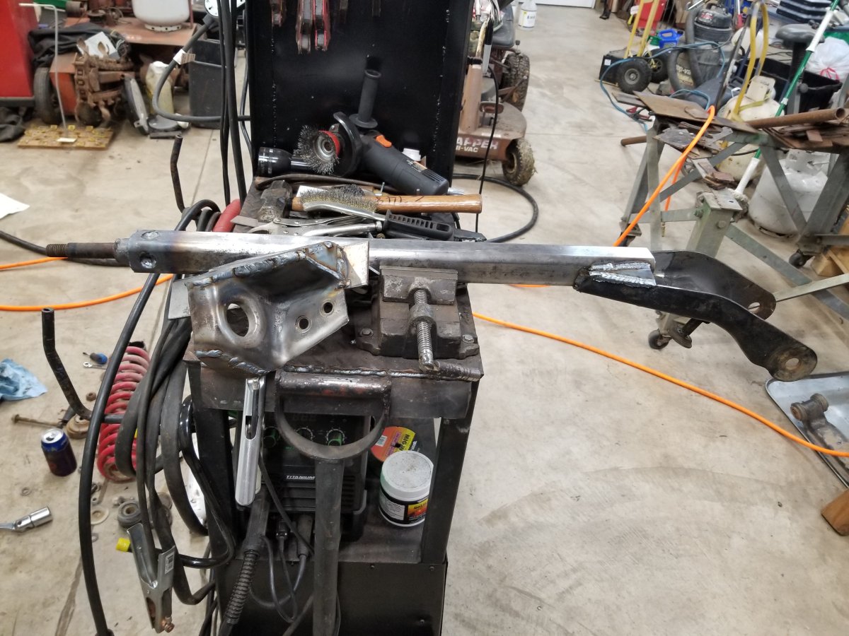

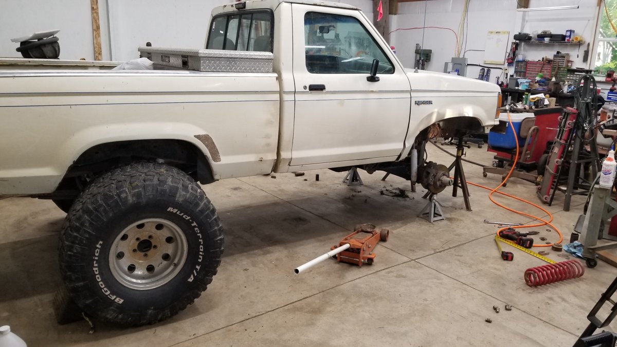

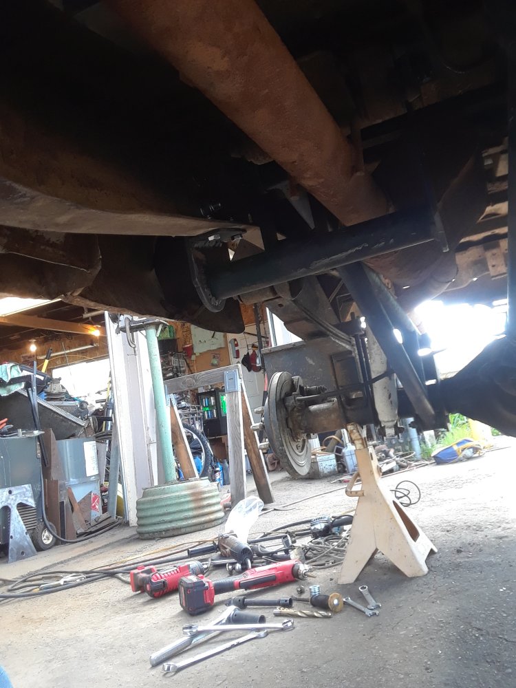

This is the current project and about where it sits since the end of last month working on making new radius arms and transmission crossmember. The weather turned and I switched to trying to tame the lawn some but over the next week I might make some progress hopefully at least next weekend...

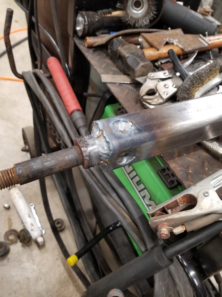

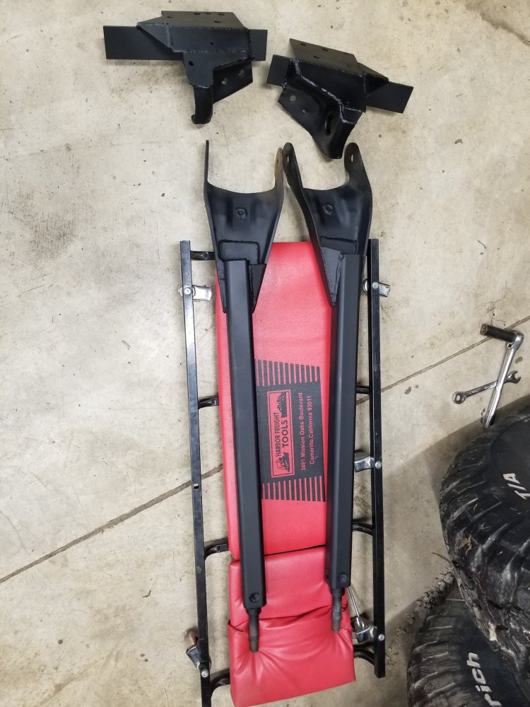

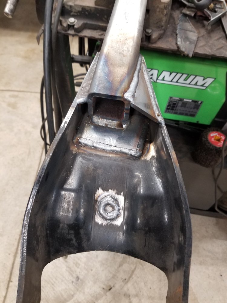

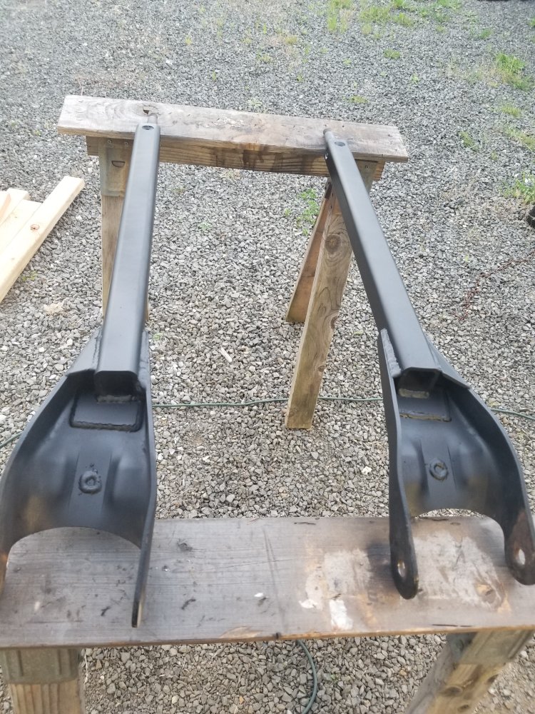

So far I've finally got the radius arm brackets and radius arms done and painted, I've added a random amount of length to them, the abstract brackets were kinda a pain to figure out but it's working out! I tried to weld the crap out of everything. Next is to get those parts mounted up tomorrow then get to working on the transmission crossmember, then get to work on the steering as the drivers link interferes with the pivot at the pitman arm so I need to take some of the bend out of the passenger side linkage which should be fun... I moved the front axle forward about an inch to help the fender and firewall interference issue...

NICE! Wanna build another set? LOL Those look longer than usual. Pretty sure it's just the camera angle.
The welds look nice.
Did you block the ends of the square tubes? They would probably get packed with mud and crap otherwise... And rust from the inside out.
They are longer than normal, I wanted to get rid of the stock dumb transmission crossmember so I went back there...
I didn't plug off the front of the tubes at least for now, I don't do a whole lot of mud, mostly sand and snow, should be possible to pressure wash up the front and they're angled down decently.
