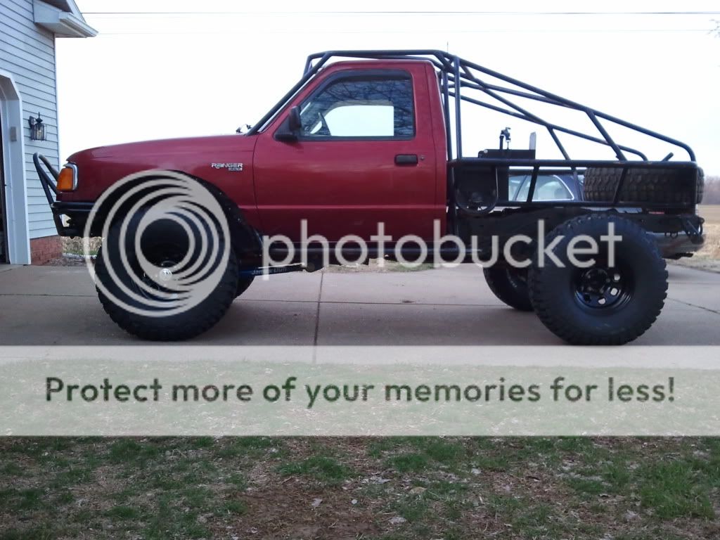

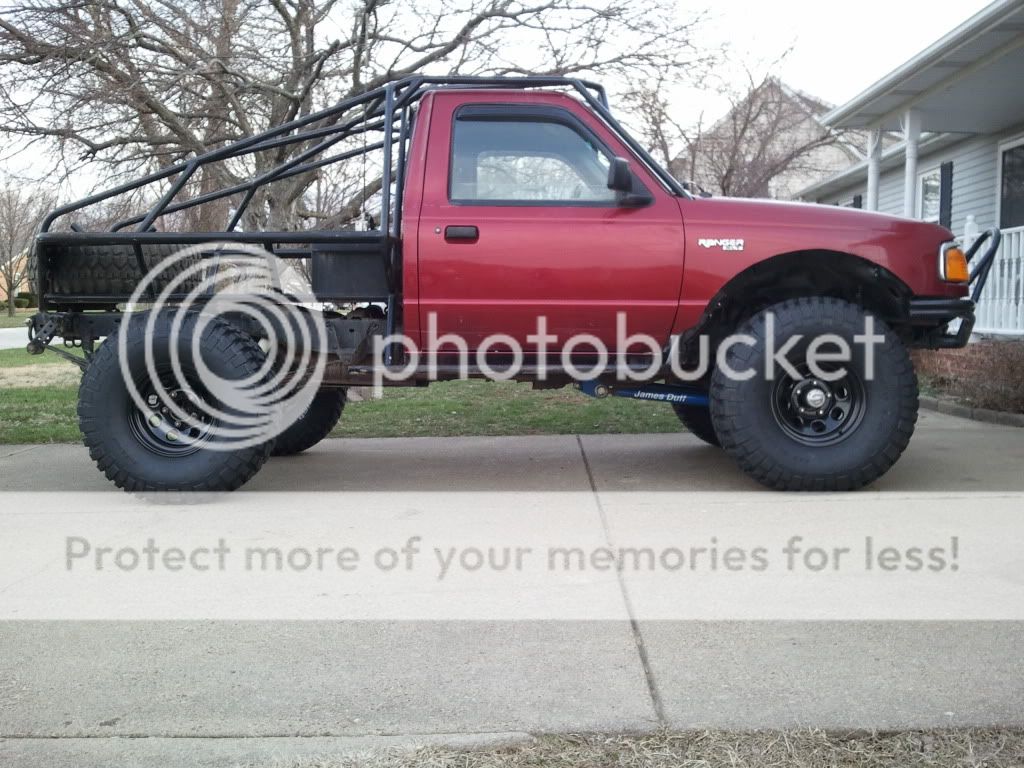

My 44 Knuckle Swap 35/44 Hybrid

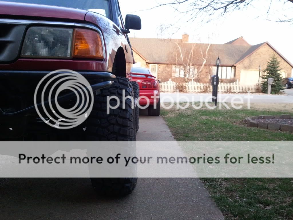

Here is what 3 degrees off looks like .

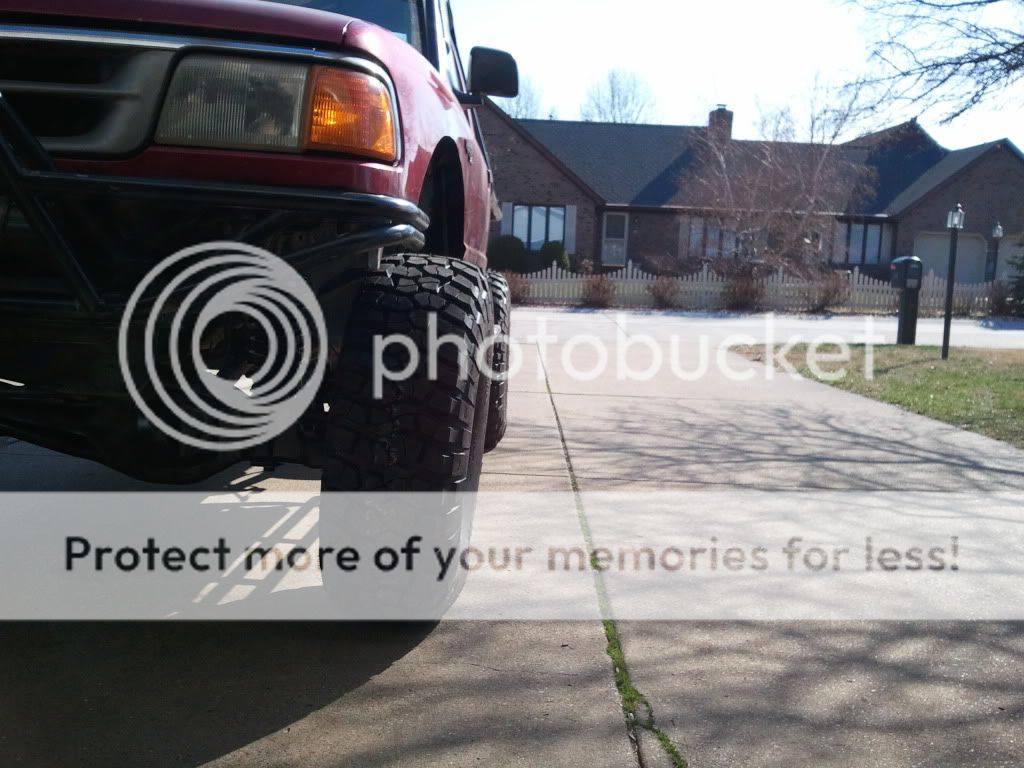

I like it. Thought it would stick out more with those spacers. Whats the offset on the rims?
The weight of a v-8 should fix that problem!!!!! Jking. Looks great, how does she drive so far?
You get that other beam moved?

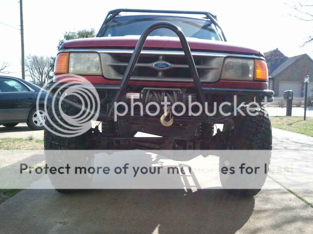

Well I put in some 2.75 degree bushing but that leaned the tires in 3 degrees . So I put the 0's back in and Dustin and I lowered the beam pivot bolts to the lower hole . Now the left tire is in 1.5 and the right is in a little under 3 . But right side is sitting .5" lower than the left and the front looks like it's 1-1.5 lower than the back . So I might lift and level the front a little . What do you think ?
Plus it is towed in about 1" right now .
If you add spacers under your coils, it will start to move the tires back out.
Or you could order some 3 degree bushings lol.

thanks again, we'll see if i cant ruin some bald tires lol. the truck looks damn good on all 4's

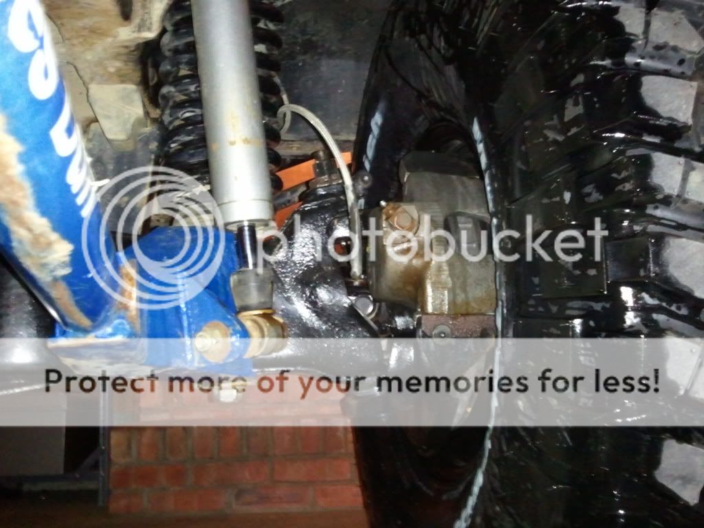

While making a sharp turn the brake line at the caliper hit the shock . Why don't these trucks have a split system ? I had to drive it home with no brakes not even the back .
Damn. Looks like what happened to me outside of Madisonville coming from TB. I had to remove the tee on mine so I only had the front drivers side working, but it got me home.
