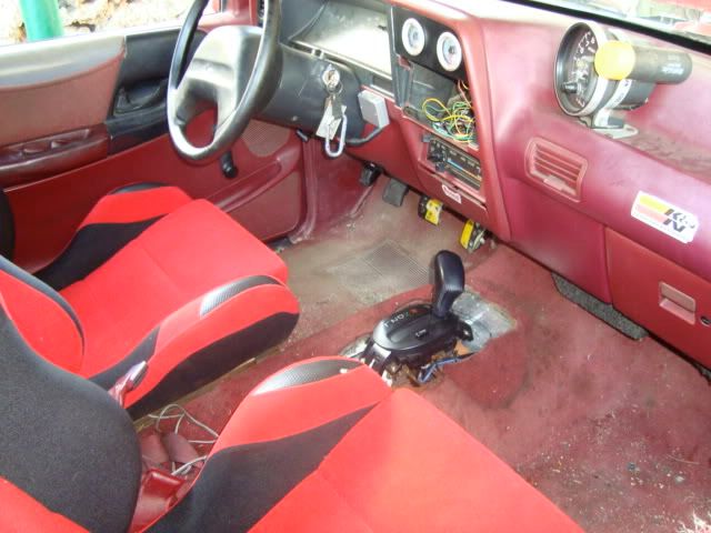

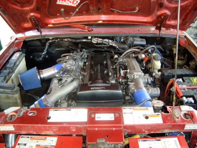

Guy's everything is done well altleast for now hehe, here are some pic's of the finish product.

As you can see the interior still need some TLC and the body also need a new paint job suspension also needs some new rubber bushings but it'll be done when the time is right.Will put some videos as soon as i can get hold of a camcorder.
I bet that thing hauls ass...it's a shame we won't know since there aren't any videos or dyno slips. *Hint hint hint*
Don't worry next week it'll be on the dyno to see what she's putting out,remember she's on stock boost.Some other mod's are 3'' exhaust, UD pulley's , bigger intercooler & piping, 255lph intank fuel pump with bigger fuel lines & adjustable fuel pressure regulator.They might have bump the power up a little so the dyno will let us know how much.
