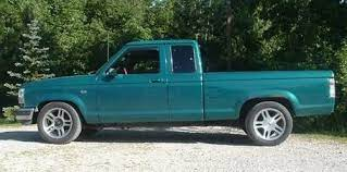

Most Rangers I see with Mustang Wheels, usually have the front center caps off because the wheel bearing dust covers poke out too far
61898
Like this 👇
61899
