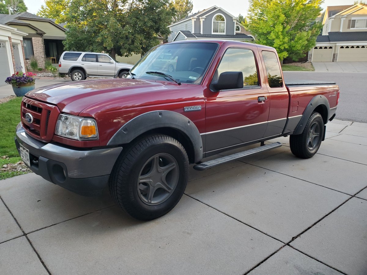

These Mustang wheels are the same specs, I have 1.25" hubcentric adapters on my 09. I had to trim a bit from the studs on the rear axle, the front studs were fine. Tire centerline location is correct for the 98+ body style. I would expect you to need the same thickness on the earlier years, since the stock offset was pretty much the same throughout the years.
