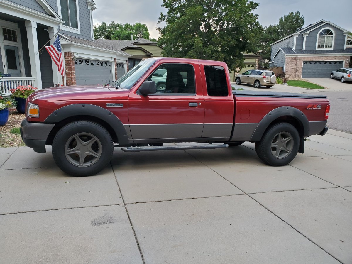

You will need a spacer/adapter of approximately 1" thickness to make those work. I have 1.25" adapters on mine.
